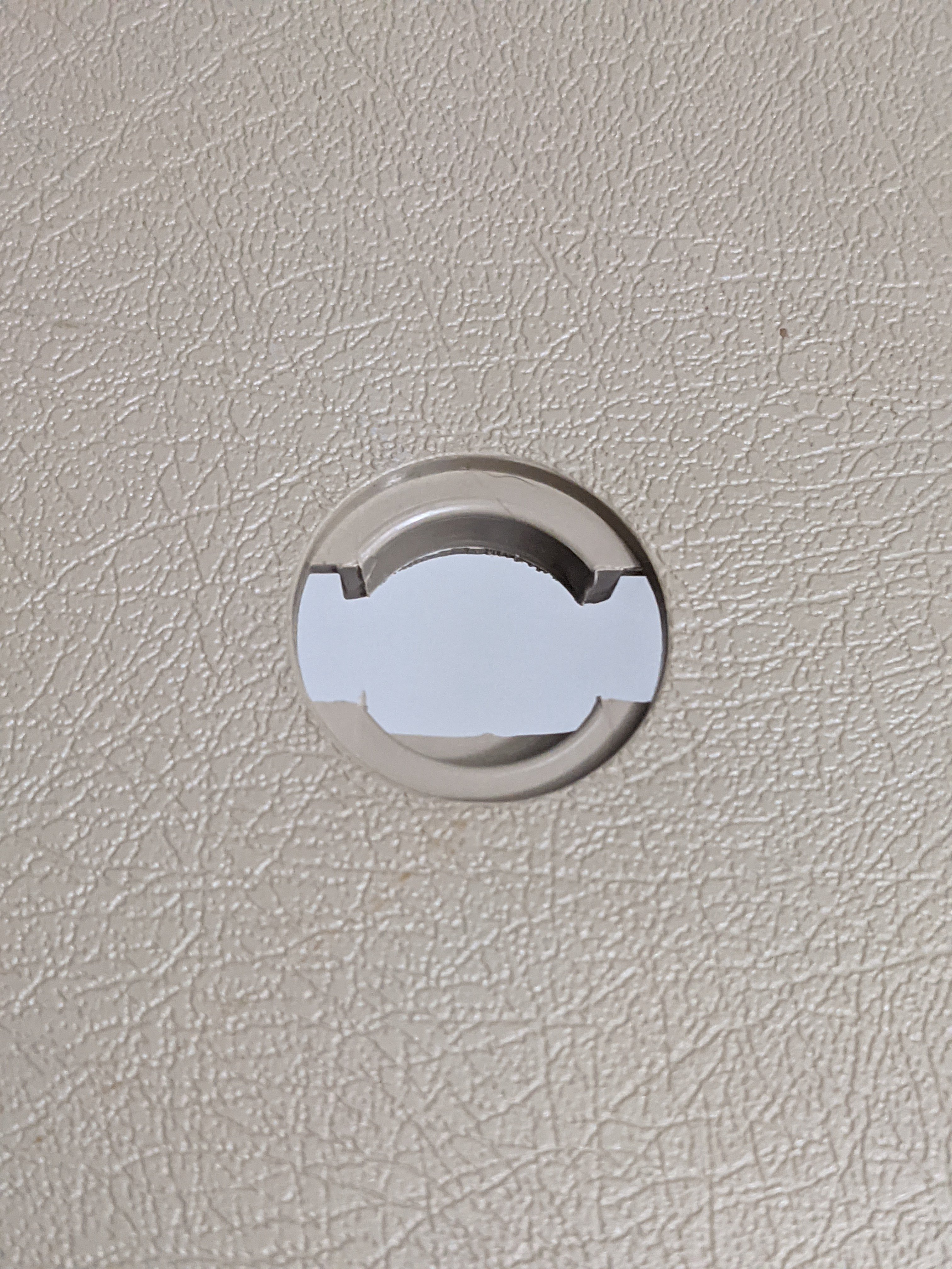

I just got Stabilus for my 2000 V70. Now when opening the trunk, I have to quickly move out of the way so it doesn't uppercut my jaw! I spent the extra money to have long lasting parts so I don't have to remove the plastic again any time soon.
I ruined the plastic piece around the trunk ceiling light. After unscrewing it, the plastic at the base of the screws was quite stuck to the sheet metal above it. Gently pulling the panel down broke both screw bases. Now I have to epoxy those bases back in to place. I'm still trying to find an ABS glue which is thick like epoxy so I can make a "cast" around the brake. That or I'll make an ABS "washer" to bridge the gap. So, be careful when removing that panel.
And get Stabilus so you don't have to touch the plastic again. Worth it for $22 extra. At 20 years old, my old ones still slightly worked during NH winter (a lot warmer than Canadian winter).
