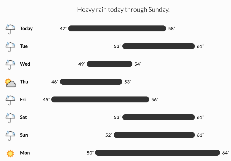

While I'm waiting for good weather and free time, I'm thinking about things. Like, what solutions do people use for working under their cars? I was thinking of getting one of these:
Although I am a bit concerned it might not work well on uneven ground (i.e. my poorly-paved asphalt driveway). My current solution is a couple of those foam anti-fatigue mats laid under the car and then trying not to scrape myself on the asphalt as I shimmy out and in.
