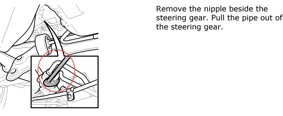

Thanks! That looks like it will work really well. I have a few extension bars I can attach them to and hopefully that will be able to get in there. The attached photo shows the diagram I'm using with the parts in question circled in red.cuhfs wrote:Not exactly sure which or where that particular nut is... but when I did my steering rack, I found a flared crows foot wrench http://www.harborfreight.com/7-pc-38-in ... 68999.html was needed and could only do about 1/8 turn or less at a time. Good luck
As a side note, I actually didn't realize my first time through that the shaded piece in the diagram is a special tool you're supposed to use (the equivalent of the crow's foot wrench). I assumed it was a pipe and that they were highlighting the one you were supposed to remove.
In any case, I think if I get those crow's foot wrenches I'll be able to properly complete the replacement. I'll let you know how it goes!
