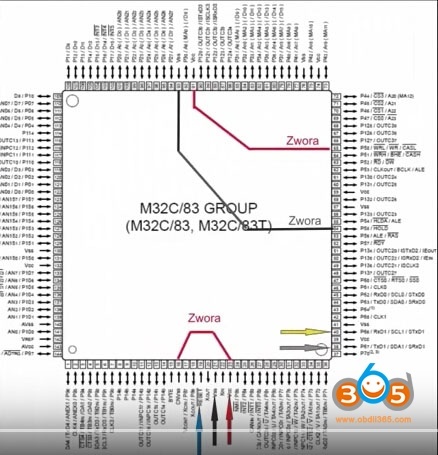

blasaab wrote: 05 May 2021, 09:00 Im not able to crack my pin so looking at other way. I should have m32c in my car. Is there a guide how to connect throu wires in car or on bench

That was for my s60 that i finaly cracked in my car

I dont know if im doing something wrong. When i did p2 my first 2 pin was always the same and now im getting random pin. Should i add resistor or ignition on? Does my reads looks ok?
