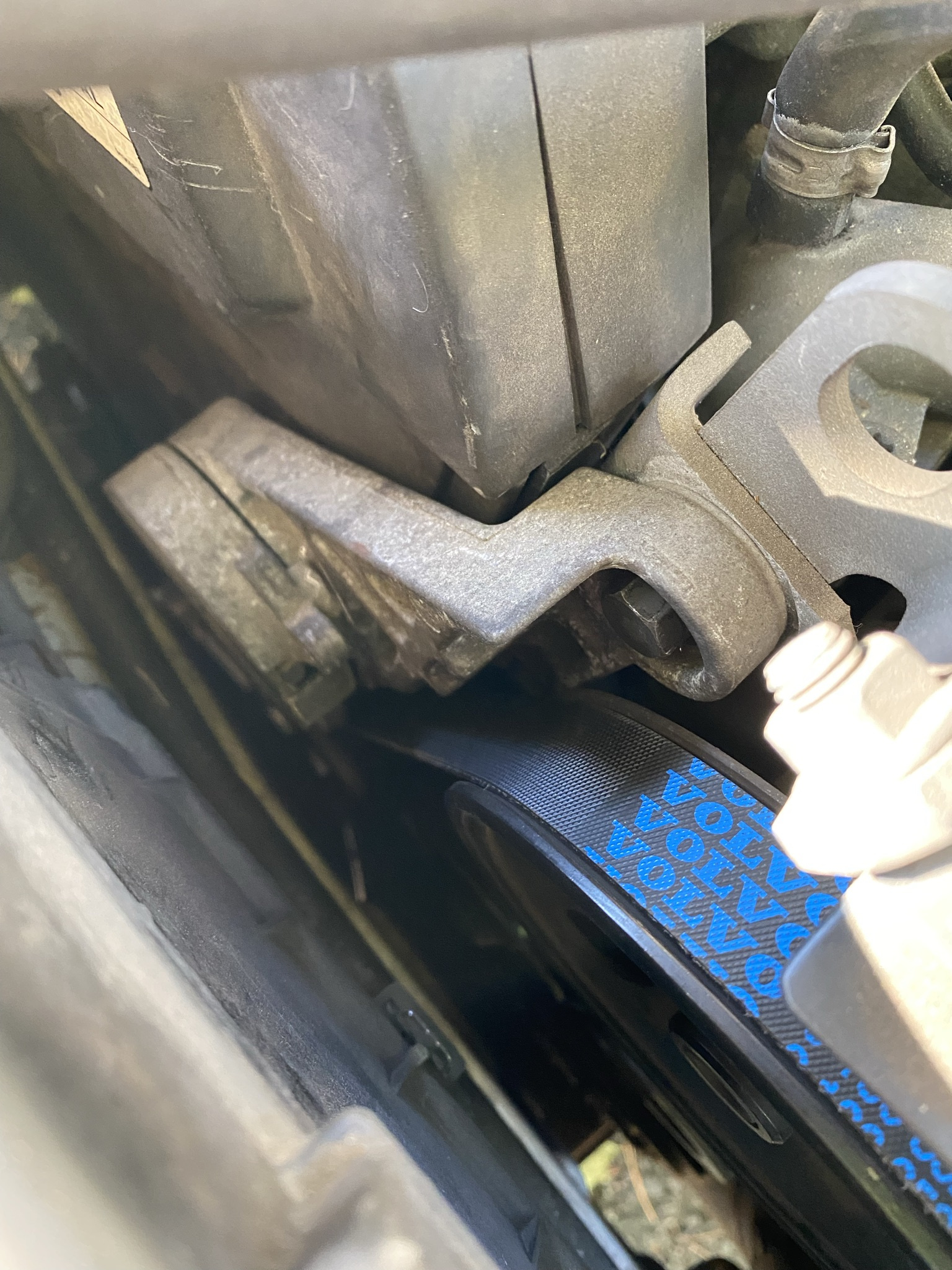

I’ve had trouble fitting 4 Conti serp belts on pre 1999 p80s this summer
In each case , with the tensioner pinned in full release position , I was unable to install the belt over the power steering pulley ridge with strong hand pressure or even using a wooden dowel as a pry tool.
Last job I had owner buy both the Volvo and the Conti and the Volvo was tight but easier.
I have actually had to remove the tensioner ideally in GrunHilde , install the belt , then work the tension back into place around the belt
Is this normal for the -1998s?
I spent an hour trying to mount the Conti belt last time
Afterwards , here is how the Volvo tensioner rides , can some 1998s take a pic of the tensioner and post here please ?
P80 serpentine belts Conti Volvo 2021

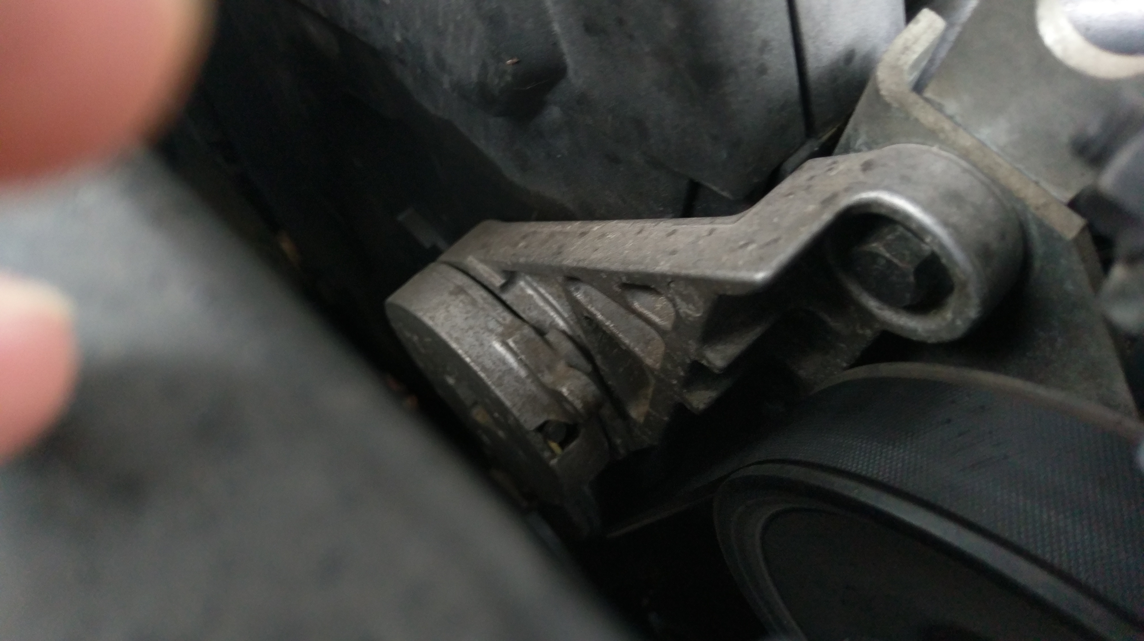

It is a new belt. The tensioner will move down as the belt gets broken in.abscate wrote: 10 Nov 2021, 06:42 Afterwards , here is how the Volvo tensioner rides , can some 1998s take a pic of the tensioner and post here please ?
1998 C70 with Continental belt , 18,000 miles.

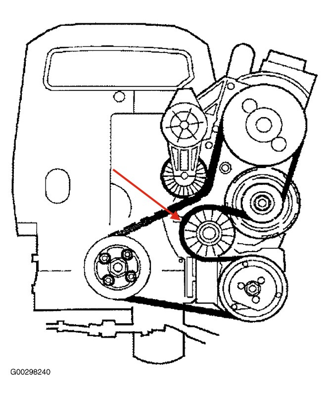

Yo,
Ifight some many times with these f*cking belts.. Finally, the easiest way was to install the belt and finish by the part designed by the red arrow : it goes as in a brief !
Manov

For sure, idler pulley is the last one on
- Posts: 36142
Of course. If you fit ps last you have to stretch past both the pulley lip and the depth of the ribs. MAybe I should look up the actual procedure
