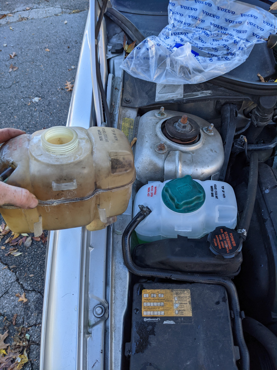

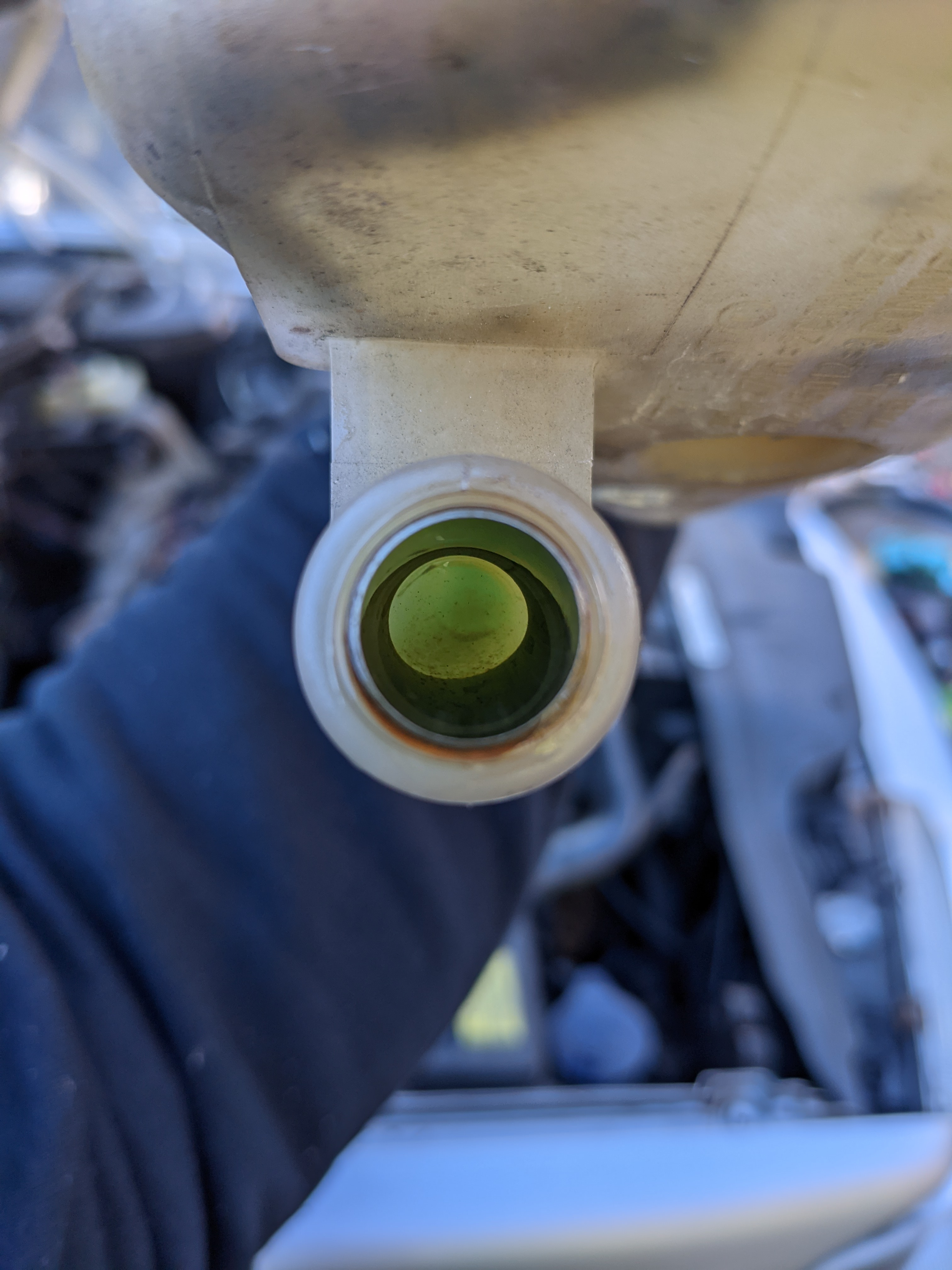

Finally got around to swapping out my coolant reservoir tank and the cap. Volvo tank and whatever cap FCP had, but kept the original cap just in case the non-volvo one gives me issues since the underside was a bit different. Tank had been leaking from the small top port overflow line. I inspected the line which seemed fine and figured the original tank was due anyway. Did find some deposits in the coolant. I've drained and filled it twice in the last 2 years, once when i had the head off and once when i pulled the engine to do the clutch. Now with a clean tank i can actually see the coolant and it looks as green as it should be so I'm hoping the deposits are just from the miles on the original tank.

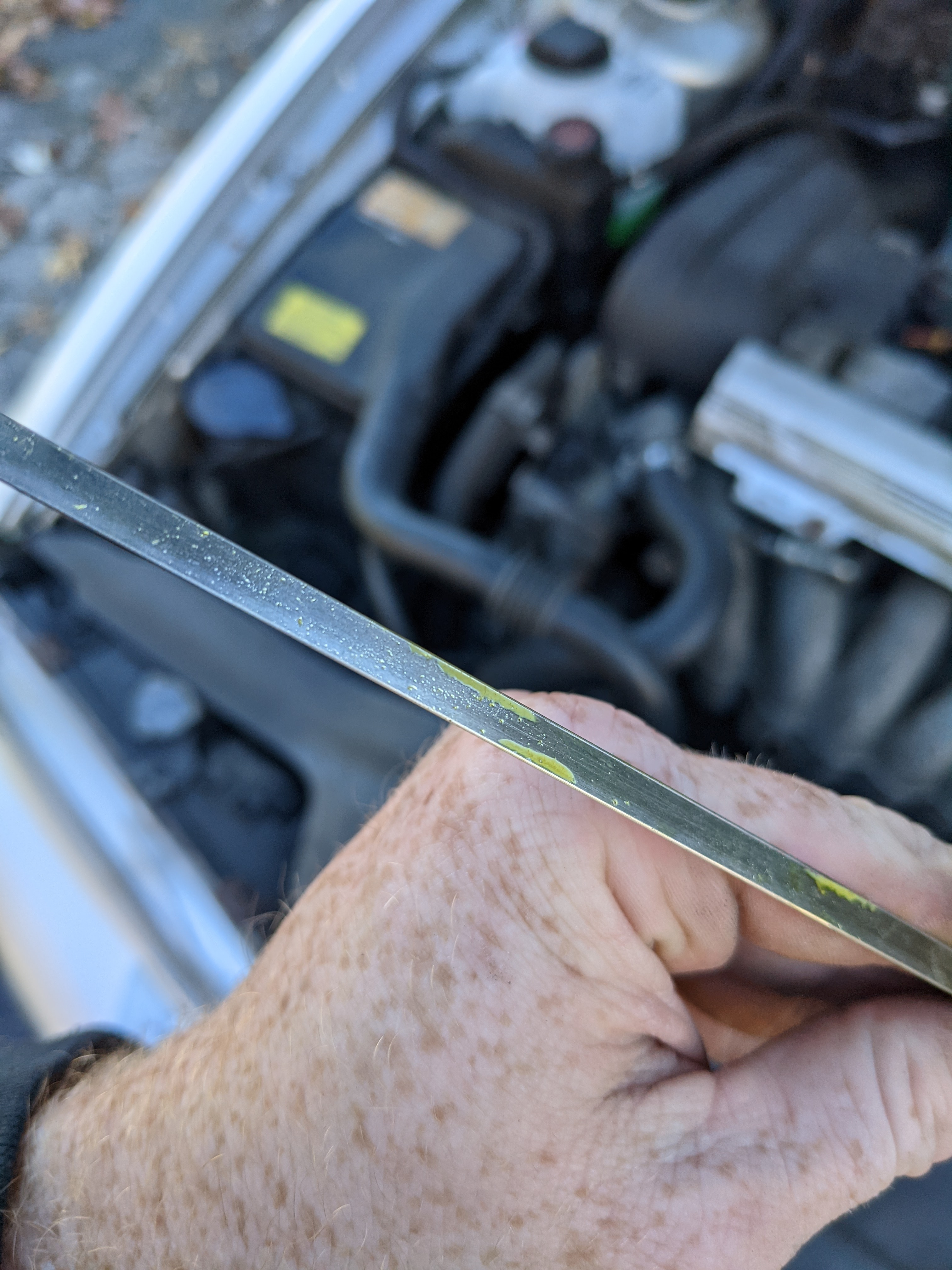

Also changed the oil, still losing about 3/4ths of a quart over 3500 miles. Not terrible i suppose. I did notice some weirdly yellow deposits on the dipstick. Much more saturated and vibrant of a yellow than the oil, so I'm not quite sure what it could be.

Little bit of sludge on sides of dipstick tube? If coolant level and oil level are stable , I’d ignore that.

Looks like water from condensation. Do you do a lot of short trips? You might try taking the car out for a long highway run. That will heat up the oil and give it time to evaporate the water. The PCV system will evacuate the water vapor. Water vapor is a gas and the PCV system is there to evacuate gases from the crankcase.smacknab wrote: 13 Nov 2021, 09:55 I did notice some weirdly yellow deposits on the dipstick. Much more saturated and vibrant of a yellow than the oil, so I'm not quite sure what it could be.

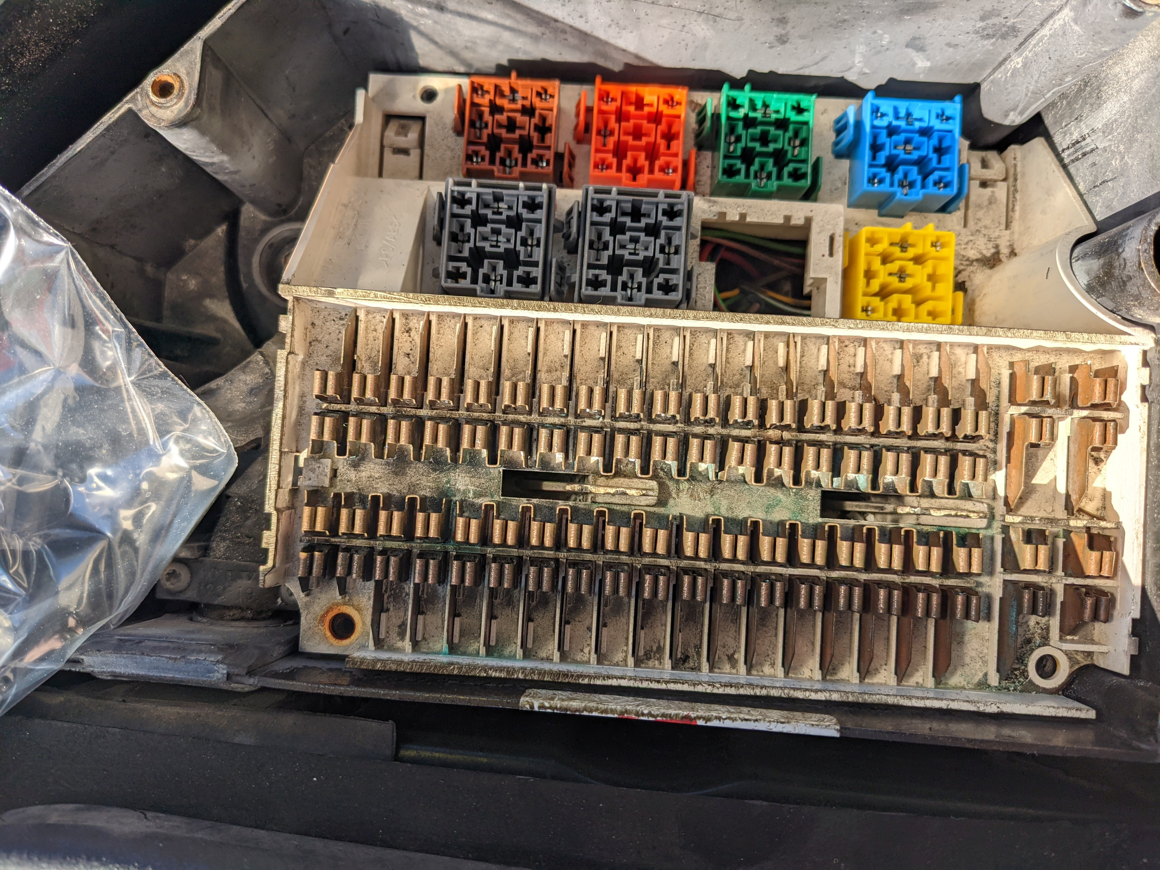

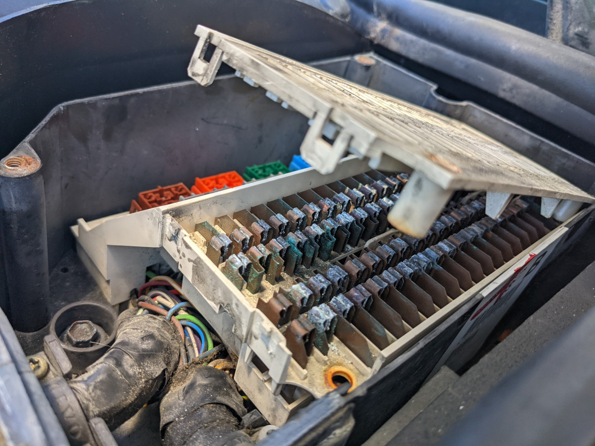

Finally got around to fixing the issues in the fuse box with a smidge of corrosion.
Before:
After: Steel and brass bristle brushes that had been previously dipped in motor oil were used for the clean. Couldn't find my wheel for my Dremel so it was done the old fashioned way...
Before:
