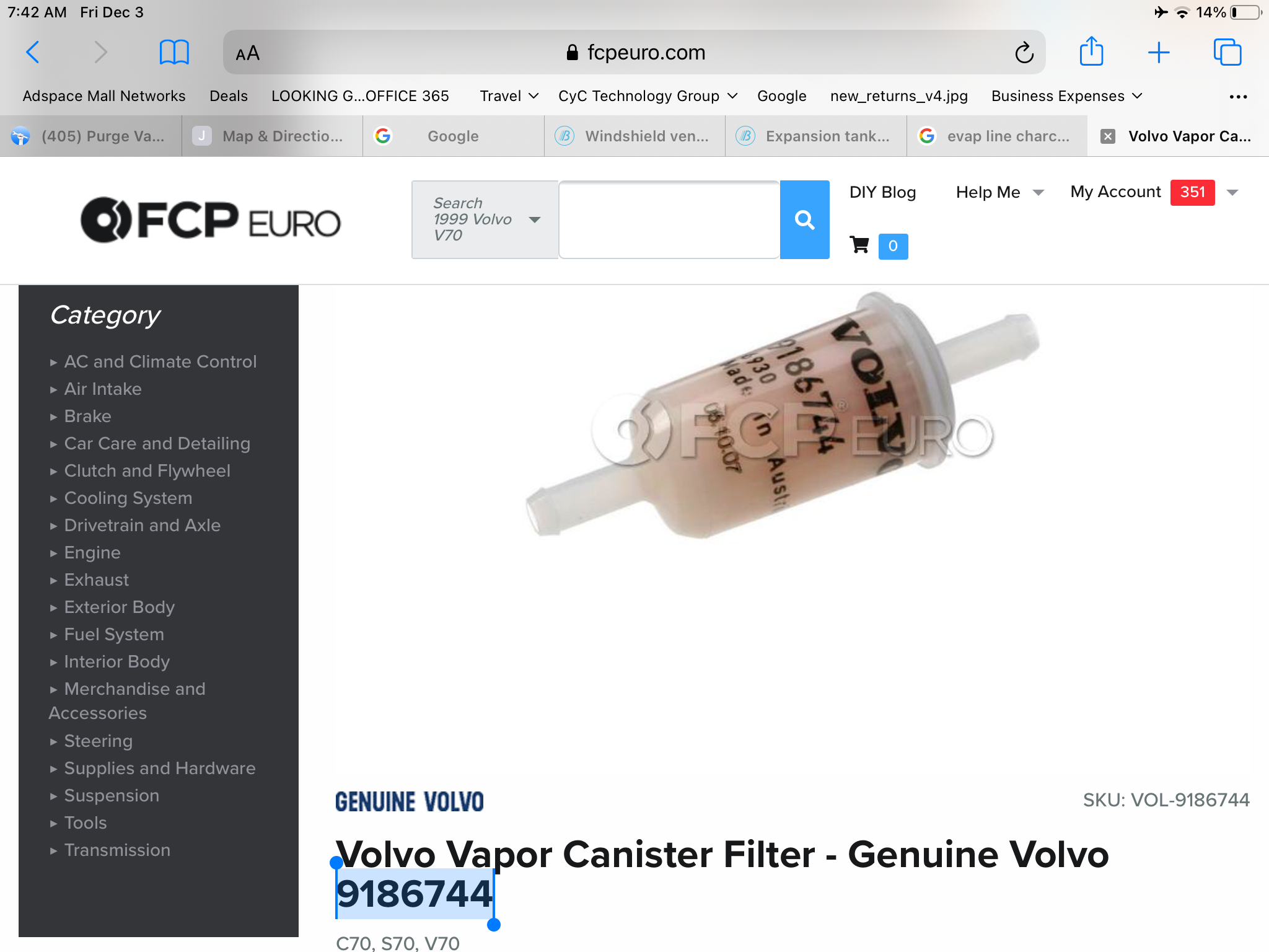

Wasn’t there a small filter on the evap line on p80 cars? Maybe that is worth a shot?

abscate wrote: 26 Nov 2021, 01:59 Wasn’t there a small filter on the evap line on p80 cars? Maybe that is worth a shot?
9186744

abscate wrote: 03 Dec 2021, 05:39 9186744
For P80 S/V/C70 with emission codes 3 & 4. Some have a Purge Valve filters, some do not.
If the EVAP canister is in the front and square shaped, you have a Purge Valve filter.
If the EVAP canister is in the front and round shaped or located in the back you don't have a Purge Valve filter.
For the P80 S/V/C70: Emission codes 8th digit in the VIN number.
Emission codes 3 & 4 : EVAP canister is in the front, square shaped and you have a Purge Valve filter.
Emission code 0,2,6,B,C,E,F & K : EVAP canister is in the front, round shaped and no Purge Valve filter.
Emission code 7 & 8: EVAP canister is in the rear,, square shaped and no Purge Valve filter.
