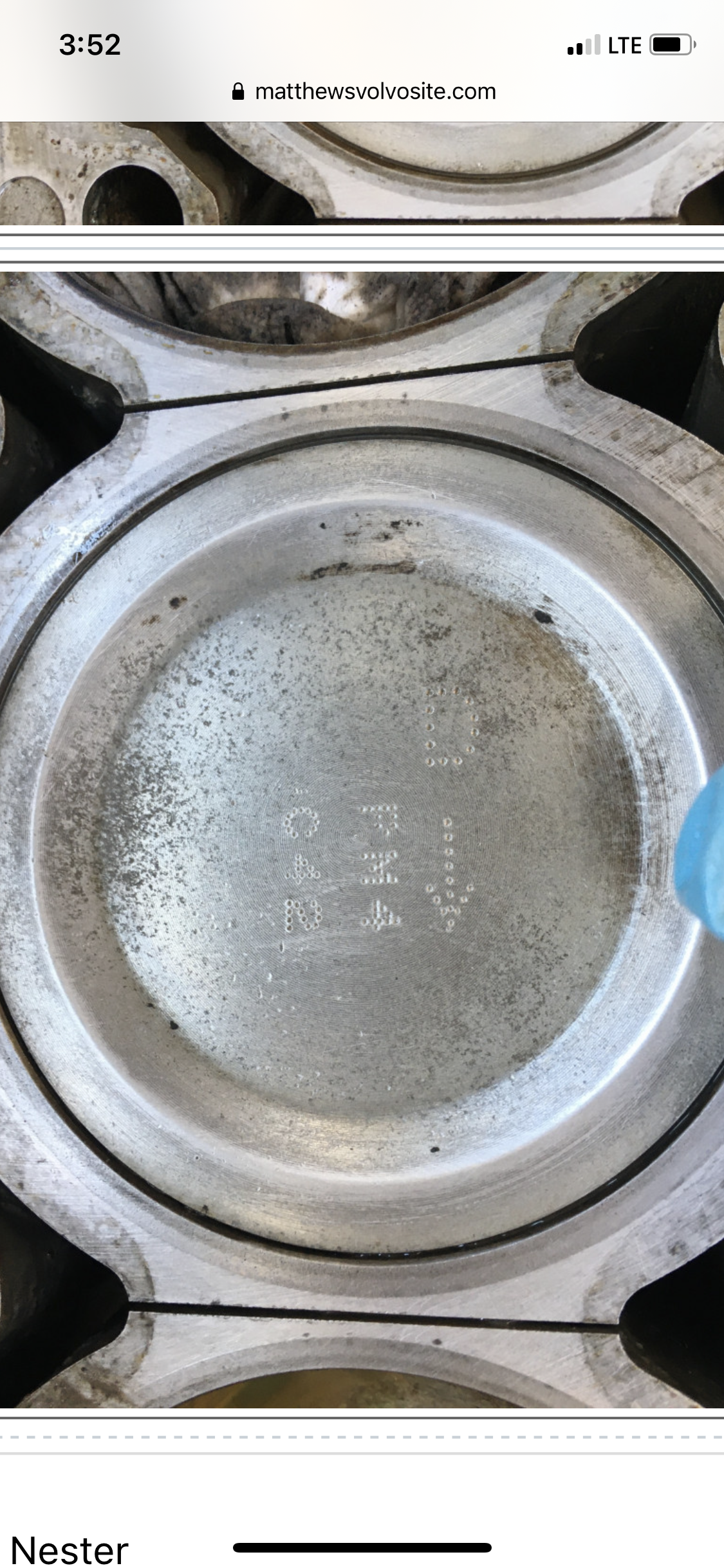

If you can get your hands on a bore scope you can probe the spark plug holes and look for ding marks in the tops of the pistons.

You almost always have dings from the valves hitting. I usually grind them down not to create any hot spots.

Take a look at my T5 rebuild thread to see pictures of top of clean pistons. I’ve seen dings and semi circular marks that are standard, but my T5 didn’t have them
