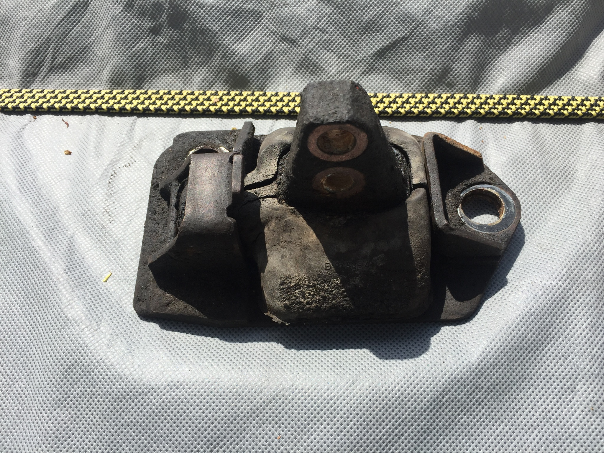

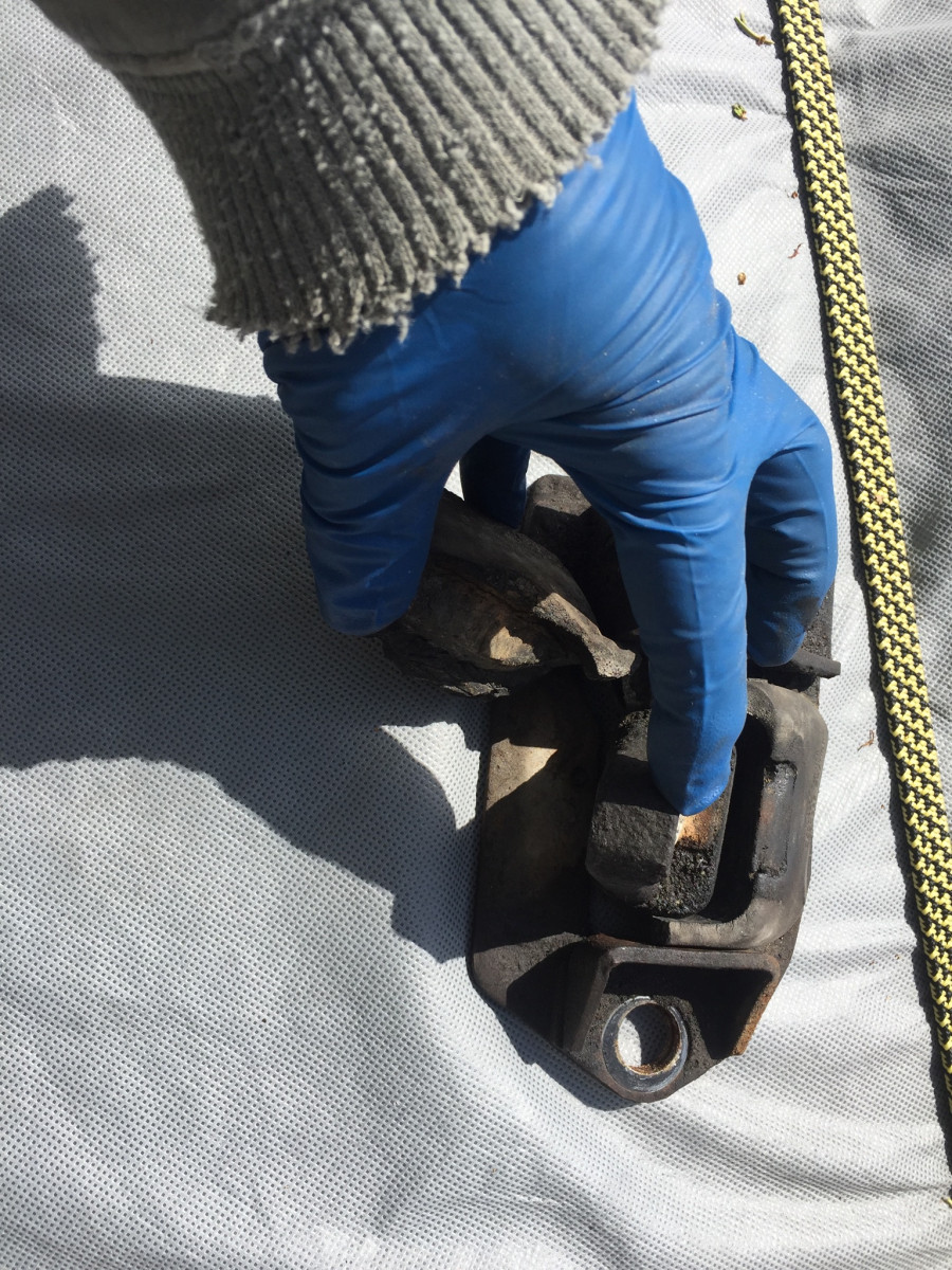

This was the one from the '03 S60... it was trashed! I wish I took a picture of the one on the 98 V70 I just replaced the engine in. It was by far the worst I'd seen... totally separated into two pieces. I didn't even bother unbolting it to lift the engine, then realized the front part was hung up under the bottom bracket. Unbolted it and it let the engine loose.

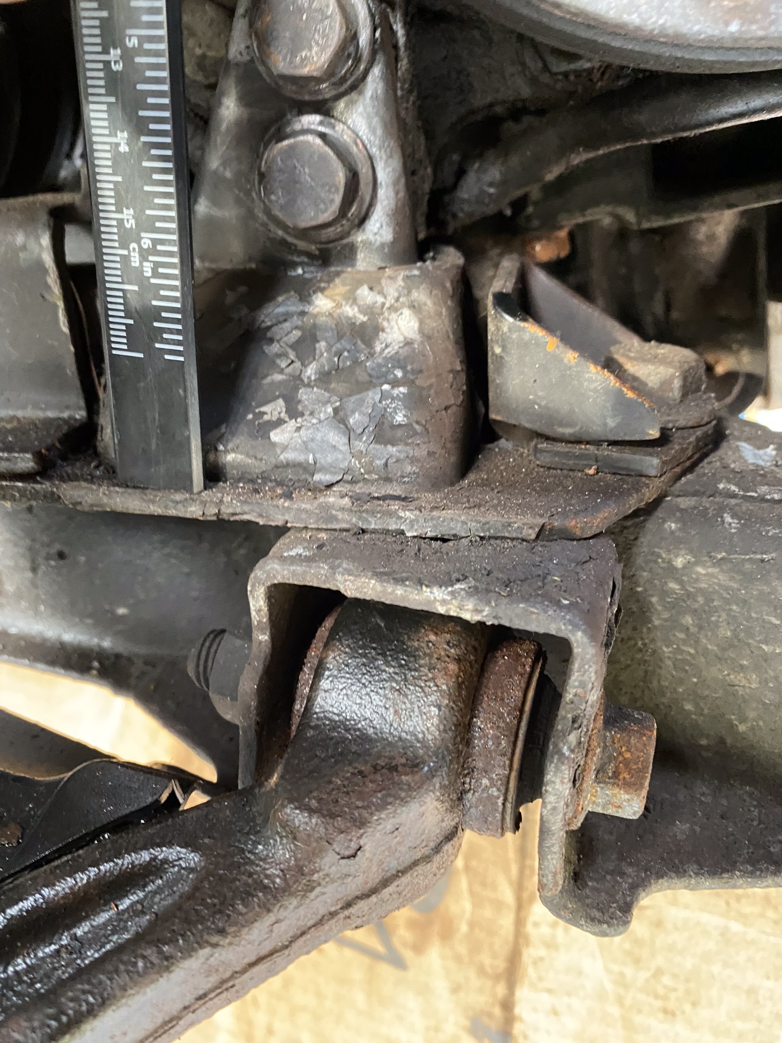

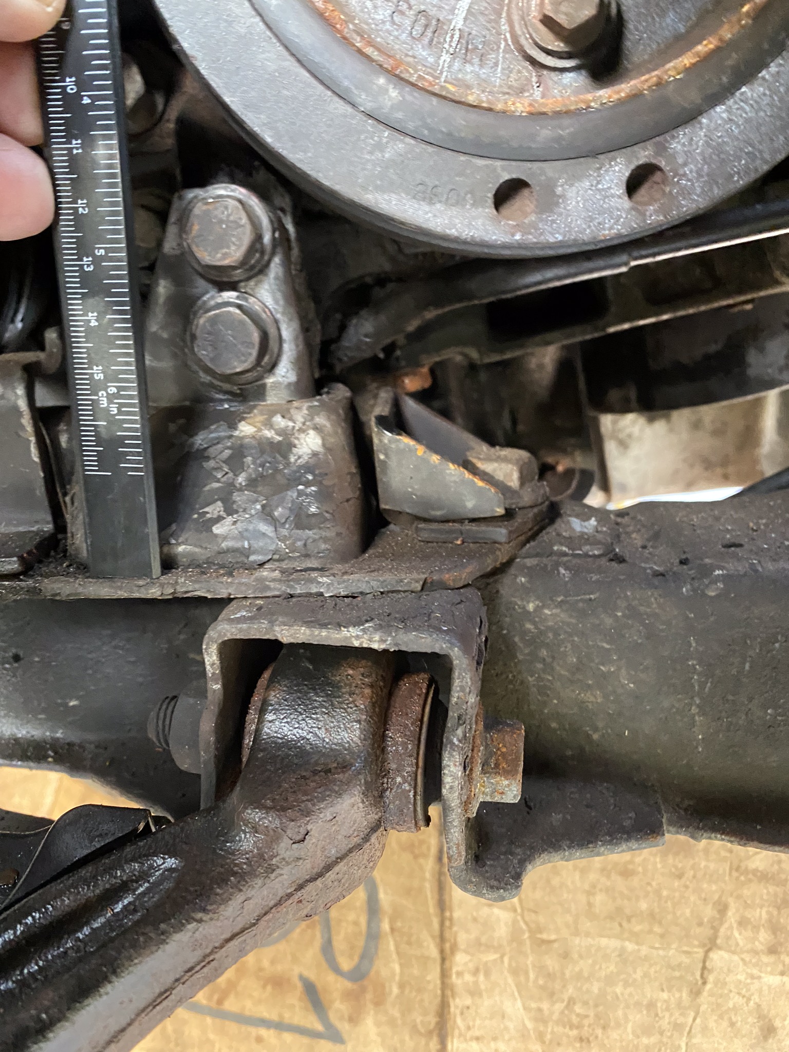

June and Abscate, part numbers are good but readers should be aware that the side engine mount pad was redesigned somewhere around the 98 to 99 break. There are two different versions of this mount that look almost exactly the same, but the mounting holes WILL NOT line up if you have the wrong one for your car. I am guessing that you two are aware of this, but it needs to be pointed out to other readers and searchers. I just did mine on the '98 V70. At about 155k miles, the one that went bad was not a factory OEM Volvo part., so I may be on my third. I installed a Rein part. This was actually a pretty easy and quick job. I saw no signs of corrosion at all, but I don't live in upstate NY. In case anyone wants to know what the symptoms are, they are mostly noise and vibration. You may think you have an issue with your exhaust system. When the mount goes bad, the engine is free to move around because the rubber pad is no longer bonded to the brackets. It may not be obvious just by looking at it, but as soon as you lift the engine a bit with a floor jack, it is readily apparent.

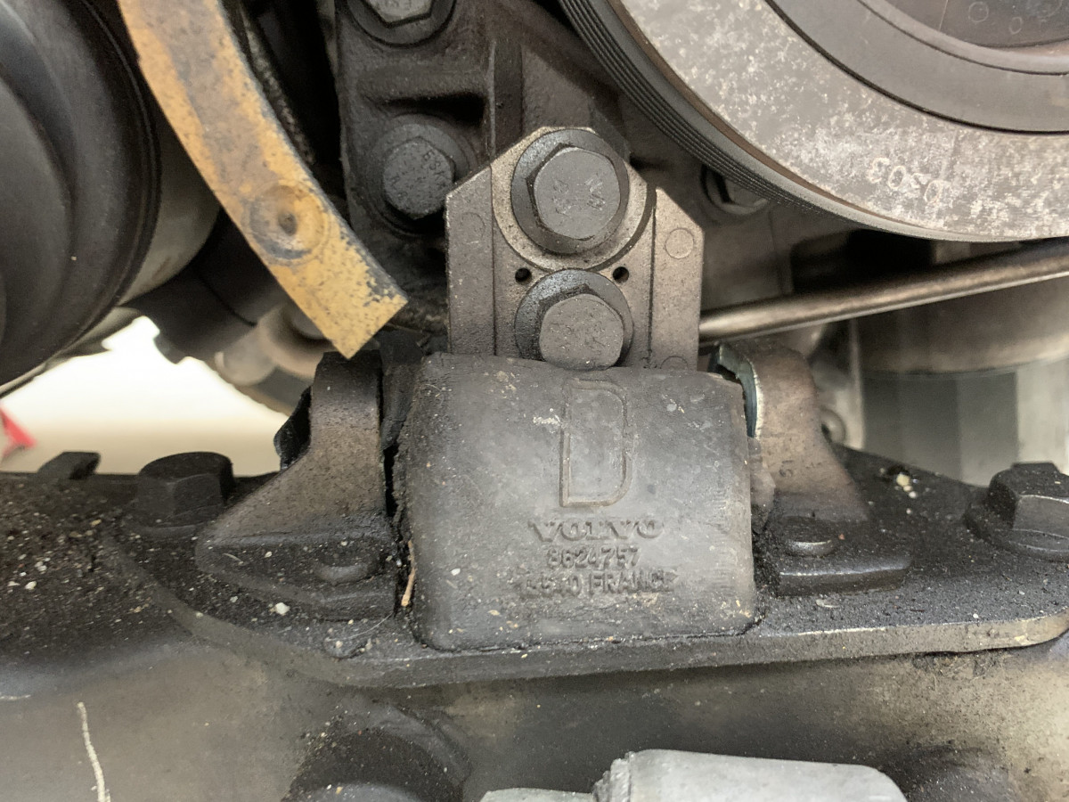

Eddystone, You nailed This.
I had an open issue with occasional clunking in the CVs and guess what! It all went away with the motor mount replacement.
This was ugly...
This was ugly...
