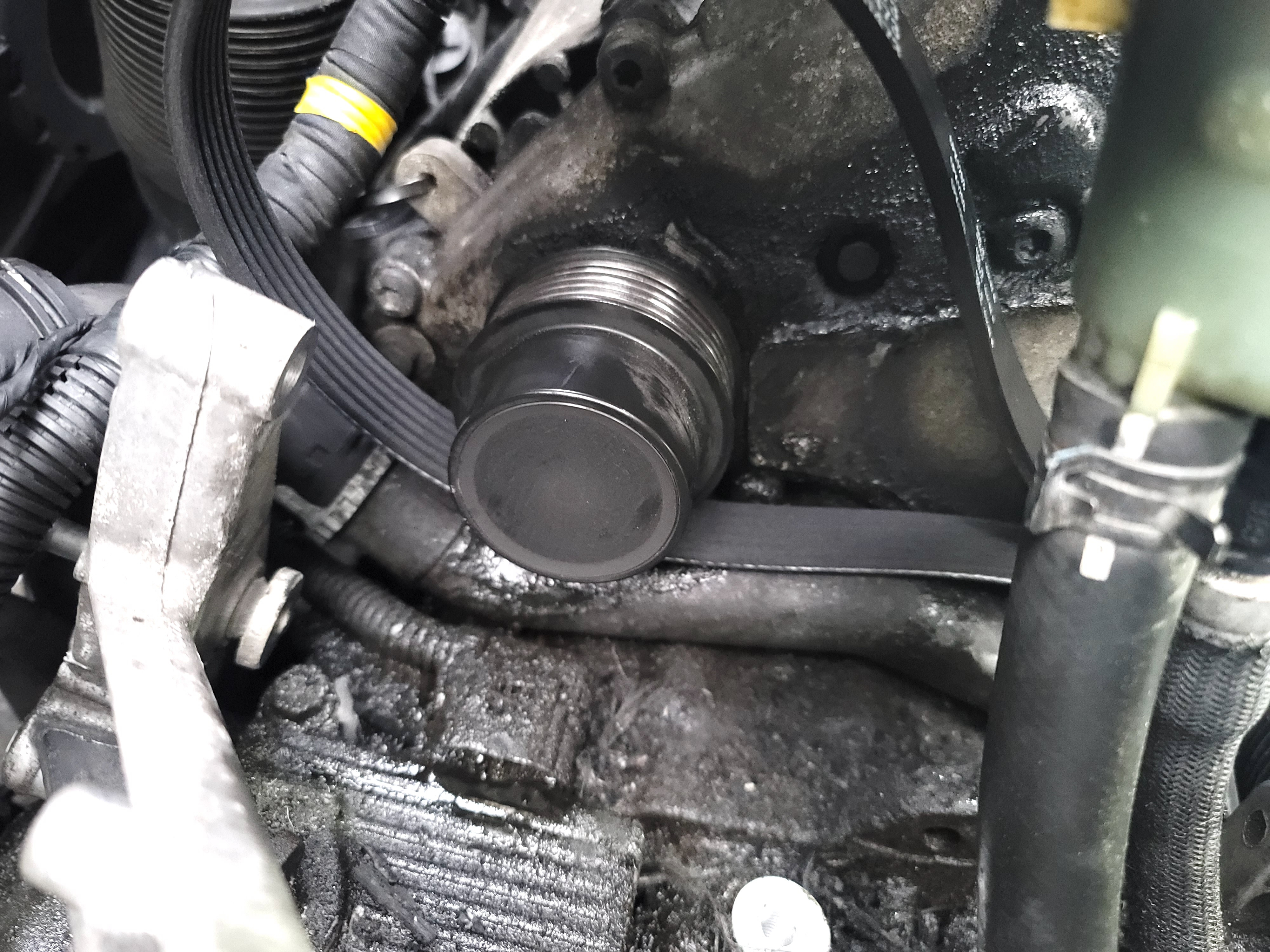

Once again... nevermind. I'm too used to having a big crankshaft pulley. Freaked me out for a minute that the "alternator pulley" wouldn't spin. Then I stared thinking like a diesel mechanic and figured out it was the gear drive for everything. Duh.

If the pulley in the picture is working it will spin easily in one direction and not at all in the other direction.
You are correct it is gear driven but it should freewheel like a bicycle

The Alternator will freewheel when the drive pulley is spinning slower then the Alternator. That way the spinning mass of the Alternator does not stress out the other components. Less vibration, Longer belt life and saves some fuel.

As pgill notes, that belt drive should turn kind of freely in one direction. Mine was seized when I replaced everything on that end of the engine, but the new one couldn't be easily turned when it was off and in my hand. I really couldn't secure the hub to turn the belt pulley without bolting the hub to something. Now, when installed, I can turn the AC pulley in one direction by hand (engine off
Also noted above, is that the alternator has one-way freewheeling capability, as the alternator has a similar coupling on it. I've purchased one and plan on replacing it along with the voltage regulator and engine thermostat in the near future. Most projects on modern cars are like archeological digs, it seems.
The one-way clutches probably help with belt stress and longer service life, but there may also be a relationship to bearing wear or failure in the Rear End (Engine?) Accessory Drive, or READ unit. There's a poster in a SwedeSpeed forum that suggested that there's a cause and effect scenario, so it may be worth pursuing. The web site for the READ poster is https://www.volvoread.com
