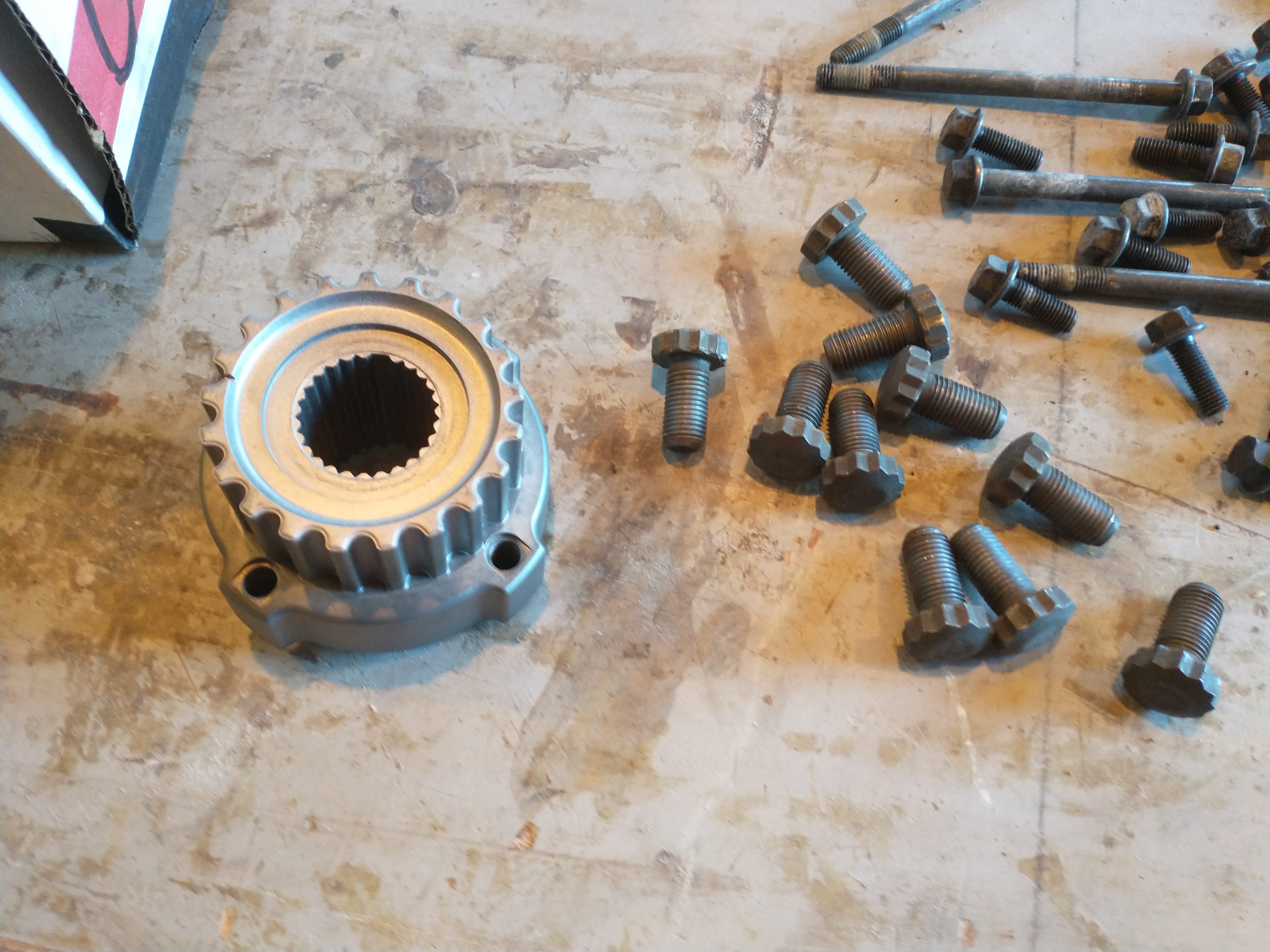

First questions about mysterious parts...
What are these 10 " star " bolts for ?
And does the gear just slip over the end of the crank shaft ? The gear seems to have an indexing mark on the inside of it, but I don't see any corresponding mark on the shaft end. It does start to slip on about half way in one position. But since this seems to relate to TDC, I'm guessing it needs to be right.
1999 V70 GLT
Posts: 35299
Has thanked: 1505 times
Been thanked: 3818 times
Pretty sure the externals are the flywheel to torque converter bolts…
The hub only goes on one way, the crankshaft splines have an index which will match the hub
Flywheel to crank bolts , see below

abscate wrote: 04 Jan 2022, 15:41 Pretty sure the externals are the flywheel to torque converter bolts?
Those look more like flexplate to crank bolts. (The qty also jives). The converter to flexplate bolts are internal Torx and there are only 6 IIRC.

So for you logical types that might be following along; there are 10 bolts that I could not identify.
They were in the box of parts that the machine shop included with the old parts.
They hold the flexplate on to the crank.
Therefore the flexplate is still 130 miles away at the machine shop :x

Well, it’s better to find that out before engine installation

Yup, I was going to say those are the flywheel bolts before my cat sat on my keyboard and I got distracted :lol:
