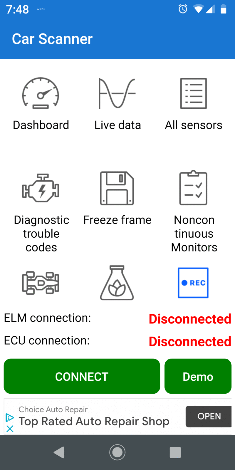

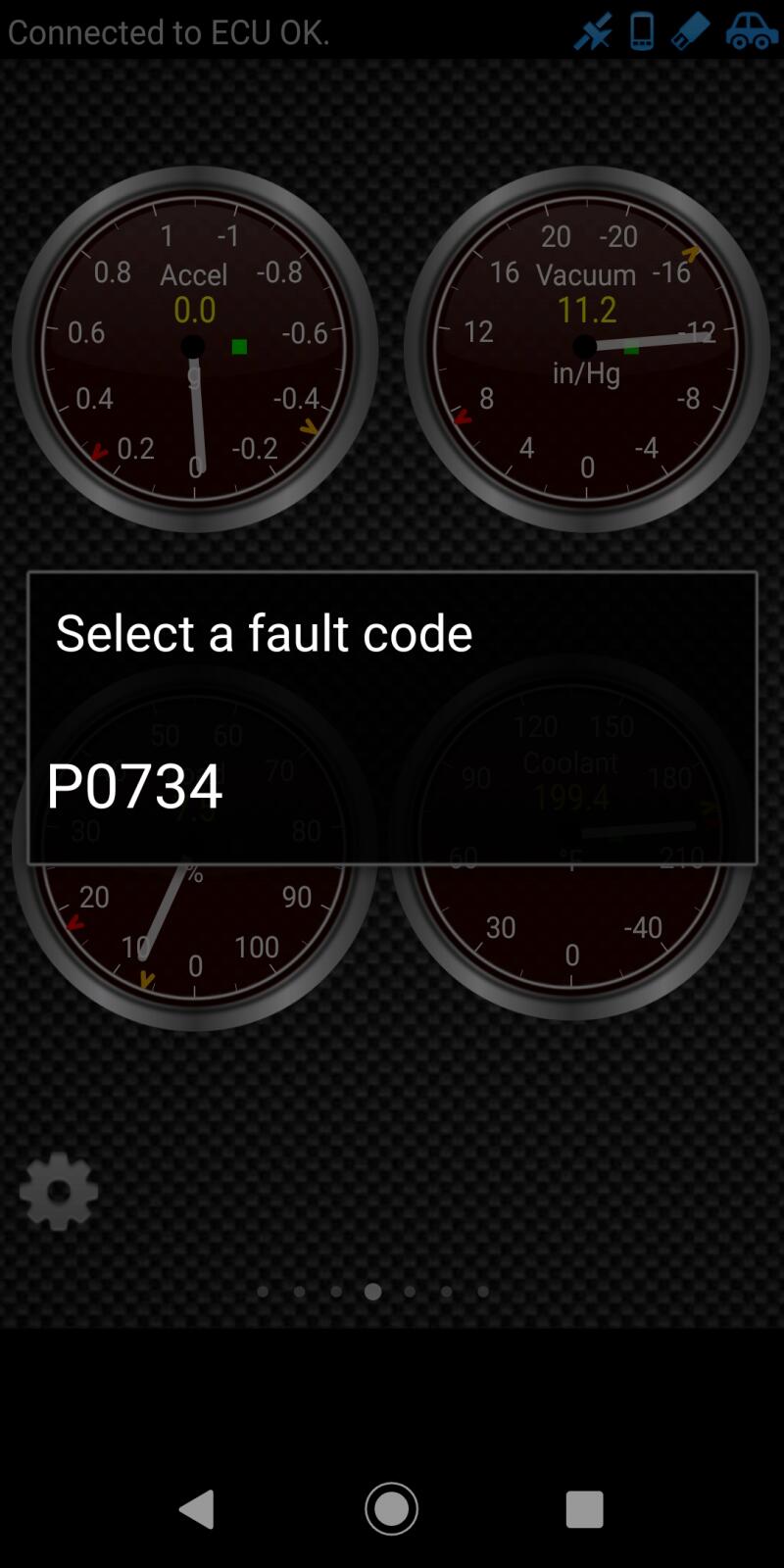

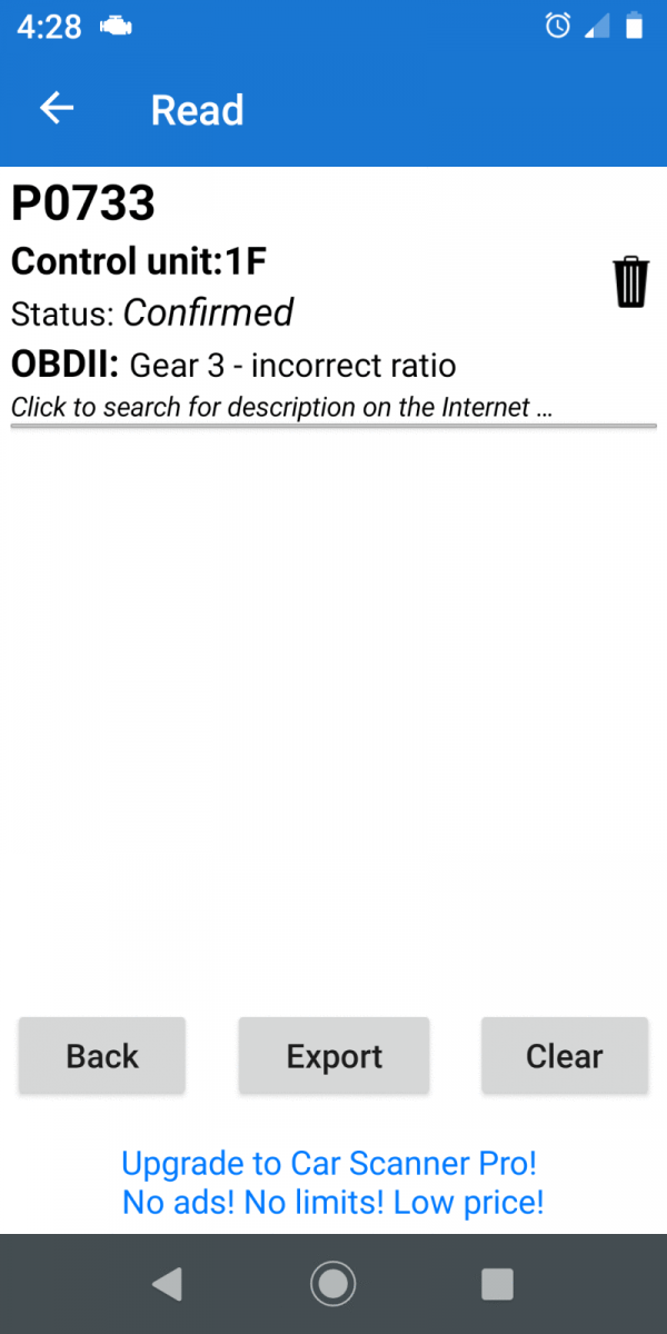

Buy any mini OBDII dongle like this one and download the free Car Scanner app. Checked for codes asap then check the condition of the trans fluid besides level. Best free OBDII software used thus far. Beats others by a mile and ad is not noticeable at the bottom. The last photo is from the Torque Lite app. Was useful but now...
https://www.amazon.com/Panlong-Bluetoot ... 113&sr=8-6
This is only half the menu.

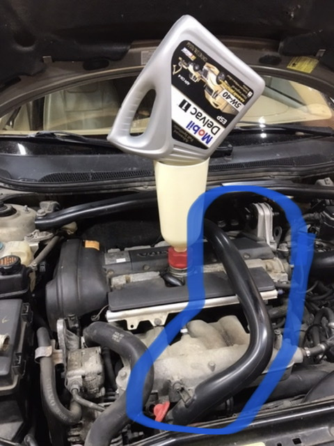

Caleb, this could be a lot of different things. Let’s start off with which engine is in your car. Do you know if it’s turbocharged or N/A (naturally aspirated aka non-turbo)? If you don’t, an easy way to tell is if there’s a black pipe about 2 1/2 inches in diameter running over the top of your motor… if present, your car most likely has the 2.5 liter turbo engine.
If this is your engine, there is a chance that this pipe (known as the OTE (over the engine) or Charged Air Pipe may have come disconnected. Check both ends of the pipe to see if the rubber hoses are still worm-clamped securely, and check both ends of each rubber hose to verify they are secured. One hose should be secured behind the engine connecting the OTE pipe to the the turbo, the other rubber hose attaches the OTE pipe to the intercooler up front.
Alternatively, there is another pipe that mounts to the underside of the intake manifold that can come off. In either of these situations I would expect you to notice a change in the way the engine sounds and also a dramatic loss in power.
