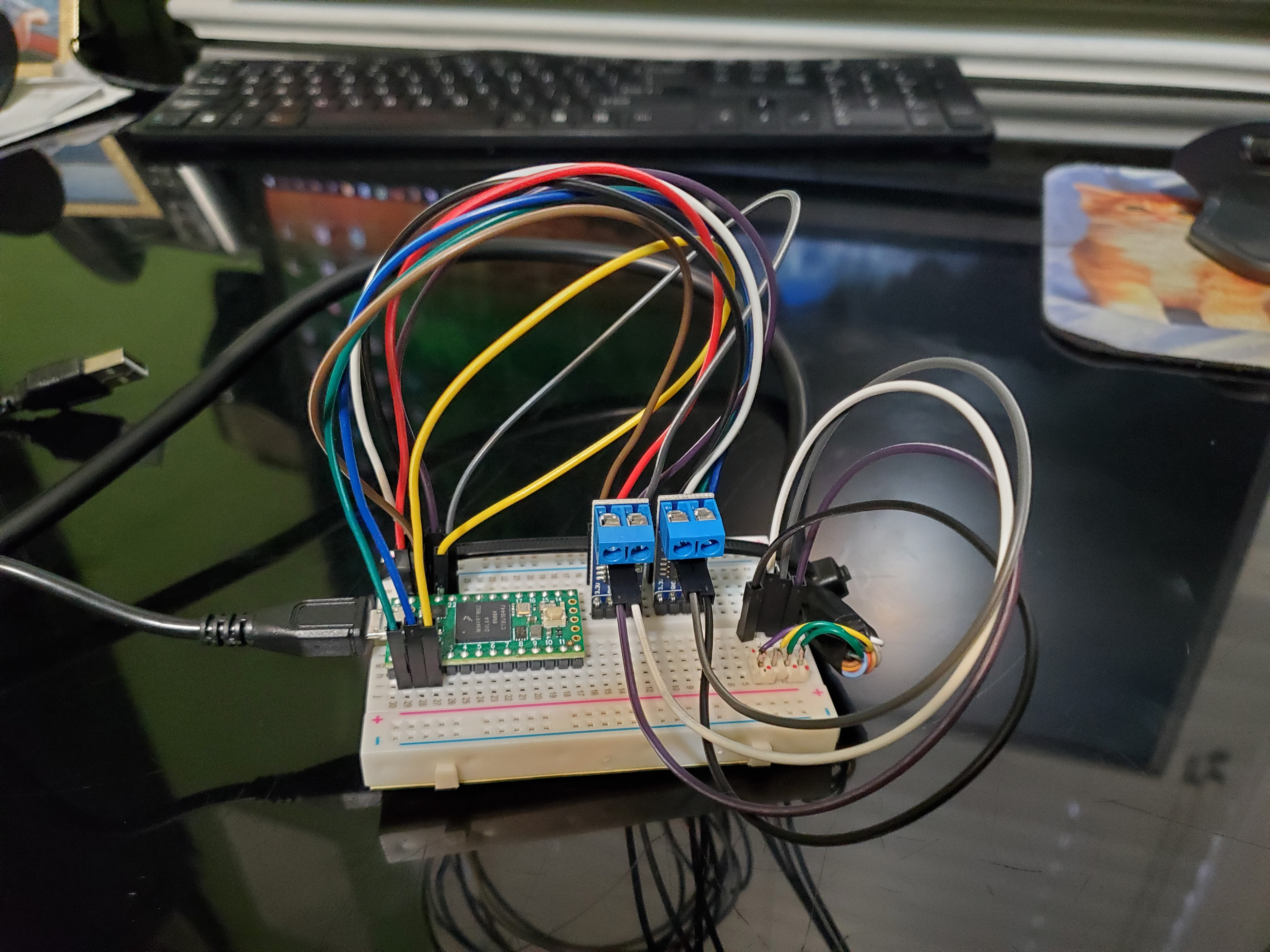

Hello everyone,
I tried to build the cracker, but I'm not a professional electronic. Last time I dealt with uC in my high school > 20 years ago. But I have some basic knowledge.
The device was connected to a car and to a laptop, all from batteries. In the serial window it says:
Reading part number from ECU 0x40 on CAN_LS
CAN_LS ---> ID=000ffffe data=cb 40 b9 f0 00 00 00 00
CAN_LS <--- ID=0131726c data=00 0c 35 52 00 00 00 3f
CAN_LS <--- ID=01e0162a data=40 10 00 60 07 00 99 00
CAN_HS <--- ID=11220028 data=03 40 f3 3e 86 00 33 1f
CAN_HS <--- ID=01000020 data=00 00 00 01 b0 04 c0 00
CAN_HS ---> ID=000ffffe data=cb 50 b9 f0 00 00 00 00
Unknown CEM part number 0. Don't know what to do.
and stops. I have the most recent version of the software. I checked all connections and I think they are ok.
I tried key in position 0 and 1.
When the cracker was connected to OBD2 and key in position 1, there was weird knocking in gear shifter (it is automatic 6 speed).
I used Teensy 4.0, and 2 x "Waveshare SN65HVD230". I use 3.3 volt power only, from laptop usb. Is there something obviously wrong I'm doing? Thank you for any help.
Adrian

Year and model of car.
Post some close up high resolution pictures of you Cracker. Perhaps we can spot some issues with the build.
How is the battery in the car? Measure the voltage drop.

Clicking solenoids is a sign of some problem in CAN communication. Do you have common ground between Teensy and OBD connector?askrobek wrote: 18 Jan 2022, 19:38When the cracker was connected to OBD2 and key in position 1, there was weird knocking in gear shifter (it is automatic 6 speed).
Also you can try to disable CEM_PN_AUTODETECT (remove line 14: https://github.com/vtl/volvo-cem-cracke ... er.ino#L14), in a hope your car has 500 and 125 Kbps buses.

Thanks for all the responses.
It is 2007 S60R. I attached 2 pictures of the cracker.
I will check the battery and try other things after work in the evening.
I do not have the common ground between OBD2 and Teensy. I will try that too. And I will try to comment out the code and let you know in any of these helped.
Thanks!
Adrian
