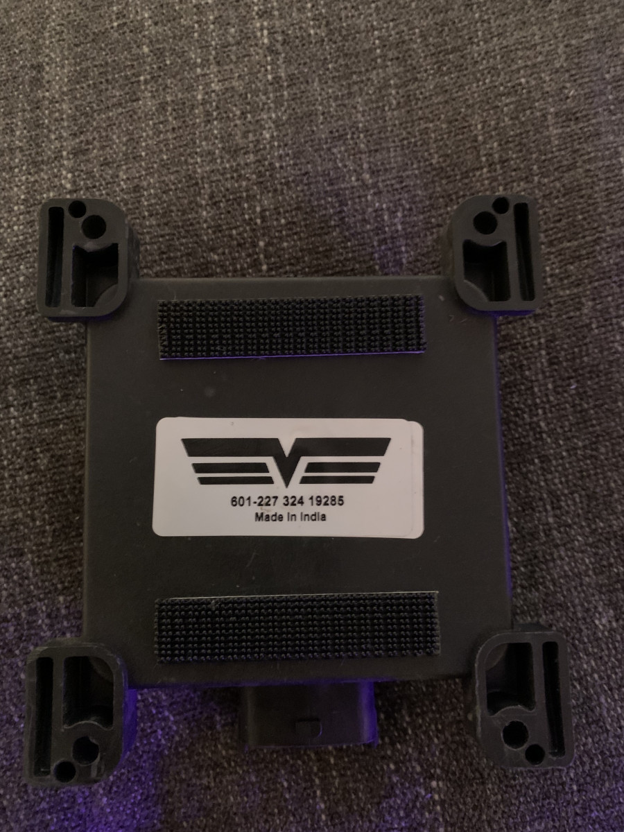

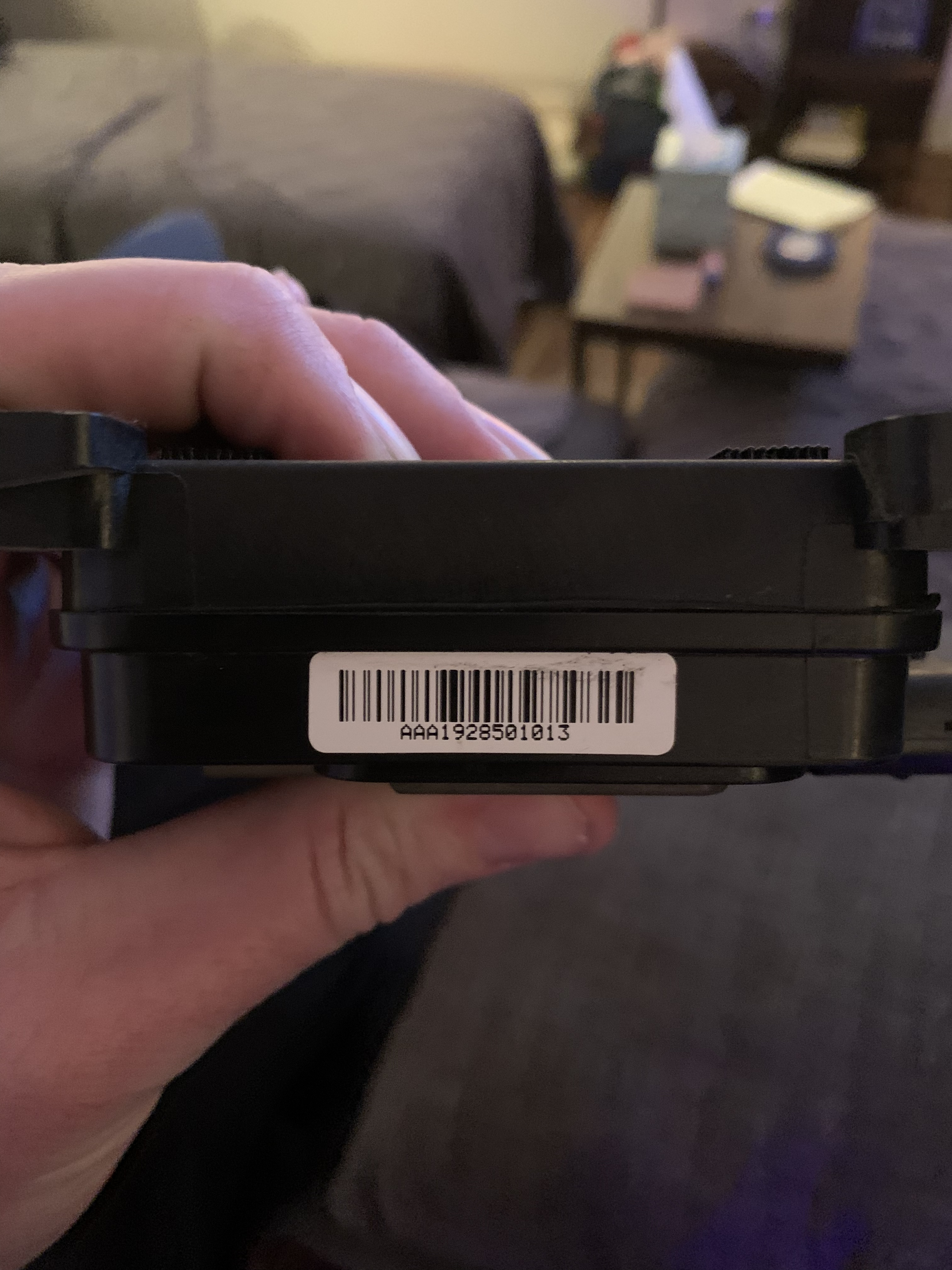

Nuncio, can you pull your part number and post it here please, for cross reference?
nucci480
Posts: 58
Joined: 4 February 2020
Year and Model: 2004 s60 2.4
Location: IA
Has thanked: 10 times
Been thanked: 2 times
Post by nucci480 »
Dorman PEM faulty
