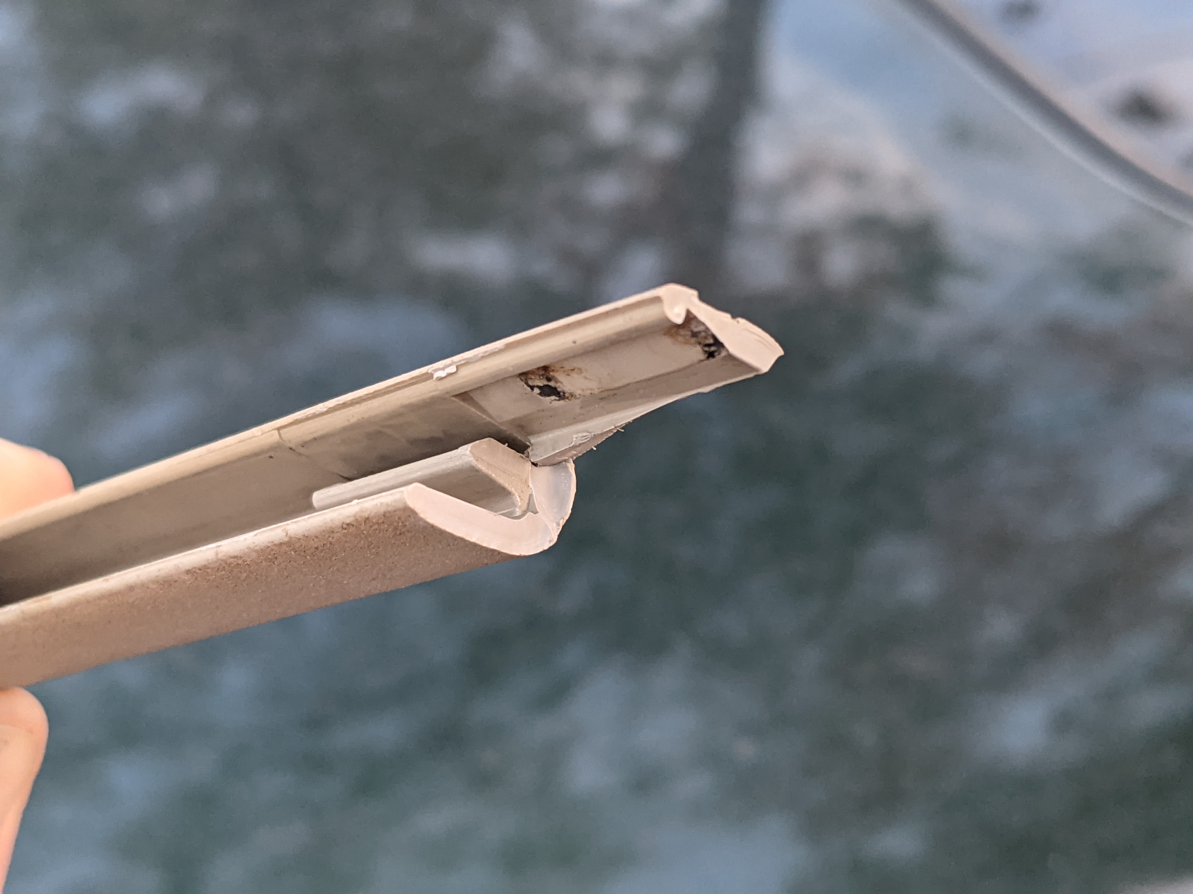

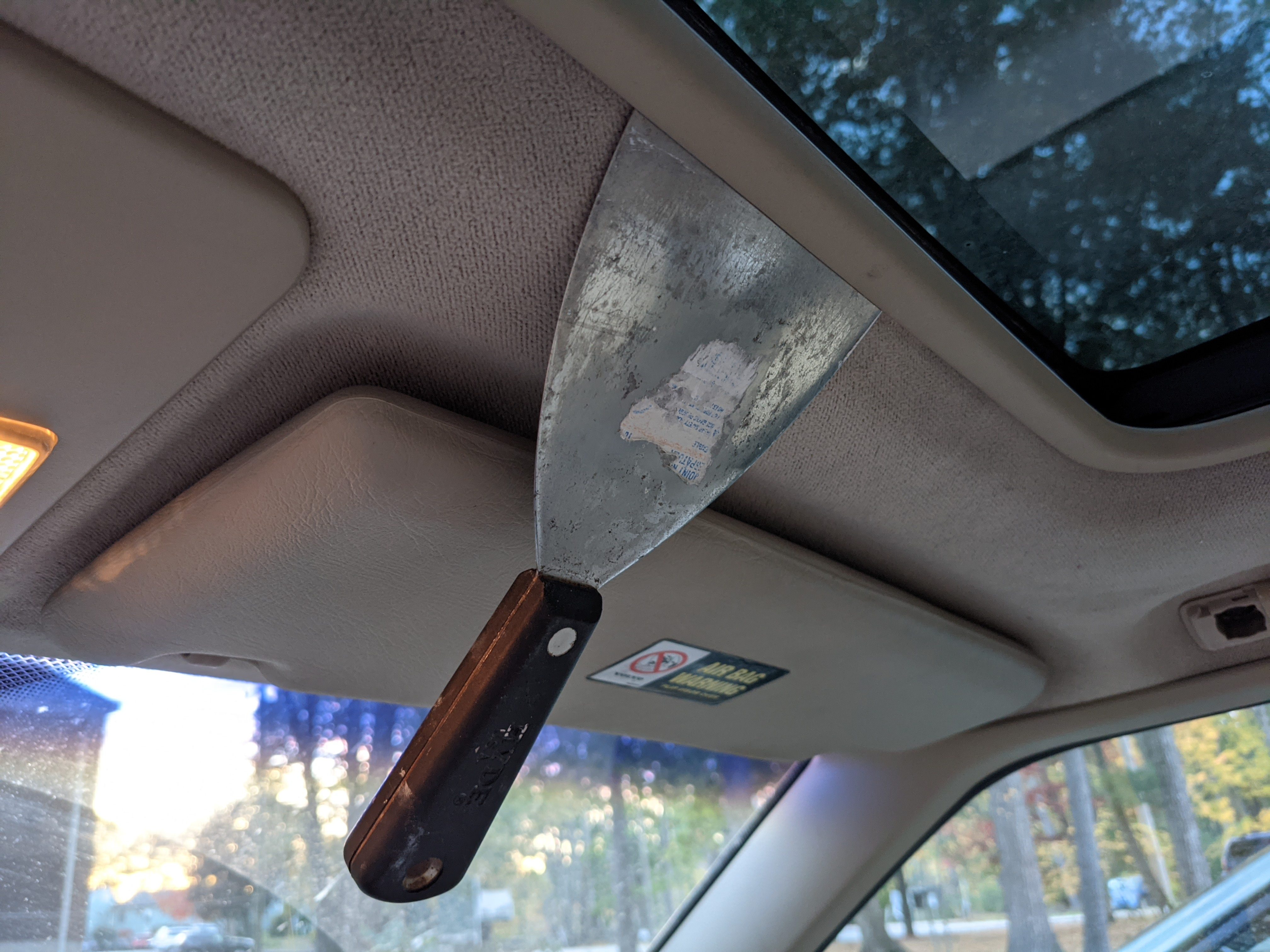

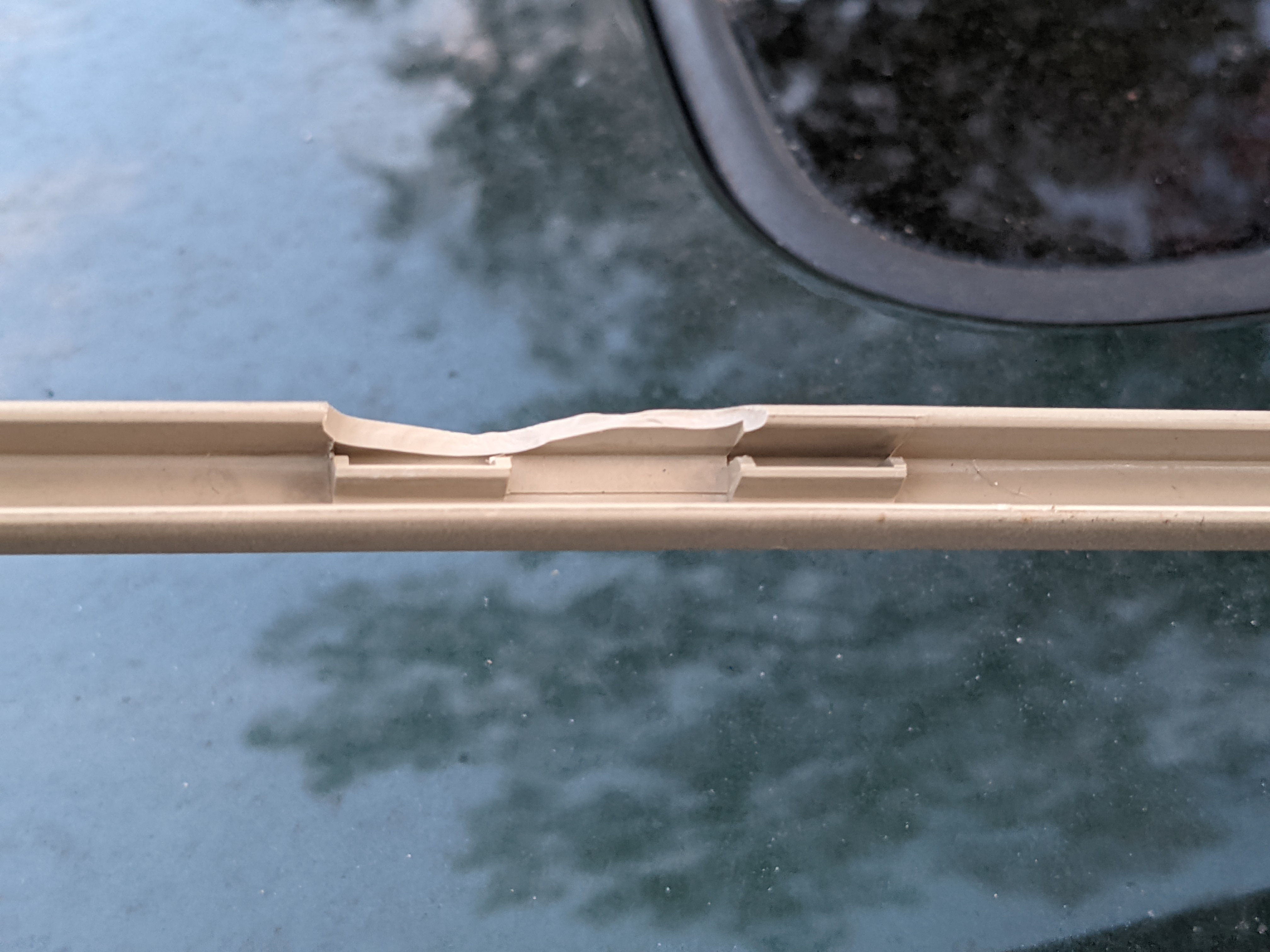

How can the sunroof trim be removed without shattering it?
At a junkyard, I tried removing the sunroof trim but shattered it into ten pieces. I found that the trim has built in clips in the middle and top which hold firmly to protrusions on the upper side of the sheet metal rim. The clips/protrusions are in the left/mid/right of the front and rear and one or two on each side. On the trim, for each clip on its top holding the metal protrusion, there is a center ledge on either side holding the underside of the metal.
The problem is, we only easily have access to the underside the trim where there are no clips. I tried sliding a flat screwdriver into that gap and tapping it with a hammer, but that shattered the clips built into the trim (though not the visible underside). Next, I might try using a spackle knife so tapping it with a hammer spreads that force over a wide area.
The trim clips may be more accessible from above with the sunroof open. From above, you could slide a wide blade like a spackle knife between the sheet metal protrusion and the trim's upper clip. From above, this might be possible with a spackle knife bent at a ~120 degree angle letting you sneak it in the small gap. From inside, you would need a spackle knife carefully bent with two 90 degree angles letting you drop down into that groove from above. To bend the knife, put it in a wide table vice and fold it.

It's nearly impossible to remove the sunroof trim without breaking it. I went with Chuck's method using the rubber edge trim to replace mine and it looks WAY better than the broken trim I had.
- Chuck W
- Posts: 1310
- Joined: 24 December 2014
- Year and Model: 97 854 T5
- Location: Indianapolis, IN
- Has thanked: 96 times
- Been thanked: 333 times
There is evidently a "trick" to removing it. (I think it's a twist-ish action from the top to break it free.) I tried it a couple times in the JY on cars there, and they broke at some point every time.
It's a combination of a pretty secure retention method and degraded plastic that's very brittle to begin with.
