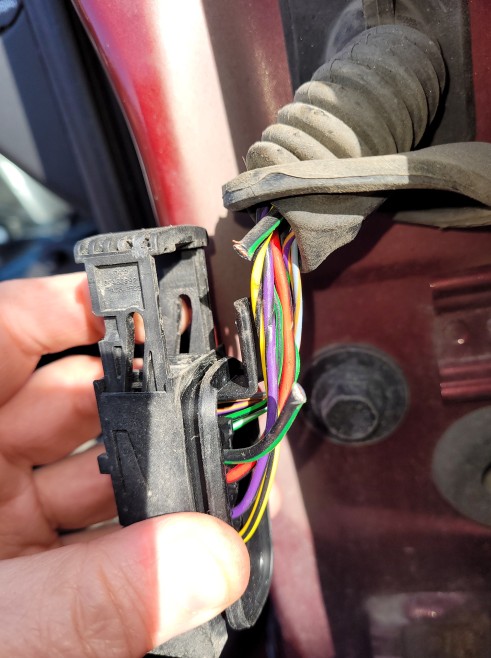

It is very common that the cabels in the rubber hose running between fender and the door, wears and breaks. I had the same symptom when my cable was broken. It have happend to me on both front doors. For information, malfunction of the back door can originate from the front door cable.
How to fix:
- Loosen the door end stop.
- Remove the connector in the door. It has a locknig mechanism that you can see in my picture.
- Remove the vertical screws in the hinges.
- Lift the door off the hinges and put it out of the way.
- Peel off the rubber hose from the connector.
- Repair the cable. You have to add some extra length of cable to get the rapaired parts out of the bending area.
- Put everything back again.
