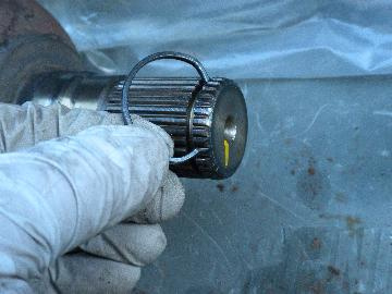

I tried ATF and then later, grease, but was unable to get the driveshaft into the transmission. I noticed that the clip on the aftermarket driveshaft (DSS) was not shaped like the volvo clip:
The volvo clip is circular but sprung open a little.
I put the old volvo clip onto the new driveshaft and I was able to get the driveshaft into the transmission with moderate force.

That clip has to be the exact size and shape of OE to work, that’s where aftermarket stuff often fails.
