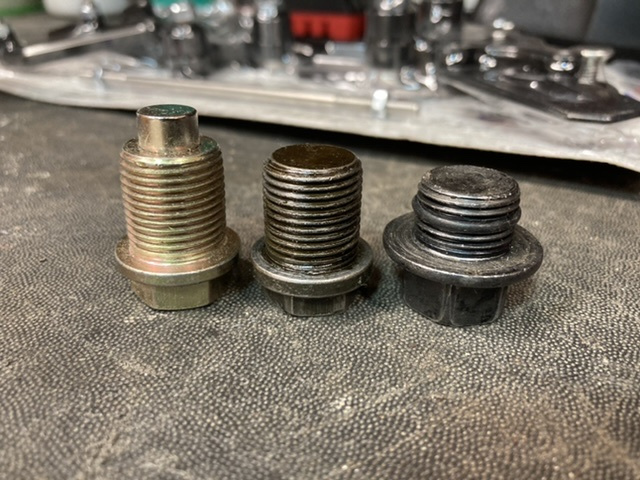

DarylRobert, I was going to also suggest a magnetic drain plug for Chay (& everyone). Pretty inexpensive & I’d say function worth its cost. Never run anything but the full-length drain plug. The junk o-ring plugs on Amazon will make rubbish of your oil pan threads in short order. Previous owners I tell ya . . .

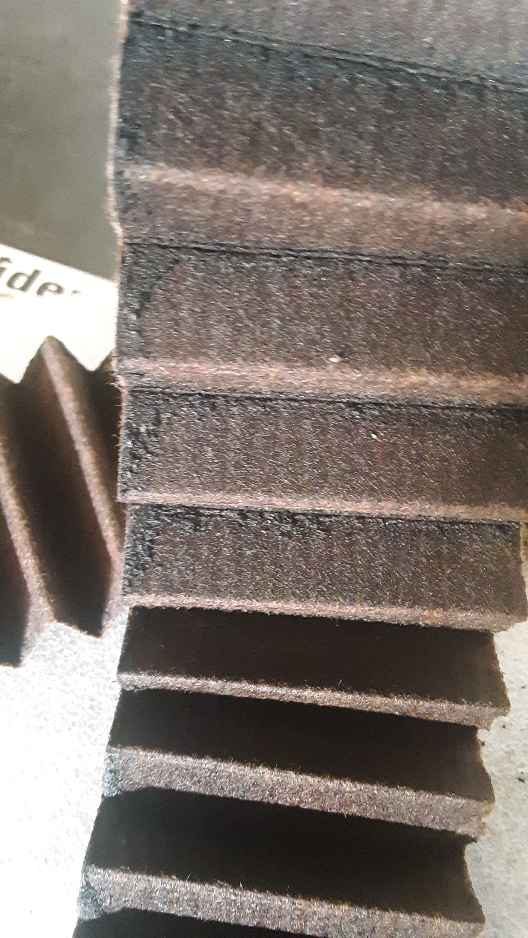

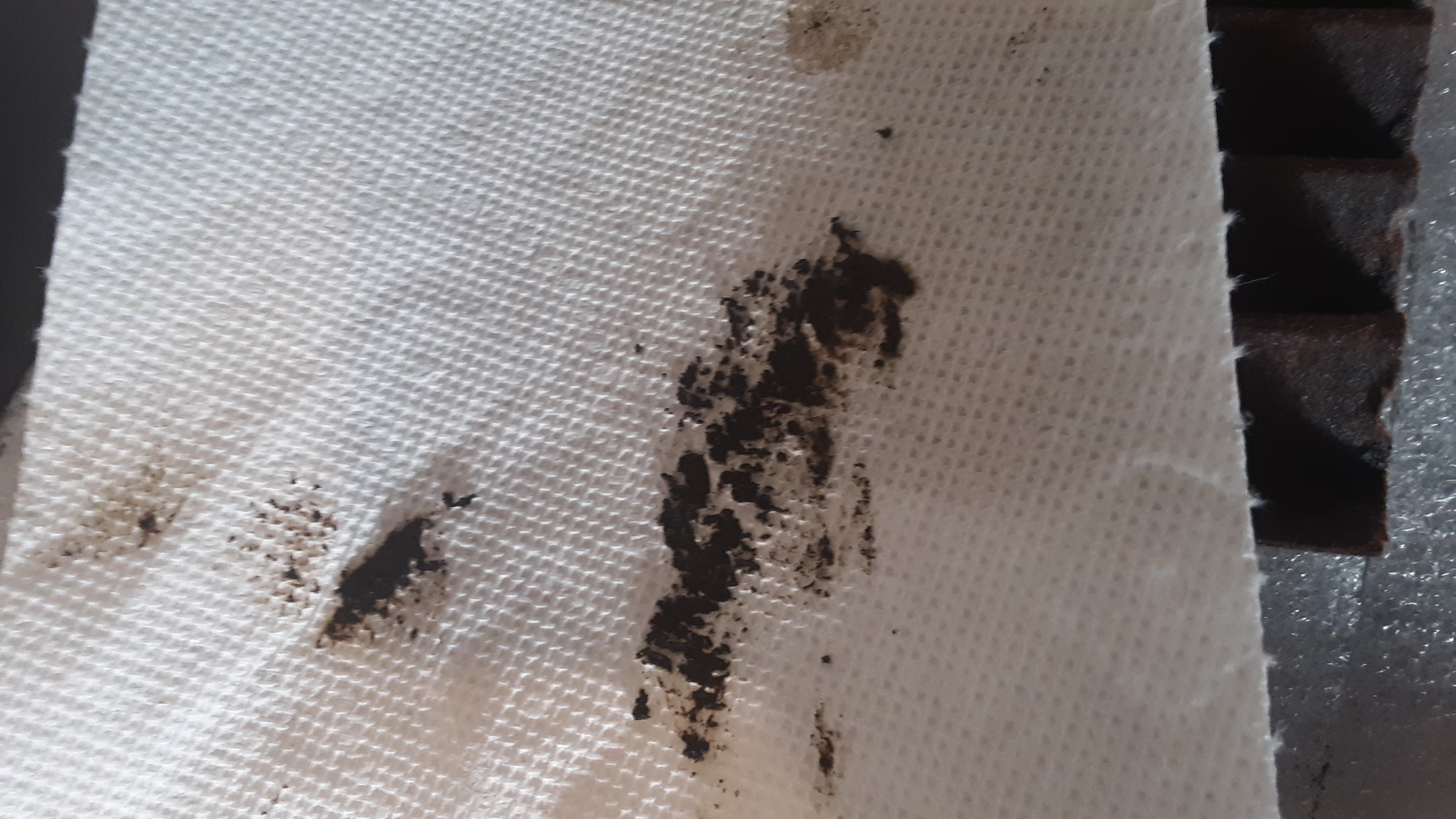

Didn't see any other sludge threads so will pose my question here. 02 S60 2.4T with 182k miles. Last filter change (4700 miles on it) I pulled the media apart and found the attached sludge crystals. Does this seem normal to you that check your filters?
I haven't been pulling mine apart so not sure if this is an increase or normal. Bought the car with 160k and was pretty sludgy under the oil cap which I know isn't uncommon. Not ready to pull the oil pan yet as it seem to be slowly cleaning up with 4-5k oil change intervals. Pondered a quart of Marvel Mystery Oil in next change to slowly help clean further. Was leery of a LiquiMoly Engine Flush to move too much too quick and clog the pickup screen. Always appreciate this groups input!

Shortening the intervals was the plan if I went the MMO route or not. I typically get the 6 qt box of Havoline High Mileage for $17 at Walmart so makes for cheap changes. I was already planning to change as much on oil color as milege to keep flushing it out.
Hoping to avoid the shovel!
