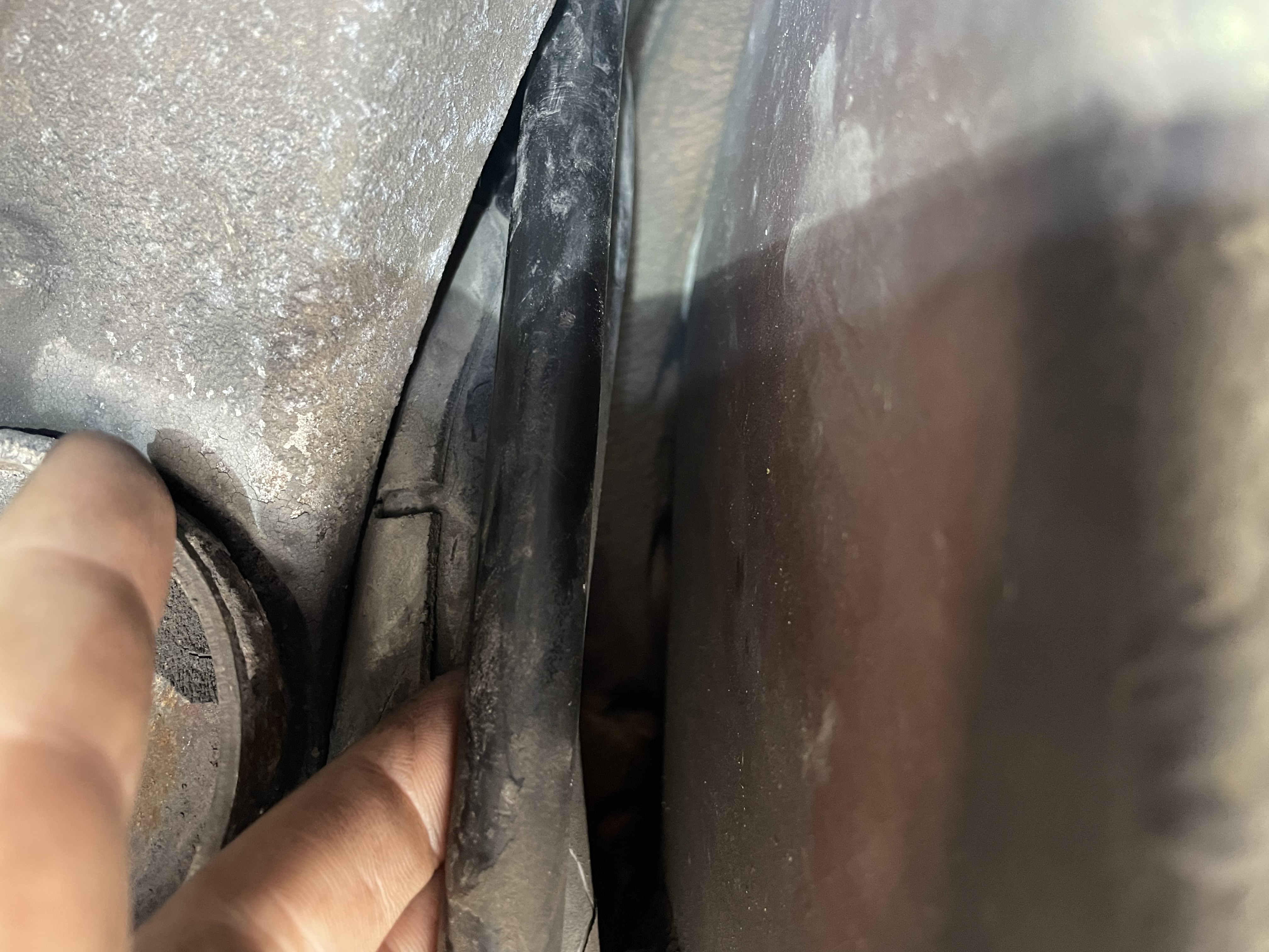

Need some help with the Evap system. Keep getting a P0442, small Evap leak. Checked the j hose and seems decent enough, did fix a small tear in the hose but still coding.
The j hose connects to a powered device that has a junction with another hose exiting. The problem is this hose isn’t connected to anything.
there is also a smaller diameter hard plastic hose that has no connection coming from the fuel filler area.
Are these supposed to be connected? Seems weird that I have 2 hoses not attached and that one is soft vacuum line and the other is hard plastic.
pics attached and thanks in advance for any ]advice!

The canister shutoff valve is open on one end. It allows the evap to vent to air for testing.Vaswamp wrote: 19 Mar 2022, 13:09 Hey folks,
The small line has to be attached up at the fuel filler or you will code for an evap leak
