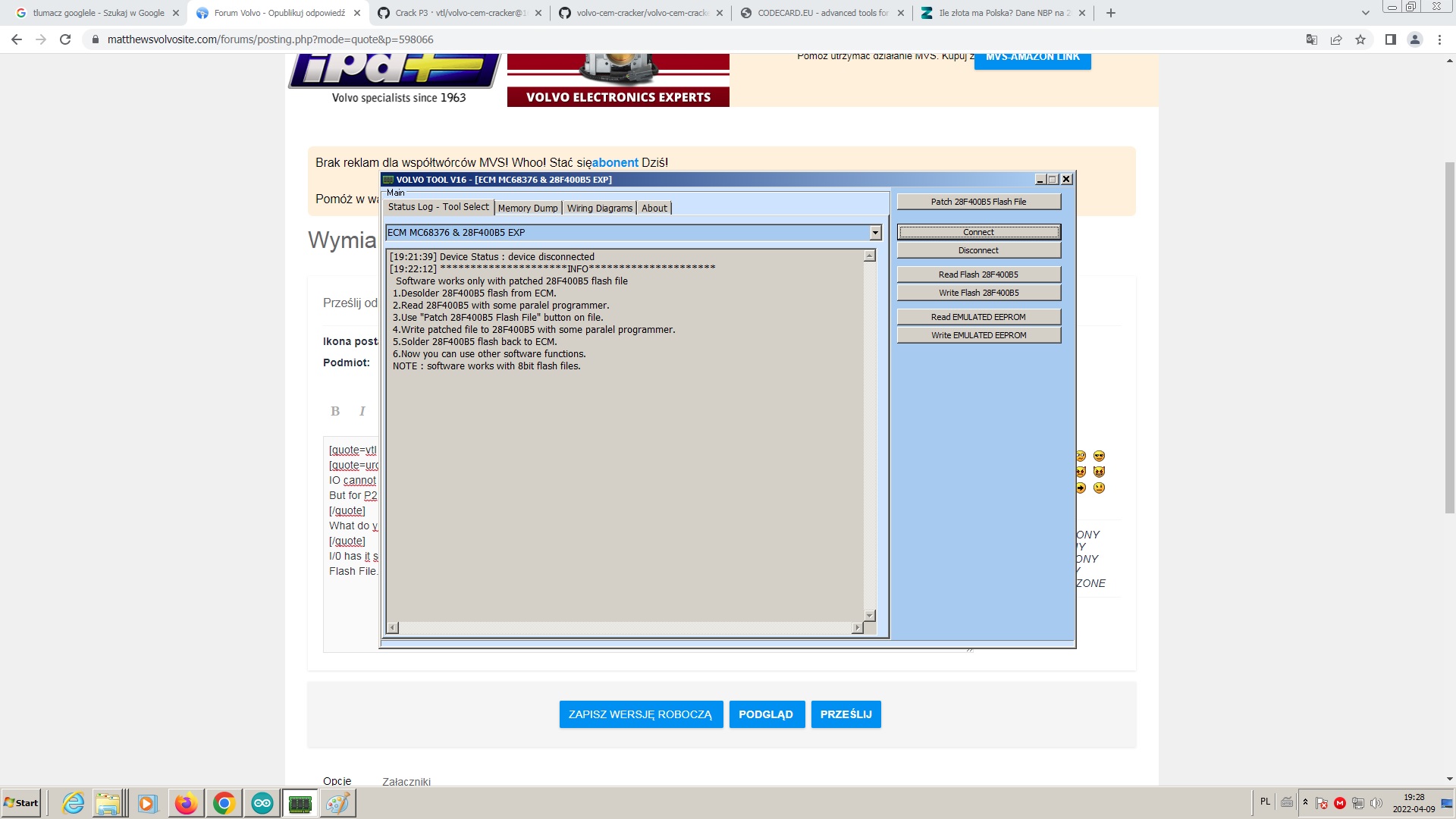

I/0 has it solved the other way around, you need to desolder flash and load the content with changed pin. Patch Button 28F400B5 Flash File.

charlie13 wrote: 09 Apr 2022, 11:32 I/0 has it solved the other way around, you need to desolder flash and load the content with changed pin. Patch Button 28F400B5 Flash File.
What's the chance of bricking the CEM-B doing it this way?

gnalan wrote: 09 Apr 2022, 11:39 What's the chance of bricking the CEM-B doing it this way?
A rule of thumb is to use a fresh flash chip (and tin-lead allow).
Also for older CEMs I think you still can read/write flash unsoldered with BDM programmer.

Read Intel 28F400 memory and send me I can give you the pin you read. You will do path and when the pin input function is added, as in the other modules, you will enter your own pin. This will allow you to embed car conf. I/0 software and using cem changes.
In fact, when you read the desoldered flash, you will also save the changes you want to make

IO terminal has no function to read/enter PIN foe CEM-B. As I wrote before, the flash of 29f400 has to be modified/patched either with io terminal or manually. The "patch" is simple replacing of original pin with FF. The pin is located at address 0x4000 or 0x6000, depending on cem version. To patch 28f400 you have to read&write it either by resoldering it or with bdm programmer without resoldering

Programs for CEM B and P1 SID803. There may be a problem with the antivirus. There is no virus in the files
