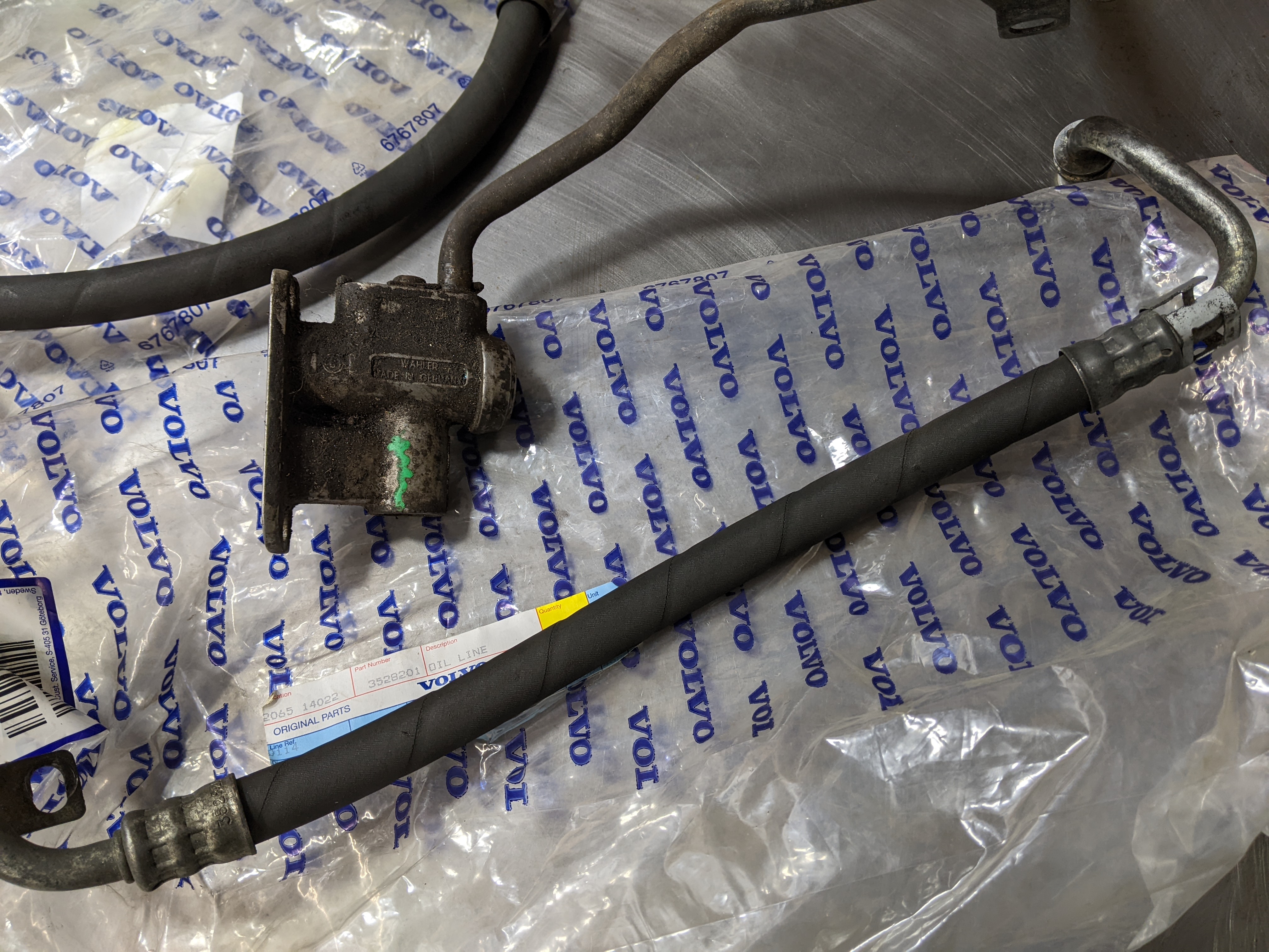

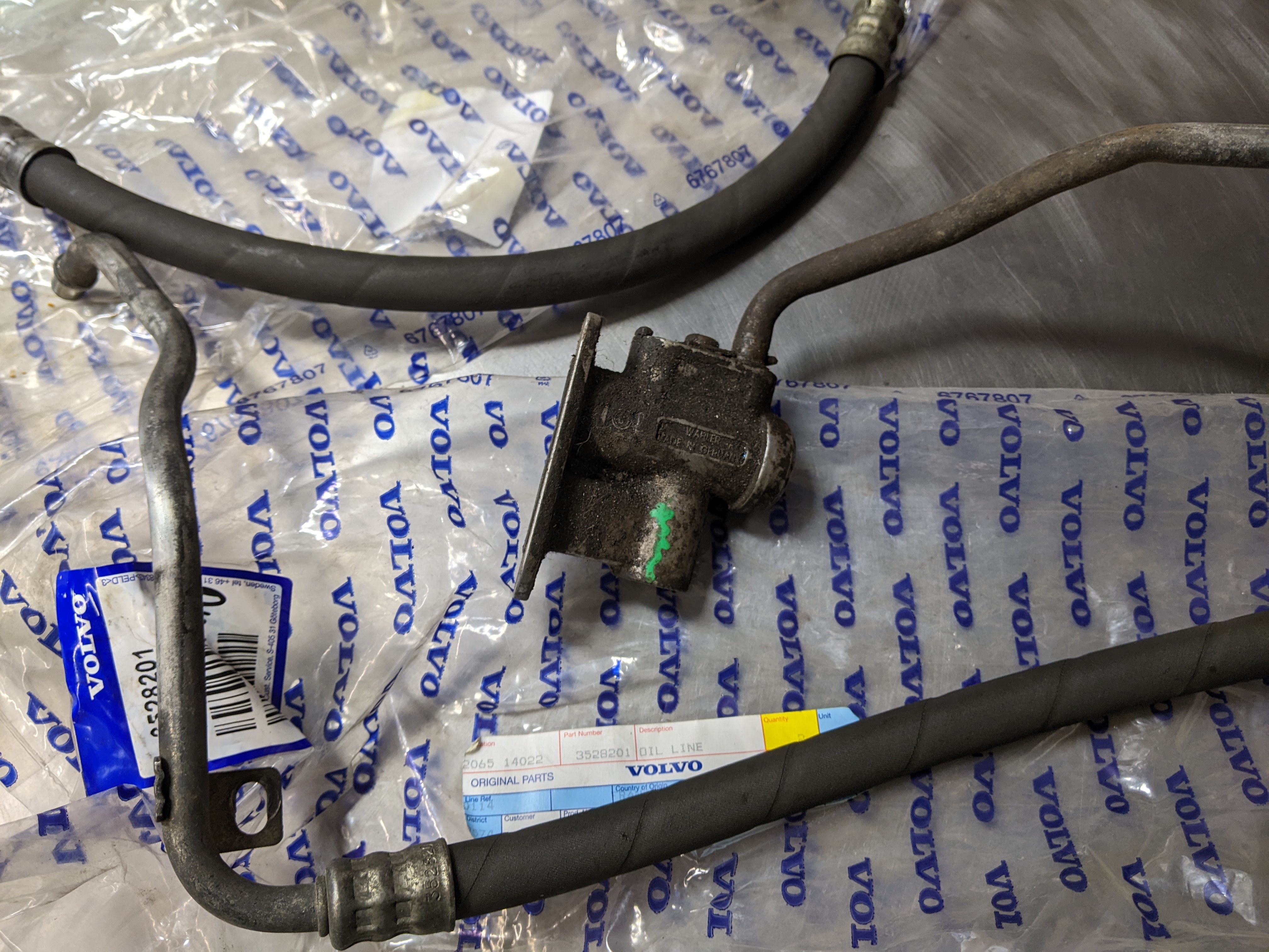

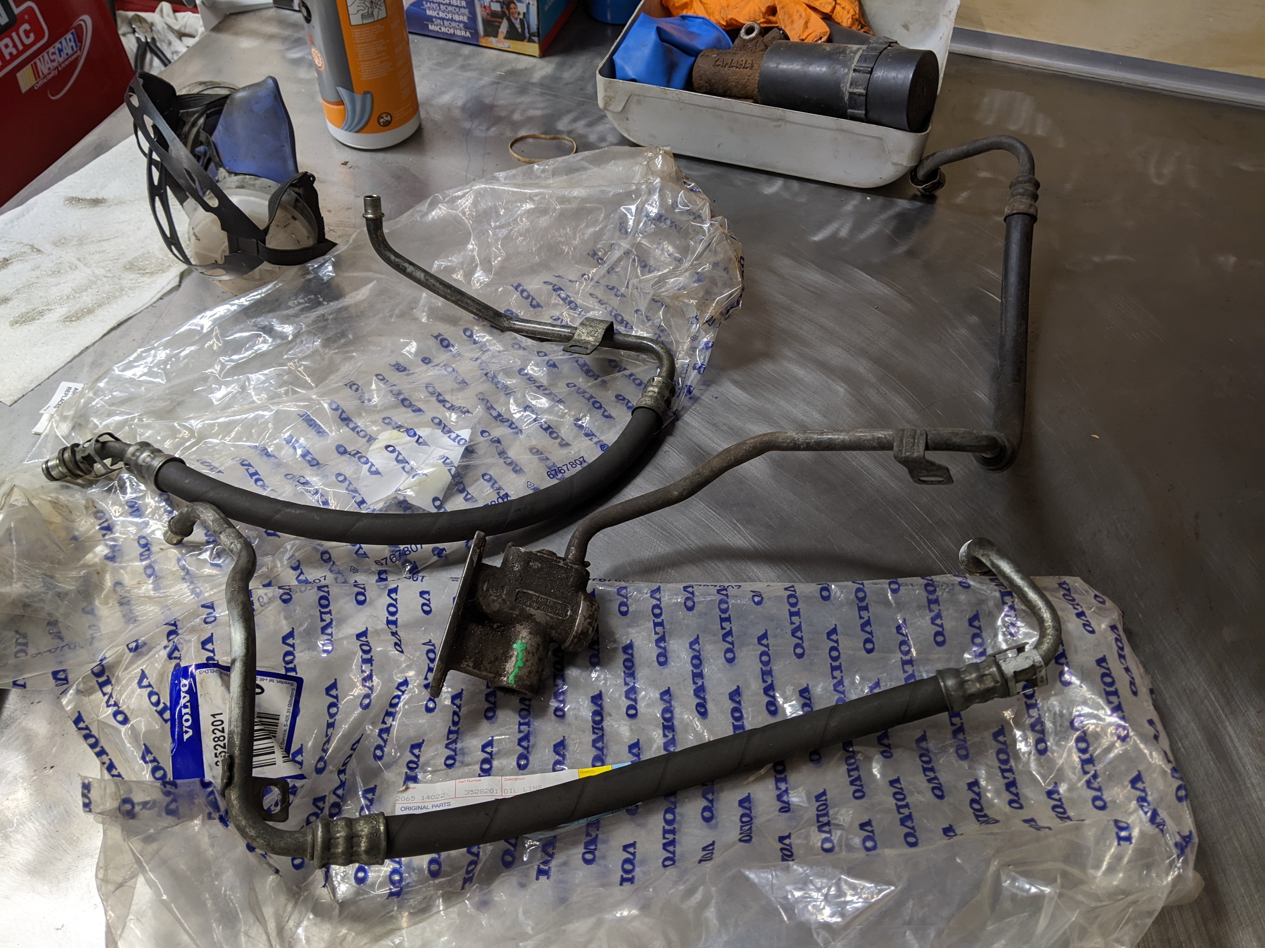

Befarrer I did not forget, just forgot where they were!! :roll: :lol:
Engine cooler lines 98 P80 turbo (1)
Engine cooler lines 98 P80 turbo (2)
Engine cooler lines 98 P80 turbo (3)
Engine cooler lines 98 P80 turbo (4)
Found I actually had 3 lines and a thermostat. I can't vouch for the thermostat and attached pipe as it was given to me but thermostats are NLA so if it is good worth having as a spare.
The other 2 pipes were fine when removed but that was about 5 years ago
Usual 20 year or white line warranty whichever comes first!! :lol: :lol:
If you still want them PM me your address and I'll box them up and ship them to you.
