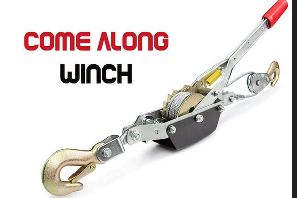

Use a lever operated manual winch to pull the front wheels on the dolly. It does not need to be mounted to the dolly. Attach to the dolly frame with a chain.
Something like this:

You can push them on but I use a $30 harbor freight winchFireFox31 wrote: 16 Apr 2022, 19:20 How do you load a non-running car on a dolly? The only solution I see is a winch and that must be mounted somewhere. That's the problem I need solved.
