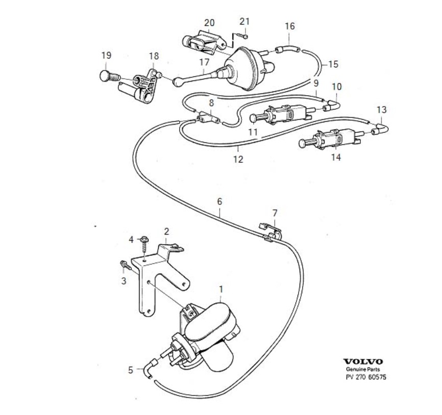

This part came with the manual pedal pack I bought on eBay. I have no idea what it is. My best guess is that it's a cruise control disconnect.
Anybody have any ideas?

I have something like that attached to my brake pedal. I saw it when I was exploring/replacing my brake switch.

It's the cruise control system.
Cruise control.jpg (80.36 KiB) Viewed 497 times

manovlov wrote: 15 Apr 2022, 22:50 It's the cruise control system.
That's what I thought. Thanks for the diagram.

Cruise control -1998
After that, it’s done with electrons

Here, some informations.
Manov
Volvo 850 cruise control.pdf
(435.23 KiB) Downloaded 109 times

Check the condition of the vacuum pump which is under the battery tray. I could not get the cruise to work on an 850 and found the battery acid had dripped down onto it and eaten a hole in it!

scot850 wrote: 20 Apr 2022, 19:46 Check the condition of the vacuum pump which is under the battery tray. I could not get the cruise to work on an 850 and found the battery acid had dripped down onto it and eaten a hole in it!
Under the battery? I thought that was the air injection pump. If not, where is the pump for the air-injection/SAS?

It is down there too.
