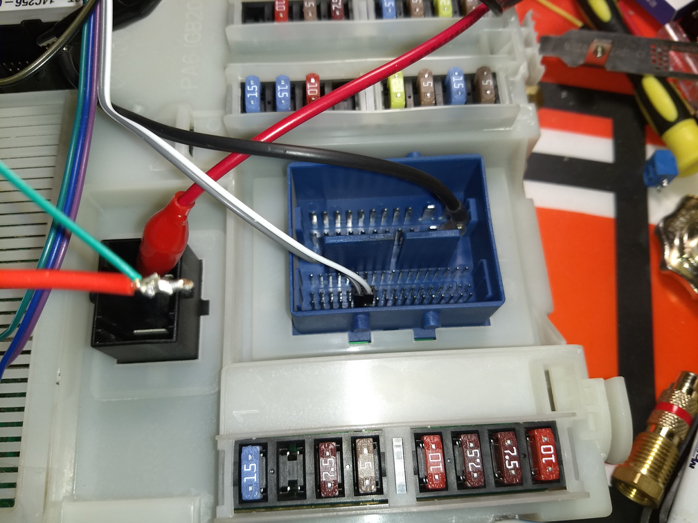

I want to connect to table P3. The can contacts are in the blue plug. I am looking for power and minus. Will anyone help? May be priv

charlie13 wrote: 20 Apr 2022, 09:48 I want to connect to table P3. The can contacts are in the blue plug. I am looking for power and minus. Will anyone help? May be priv
This is what I had.

Post by charlie13 »
vtl wrote: 20 Apr 2022, 12:00
This is what I had.
Thank you. See my attachment. I have a CEM M32C + 95320. Your description is R5F64524 / R5F64525

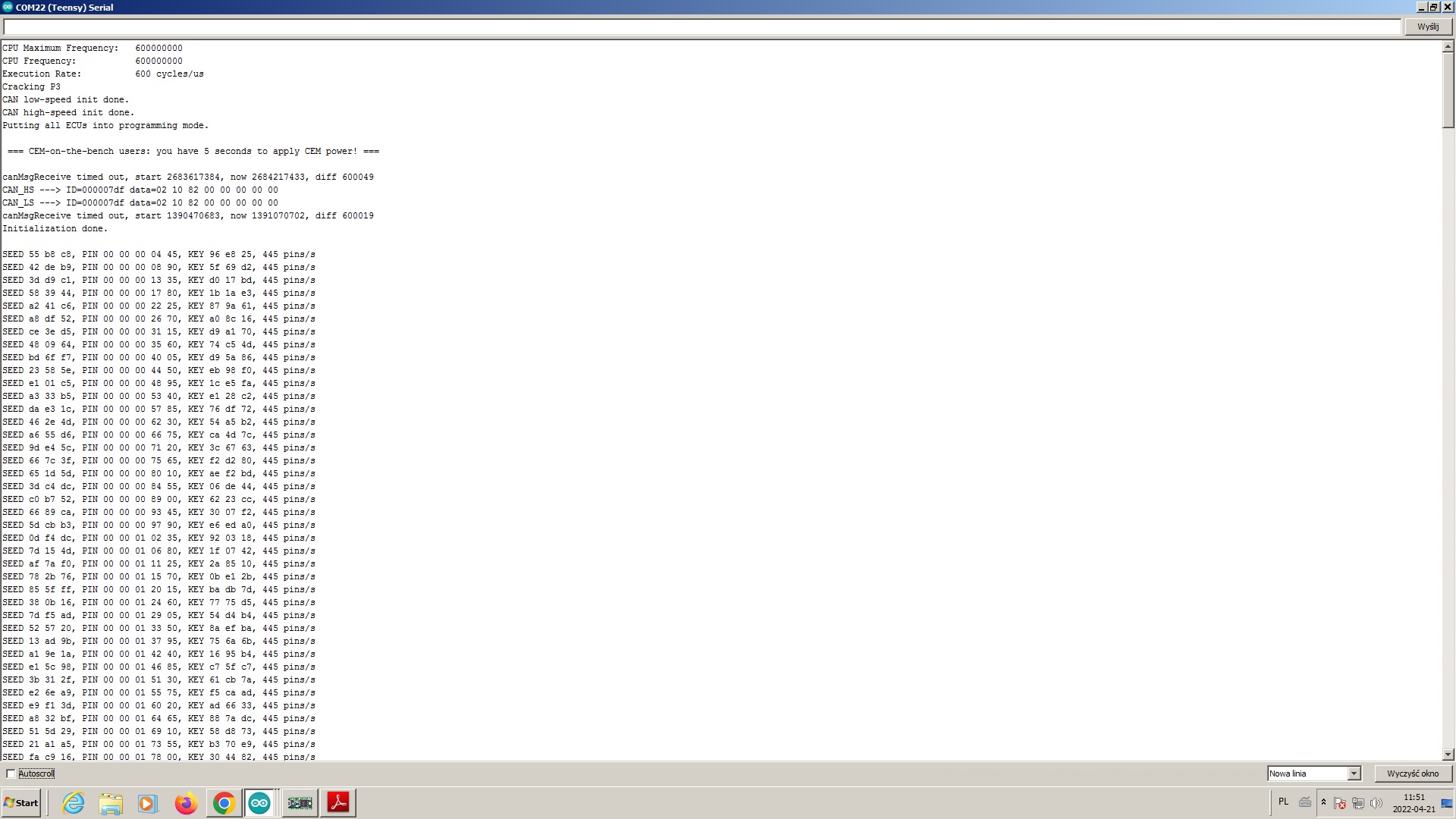

vtl wrote: 13 Apr 2022, 14:46 Let us know how it goes.
Cracking about 2h now.
SEED 90 0f f5, PIN 00 01 11 45 47, KEY 42 1e 44, 235 pins/s
If there were ways to accelerate the speed... SMOK.pl promises 0...10h to crack. Some tools claims 4-6h. They must be using different approach. Or better hardware maybe?

alevol wrote: 21 Apr 2022, 05:58
Still counts. I have a UHDS and an I / 0 terminal. UHDS counts slowly, I / 0 terminal does all CEM P1, P2, P3, SPA. That's why I / 0 is the better tool for me.
Speed depends on which P3 CEM they are referring to. 2008-2010 is slowest. And then 2010-2014. Fastest is 2014-2017.
