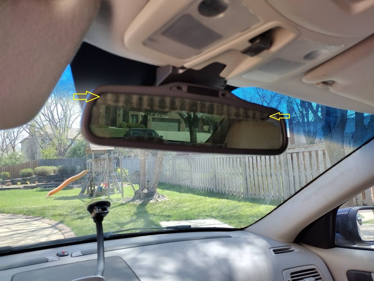

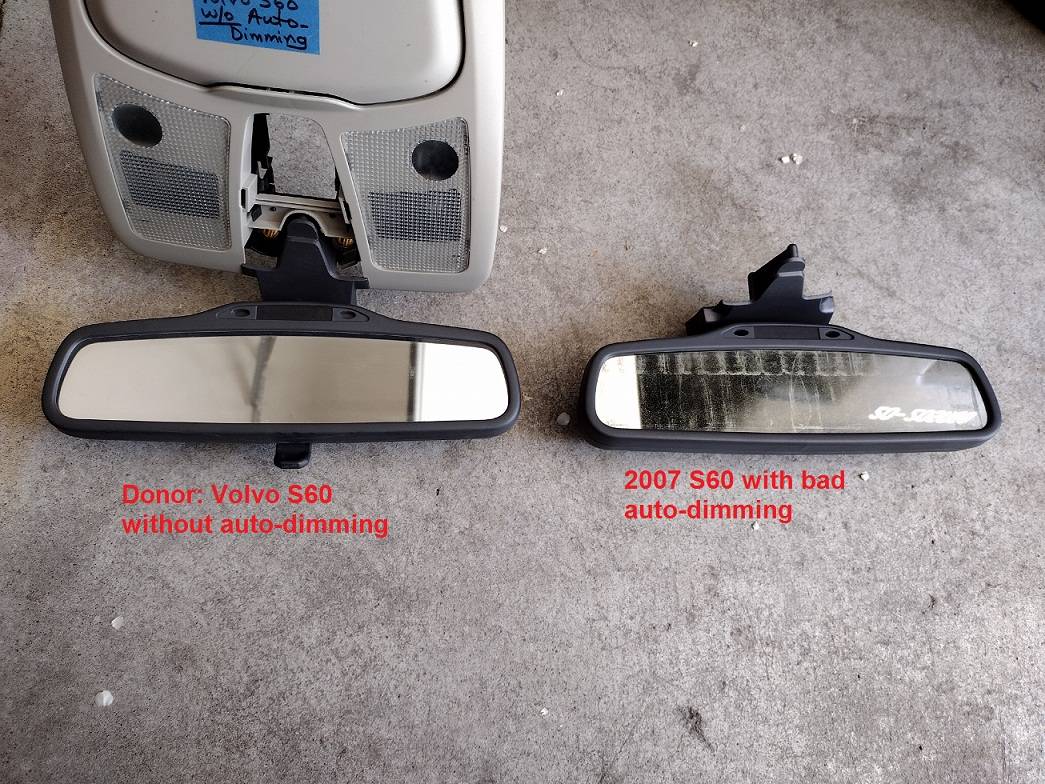

UPDATE for my 2007 S60 with 119K miles...
The auto-dim mirror has been a problem for the last few years.
Finally had time to do it.
Budget ~2-3h so you can go slow and be safe.
1. The Compass feature: it was not accurate to start with...when going S, it always says SW.

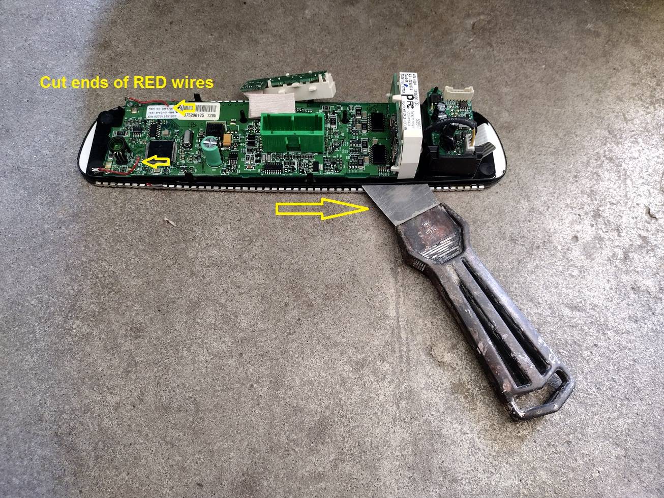

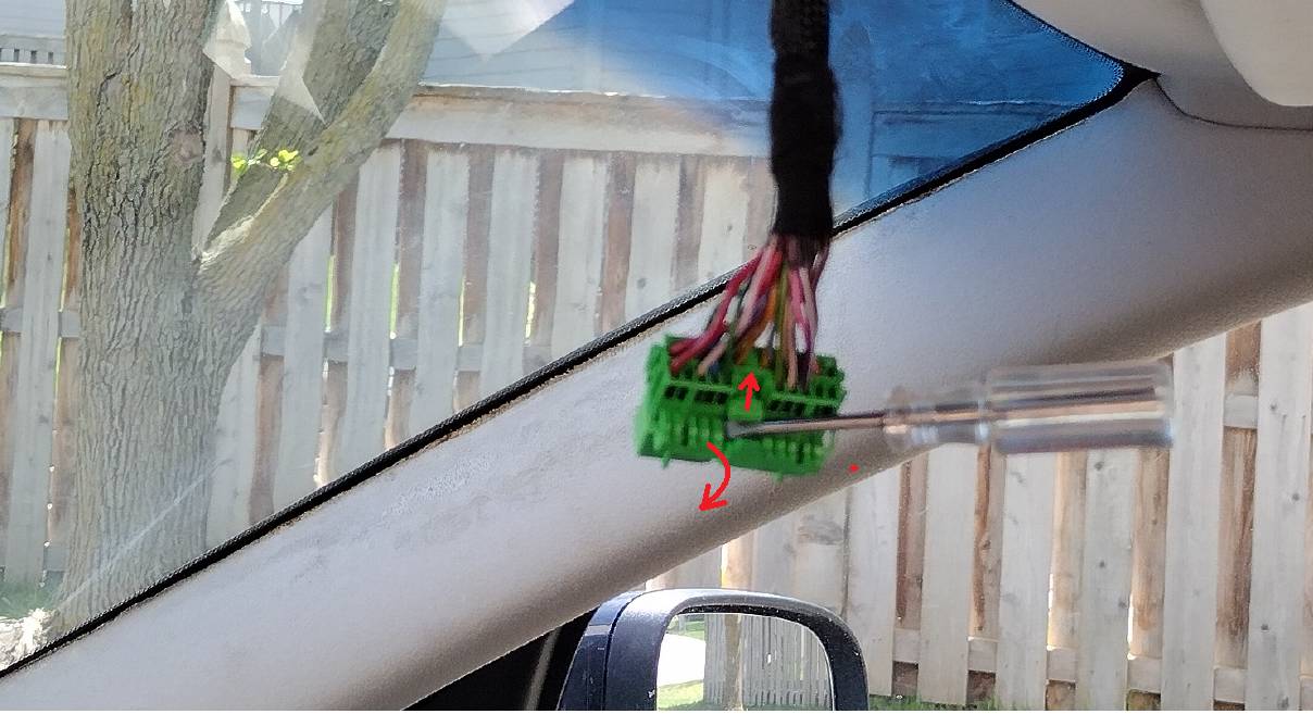

4. The GREEN connector: once you fold down the cover, use a small screwdriver and push the
small tab toward the connector to disconnect it. This trick is not mentioned in many youtube videos.
5. The putty knife is very useful to:
- Separate the 2 halves
- Separate the mirror from the circuitboard.
A hair dryer is useful to soften the adhesive.
6. Use 2-sided tape to glue the new mirror to the circuit board.

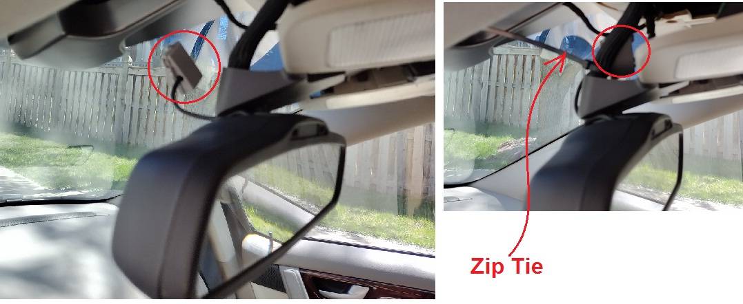

7. The little screen on the top that says "seatbelt" etc. Don't lose it.
8. The little square thingy...I don't know what it is but transfer it to the new housing and used a
zip tie as shown. Basically I transferred anything that has to do with the electronics over, even
the little thing that functions as a compass (that shows "N, S, E, W").
9. The thin black plastic "plate" that holds the compass display: remove it and discard it.

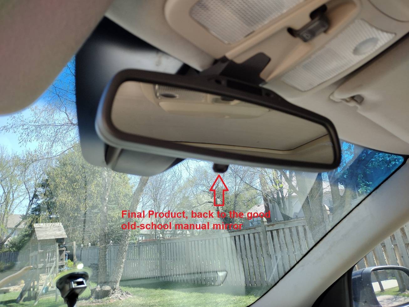

All in all, it is a good thing to do, now I can see the cars behind me well lol...
PS: Let's say you only have the glass, you can still use your existing housing.
Install the new glass in the existing housing.
Every time you need to dim, just move the whole housing up and down, it is
not as "elegant" as the housing with flip thingy...
