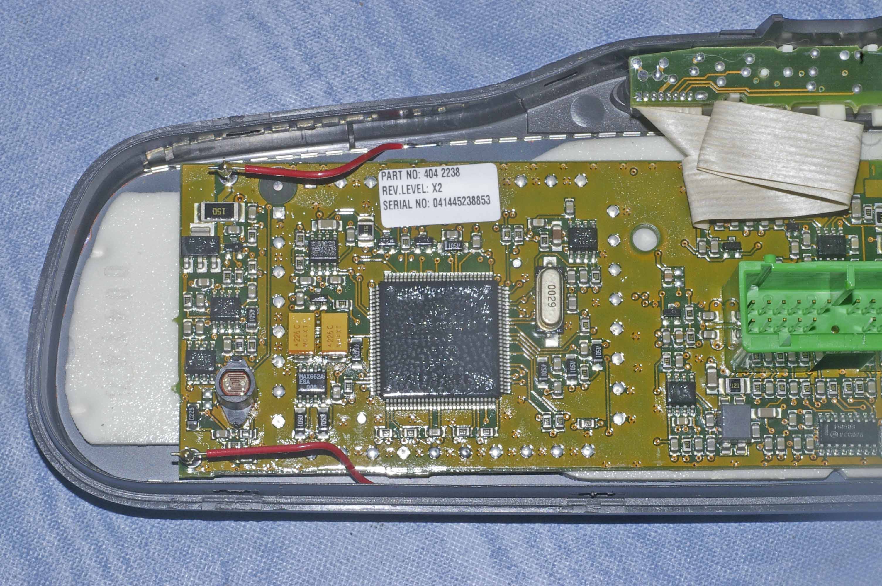

I did the auto dim to manual dim swap many years ago with no error code problems. My car is a 2001 Volvo V70 T5 and I'm in total agreement with Krons to go ahead and do this type of swap. The best part of the manual dim mirror is that the dimming with the manual dim mirror is darker and that was very important to me because the autodim mirror was never dark enough for me.
The only difference between manual dim mirror and autodim mirror is the two wires hookup to the autodim mirror so you transfer the autodim electronics board but there's no connecting the two wires to the manual dim mirror. I did add a high resistance resistor between the two connections but I don't know if this is necessary.
here's a photo of the autodim electronics board with the two wire connections to the autodim mirror, after transferring this board to a manual dim mirror there's no longer a two wire connections to the mirror
