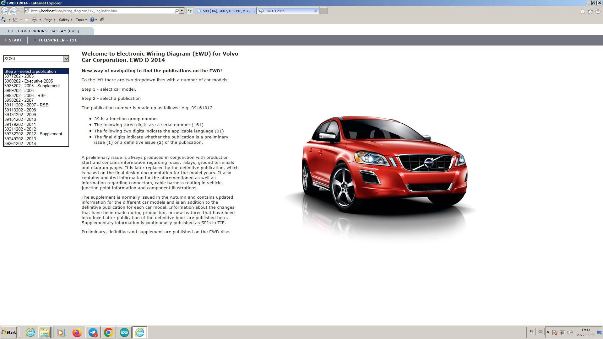

Anyone has a description of how to connect cem P2b on the table?

Post by vtl »
All CEM pinouts can be found in VIDA. For the brick-shaped CEM you need a K-Line addition to the cracker. I think someone reported he was able to talk to CEM using non-OBD CAN pins. They are open at all times.

vtl wrote: 06 May 2022, 09:07 All CEM pinouts can be found in VIDA. For the brick-shaped CEM you need a K-Line addition to the cracker. I think someone reported he was able to talk to CEM using non-OBD CAN pins. They are open at all times.
Sorry. But I found nothing in vida EWD. Nobody has written anything on the forum whether it works, the K lines can be given from vida

Post by vtl »
VIDA, not EWD

Post by charlie13 »
Function group ?
