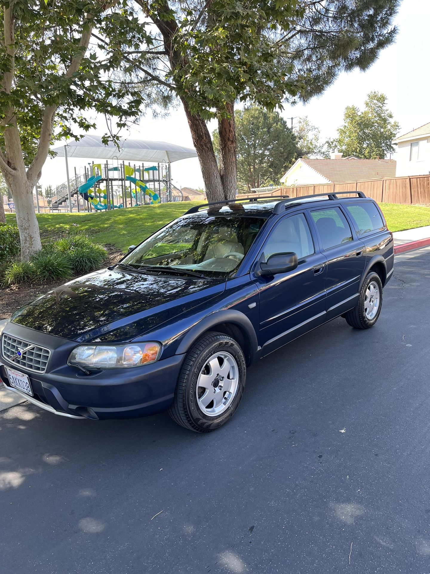

Yeah, so true, good cars are snatched quickly, probably a lot of times by flippers too.
A few days ago saw a 100k miles xc70 for $3500, sold next day.
https://offerup.com/item/detail/1408031 ... y+&cid=5.1
Then the same car is put up for sale for $8500, pretty much immediately,
https://offerup.com/item/detail/1408974788?cid=5.1
