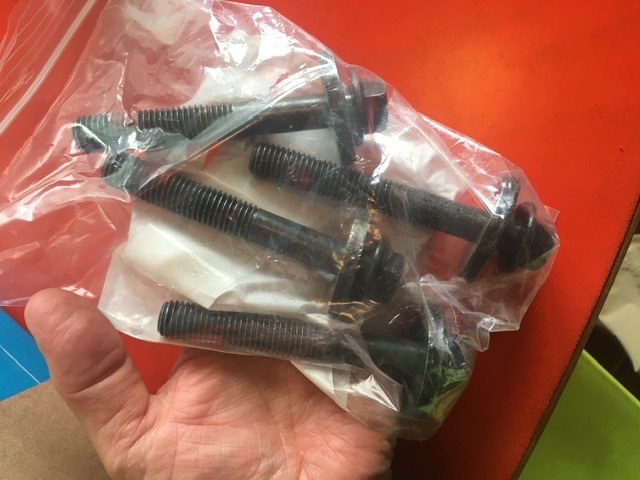

It’s like Pavlov’s dog - you see that blue tape And say Ooo, car parts!
Whoa, these subframe bolts are big!
