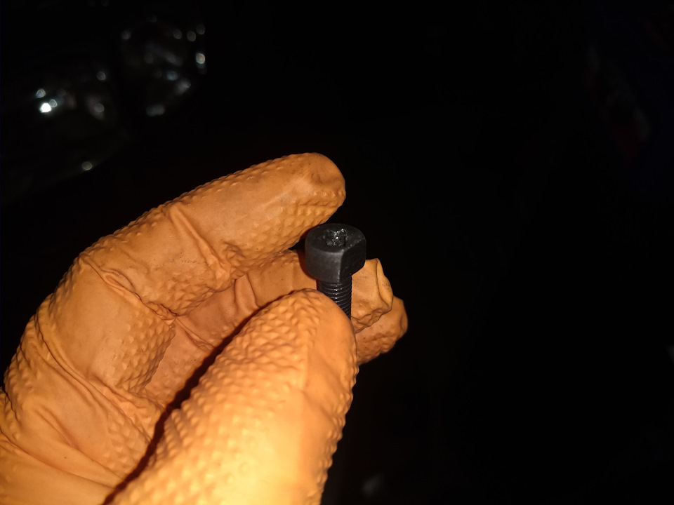

Forgot to mention, there's one "difficult" bolt, right behind the crankshaft speed sensor:
Either install it before mating transmission to engine, or modify the bolt :)
