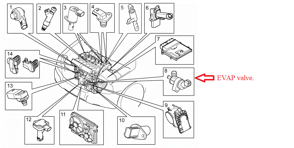

The purge valve is just above the throttle valve
Take a look at the pictures in this post
https://www.freel2.com/forum/topic32245.html
Here is a picture from that link showing the purge valve
Note: I own two 3.2s and I have a purge valve on the shelf and I plan to replace it on my 3.2 that was running rough on a restart recently.
The purge line from the charcoal canister has to be removed to remove the manifold. If that line is broken of the O-rings are leaking you can get the code that you have. Also the purge pump has a air filter that can get clogged and cause problems.
The hose from the purge valve (shown in the picture) will cause a vacuum leak but not a vapor recovery leak. So if that hose is broken you should replace it but don't expect it to fix your check engine light.
Good luck
Paul

awesome details, thank you. on my XC90 it appears the EVAP purge valve is not down by the throttle body, but rather hanging off a factory tab behind the upper radiator (at least I think that is it). I am going to tackle this, the thermostat and a faulty oil cooler coolant hose this weekend...all without removing the intake. wish me luck!

The purge valve should be in the location that I showed above.
There are some minor difference in a XC90 3.2 and a S80 3.2 but the purge valve isn't one of those differences.
Take a picture of the part that you are looking at and post it here
Thanks
Paul
Thanks
Paul

Did the job today and the code cleared. real PITA to get the intake pipe off the throttle body and replace the vacuum hose from the evap valve to the backside of the throttle, but got it done. thanks for the help!!
the old one was indeed gunked up and dead.
