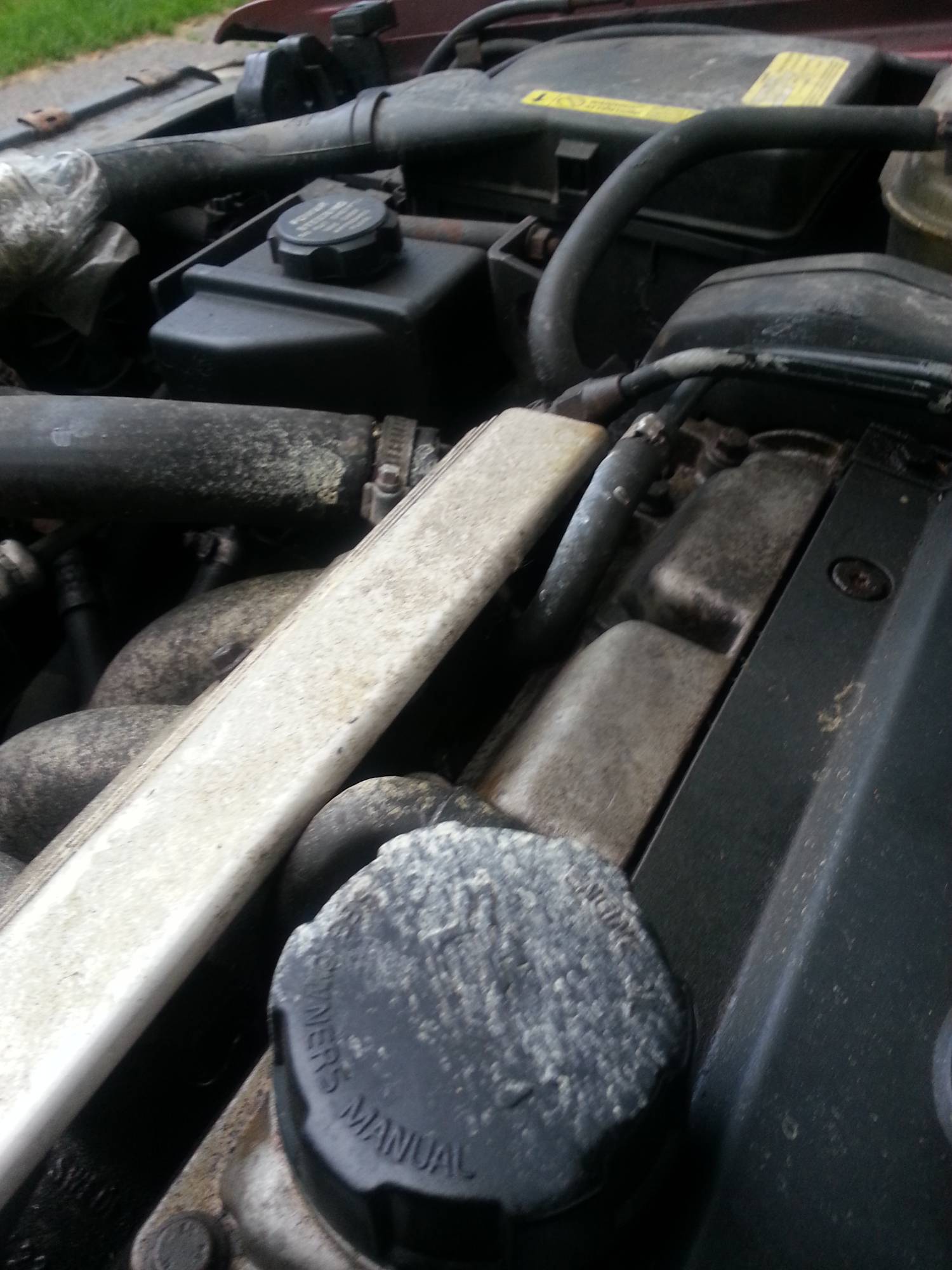

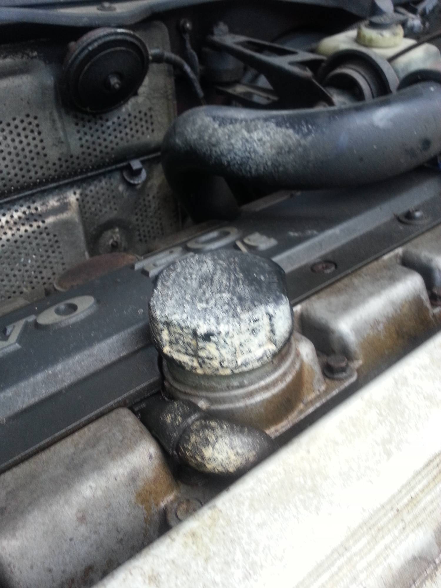

I have been having problems with my engine. What I imagine is a tell-tale sign of a coolant leak (and perhaps a blown head gasket?), there is yellow powder residue (as seen in the attached pictures below) that has sprayed onto the oil cap and the some of the nearby pipes and hoses. This residue is also found on the underside of spoiler attached to the trunk which I assume is resulting from burnt coolant being exhausted out the tail pipe.
I have been having smoke coming out of the tail pipe and posted last month that the smoke was blue and that oil was burning and was advised of what could be causing that to happen. At that time there was no sign of a the yellow powder residue as there is now. What I did notice was that reservoir was not full so I added an entire standard container of coolant to the reservoir. Somehow a small socket driver (the size of a small screwdriver) fell into the reservoir and was only noticed and extracted from the reservoir yesterday following my discovering the yellow residue on the oil cap. I can imagine the would have obstructed the free flow of coolant out the bottom of the reservoir to some extent but not sure if this would eventually lead to the residue which I observed for the first time only yesterday (I have been adding oil to compensate for the burning oil for the past month and almost on a daily basis inspecting the engine as I attempted to figure out what was causing the burning oil). This was before there was any smoke whatsoever being exhausted through the tail pipe. My car had broken down and would not fire and my mechanic had found that the rotor had disintegrated and he replaced the rotor and cap. He then told me over the phone that the car was smoking blue smoke.
Now I can only assume that not only is oil burning and being exhausted out the tail pipe but it is now combined with burnt coolant being exhausted out the tail pipe as well.
Would like to know what is the likely problem causing this residue and what can be done to fix it and eliminate the smoking.

Are you sure you did not drive through something that was thrown up under the car? I am struggling to think how water residue got onto the oil filler cap as well as the turbo intercooler pipe, and the top radiator hose.
Have to say that top radiator hose looks crusty!
Are you seeing any residue out of the top of the coolant header tank? It is usually the first place for coolant to leak if the system is pressurising or as you said it burns out through the muffler system. What colour is your cars tailpipe? Black or whitish gray?
You can get simple kits that have a chemical in them that you remove the header tank cap, and sit in there with the engine running. The fluid changes colour if exhaust gases are present in the coolant (head gasket leaking in other words).
Have you checked the turbo coolant lines at the back of the engine? Are they swollen or split? Are you losing a lot of coolant?
If the turbo lines are leaking it would pull coolant under the car and throw it up the rear of the car.

Thanks Neil! Turns out the top radiator has a fresh tear in it at the clamp ... an engine mount needs to be replaced and that has put a strain on that hose.
Doesn't explain yellow residue on the rear spoiler but you have provided a possible explanation. I will check the turbo lines. The dip stick does not show any coolant contamination so that's a relief.
