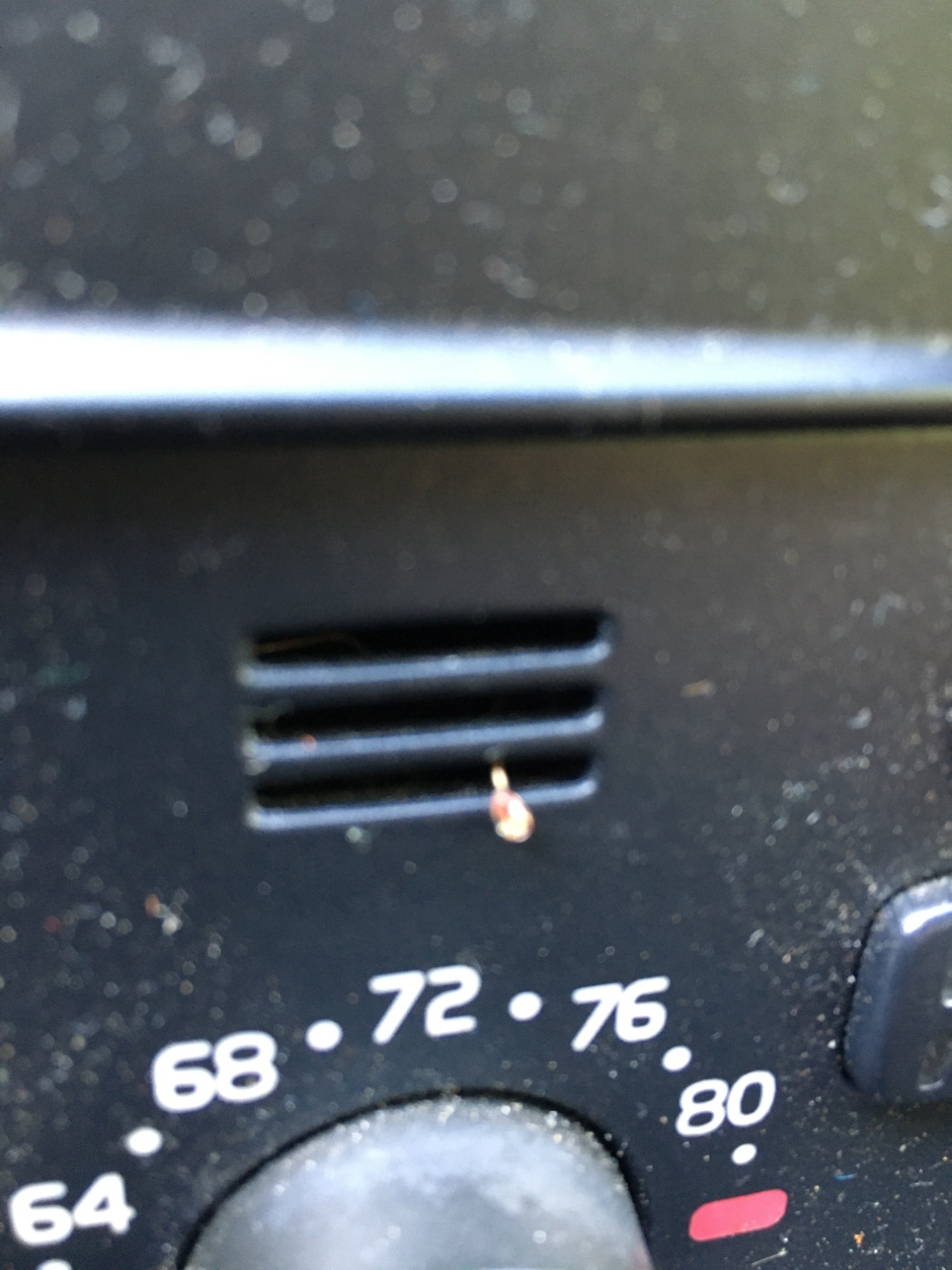

What I did notice is that there was a little tiny bare wire sticking out of that little grill that I’m assuming is where the A/C system gets it’s cabin temp info. (No, there is no lint in it). But what is on the end of the bare copper colored wire is what looks like a tiny crystal or something. The picture is blurry but you can see it sticking out.
What is that? What I’d really like to know is what that sensor inside there behind that grill actually looks like.

That's the thermistor for the CCM sticking out the opening. It is a variable resistance temperature sensor that provides the cabin temperature feedback to the CCM. With it pulled out like that I would imagine one of the two leads is broken and the sensor is not providing the temp feedback needed. Does the compressor cycle off after running for a short time? The thermistor is pulled out because it sits just behind the opening slots and probably got pulled out when someone was trying to clean out the opening slots.SteveV70 wrote: 20 Jul 2022, 07:51 Could someone give me the low down on how the A/C is controlled?

At 25C the thermistor resistance is ~10K ohms and goes down from there as the temperature rises, if broken there would be open or infinite resistance so the CCM may react like the temperature is cold and not run the compressor or if it does run it would only cycle the compressor on for a short time.
I'm attaching some photos and notes when I replaced the thermistor in my car and I've included a part number of the thermistor I used. The only thing I'd add to the notes is to not even try to get the original thermistor leads out of the tiny holes in the circuit board, just cut out the old thermistor and leave the leads in the circuit and just solder the new thermistor to those leads. The holes are so small in the circuit board you can't remove all the solder and you can't get the new leads back into the holes so it's best just to solder the new thermistor to the existing leads. Don't unplug the CCM unless the battery has been disconnected first.
It's difficult but can you look through the opening and see if one of leads is broken?

Well guys,…I’ll tell ya what,…that’s awesome advice.
I’m pretty sure that lead is broken because it’s a single wire tipped with that crystal.
When I get to it tomorrow I’ll report back.

Dogs, dog hair = broken thermistor. I have two German Shepherds that shed vast amounts of hair and the horizontal slots in the CCM front opening suck dog hair in too easily, which stops the fan and why I added a screen over the opening. The previous owner of your car was likely trying to clean dog hair out of the CCM opening and caught the thermistor and broke the lead wire.SteveV70 wrote: 20 Jul 2022, 13:56 Well guys,…I’ll tell ya what,…that’s awesome advice.

I wanted to follow up.
I finally got the time to get to the thermistor in the Volvo. Taking the dash apart to get to the CCM is a little different on the later series two cars, mine is an 07. But there was a video on that and it’s actually even easier. And since mine is a five speed manual there was more room with the shifter in fourth. I didn’t even have to pull the knob.
I was able to actually desolder the old thermistor and the one I bought went right into the old holes in the small mounting board no problem. The new one (from Mouser using the part number you gave me,..thanks!) had longer leads and a short stripped portion at the ends that was bare. I wasn’t sure if the length of the leads mattered…I know it matters on thermocouples so I didn’t want to shorten them and strip more wire bare. So I just used it as is and made the excess insulated wire leads into a soft loop and got the tip of the thermistor centered in it’s mounting tunnel.
Got it all back together and this thing throws serious ice cubes now,…both sides of the vents, all good. WOW.
