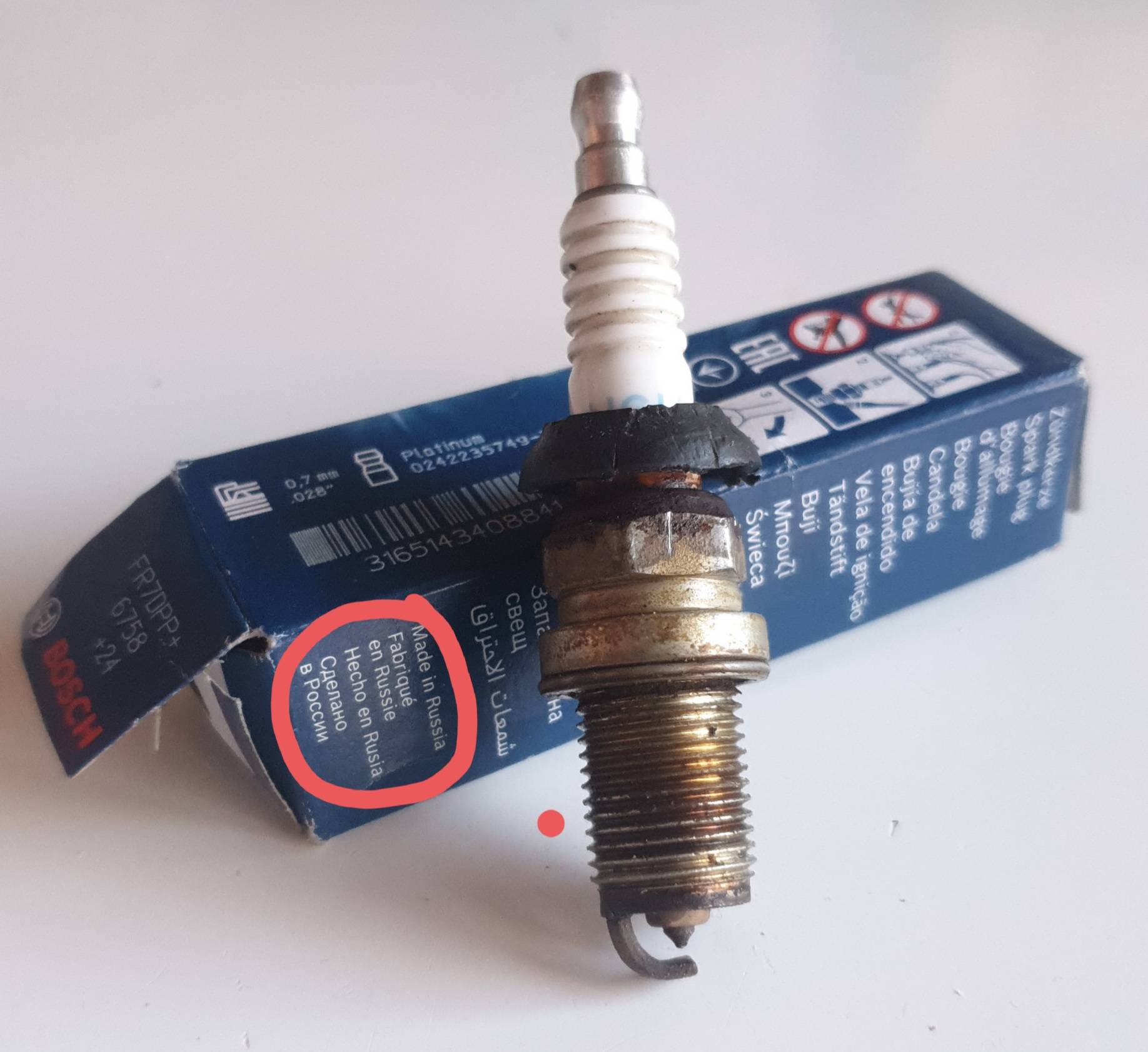

Thanks - this was it! The rubber / plastic boot had got really hard and was stuck on very well. That tricked me into thinking it was part of the spark plug. But eventually i managed to work it loose and get it out. You'll see in this photo of the old plug that you could hardly design a better "cover" for the flats.
I've now got 5 new Bosch plugs in. I wonder if Bosch has found a new spark plug factory yet...
