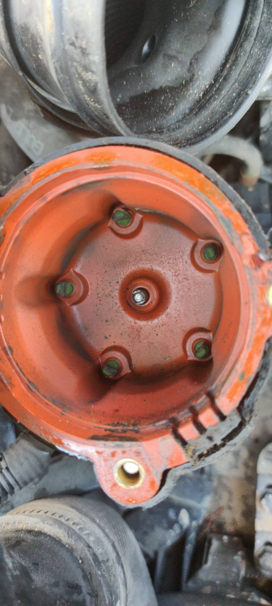

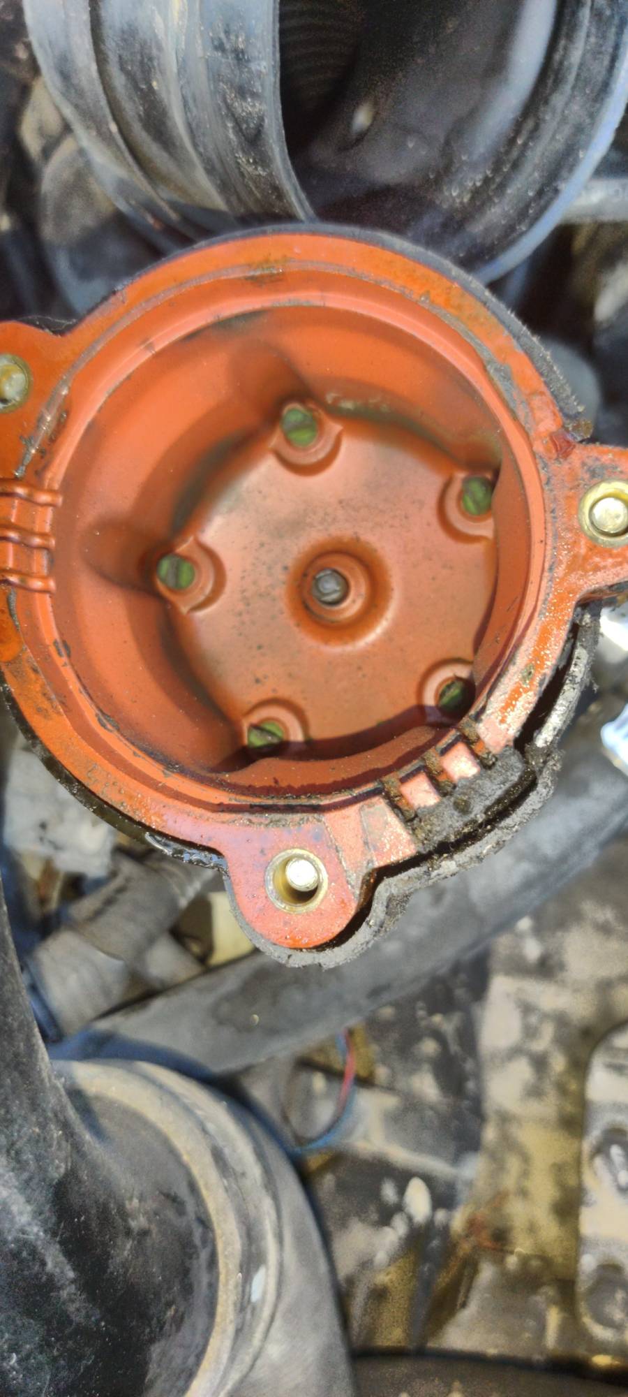

Here are the pics of the rotor and cap.
Also , the wires are dated 4-2010
Defe replacing the wires.
Do the cap and rotor need replaced? Are they shot?
Probably be good to replace all the stuff at the same time.
But , just to share some humor ...what do you think?

10 year old bougicords are fine.
Thst cap and rotor are bottom of the lake worthy. You’ve had moisture in the cap , so sort that out while replacing. Cam seal?

The cap and rotor look dirty, and corroded, but for the short term could probably be cleaned up. I did that on my car since I was ordering parts, and I still needed to go to work. I used a wire wheel on my Dremal tool to clean the contacts, and sprayed everything with brake cleaner, and made sure it was dry before re-assembly.

Thank you that info is helpful.
I will order new and clean up the old cap rotor stuff for temp use.
After checking the temp probe near the thermostat, I saw the connections were dirty. Put CRC contact cleaner on them reassembled everything.
Was good for a short test drive!

Like 454cid suggests, you can try and clean the brass contact on the pins in the distributor cap. Some fine emery paper or careful use of a small screw driver can remove the oxide (green) off of the contact faces of the pins. A very light rub along the front edge of the rotor arm will also clean that up. Just need to get then shiny don't need to go crazy.
Do yo have a plastic cap under the rotor arm? There should be one which can help reduce moisture.
Have you cleaned the engine at all? If you every do, make sure you put a plastic bag over the distributor cap and tape it up to prevent water getting into the cap.
Clean everything up inside there and check again in a week and see if it is getting oily again. If it is then you have a leaking cam seal under the distributor.

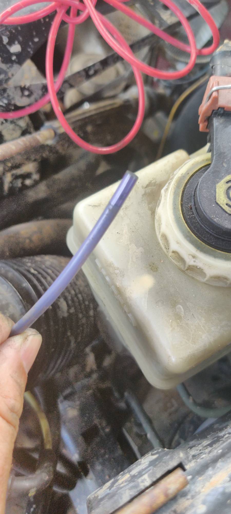

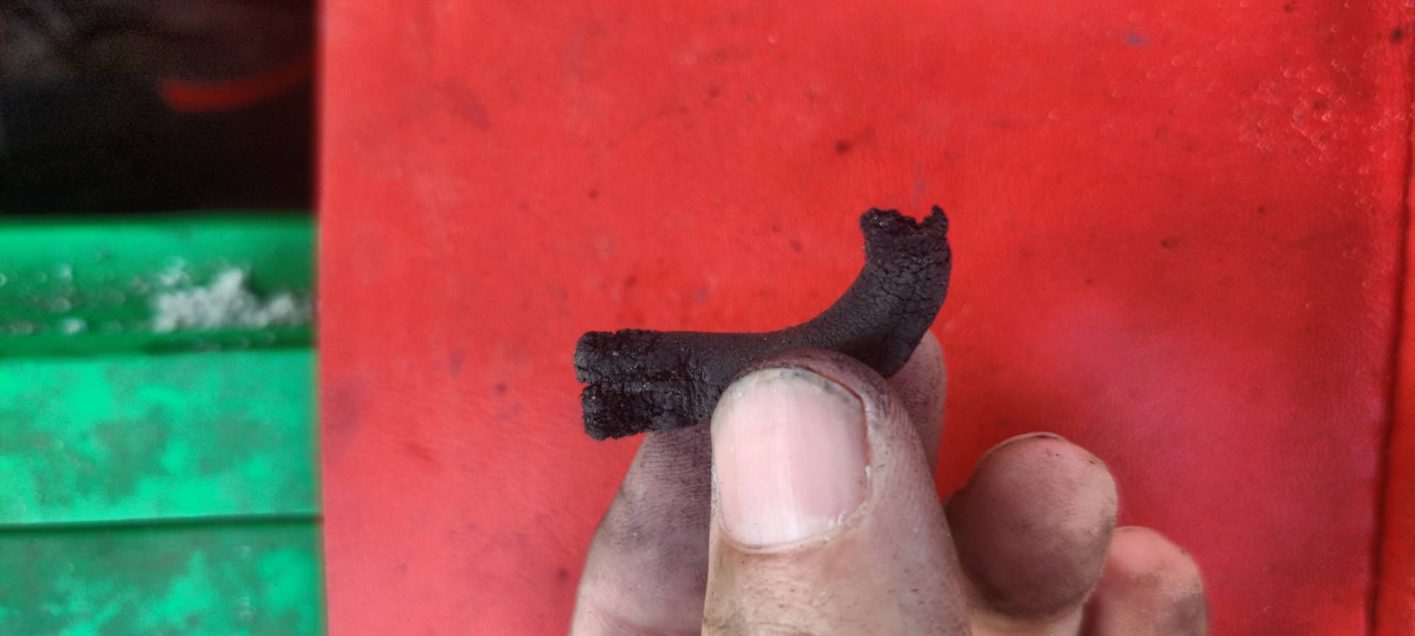

Ok so yesterday went looking at other cars. (Never selling the v70 wagon! Hahaha)
So I found bad hose.
It came of off the purple tubing, and connect to tht back of the silver valve. This is on the silver thing that is on top of near the turbo.
I'm gonna change this out along with the Turbo Control Valve aka TCV.
Would this small bent hose affect warm (cars runs great for the first 15 mins, until hot) warm hot run ability? How?
And what is this part and what does it do. Thanks!
