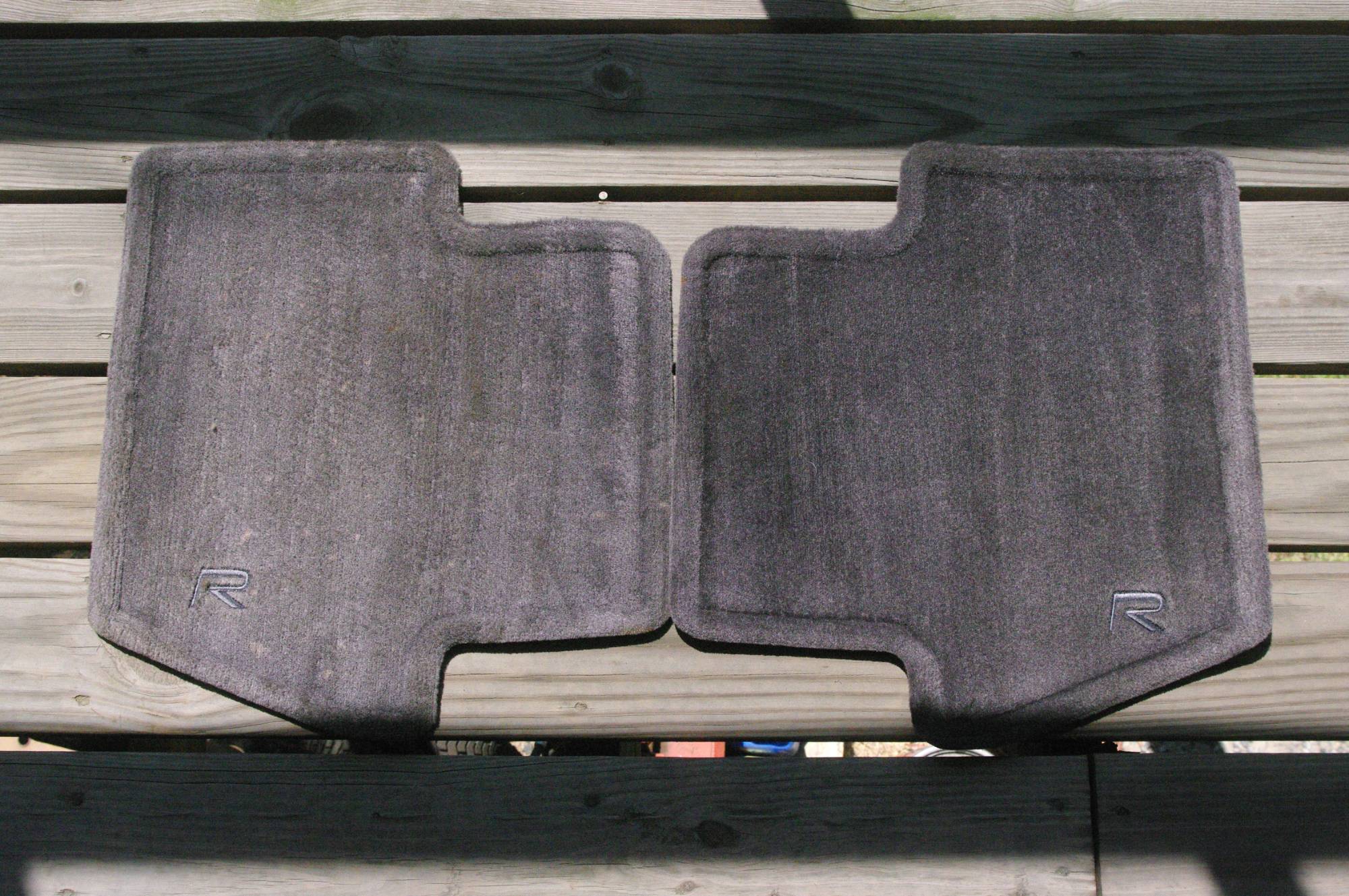

Robert, in the middle of the mayhem in his life, sent me these:
- foggydogg
- Posts: 2948
- Joined: 17 October 2009
- Has thanked: 83 times
- Been thanked: 402 times
- Posts: 35293
- Has thanked: 1503 times
- Been thanked: 3817 times
They are even marked for the ReaR so you don’t get confused
- Posts: 6338
- Joined: 30 December 2014
- Has thanked: 304 times
- Been thanked: 517 times
Those look pretty clean too!

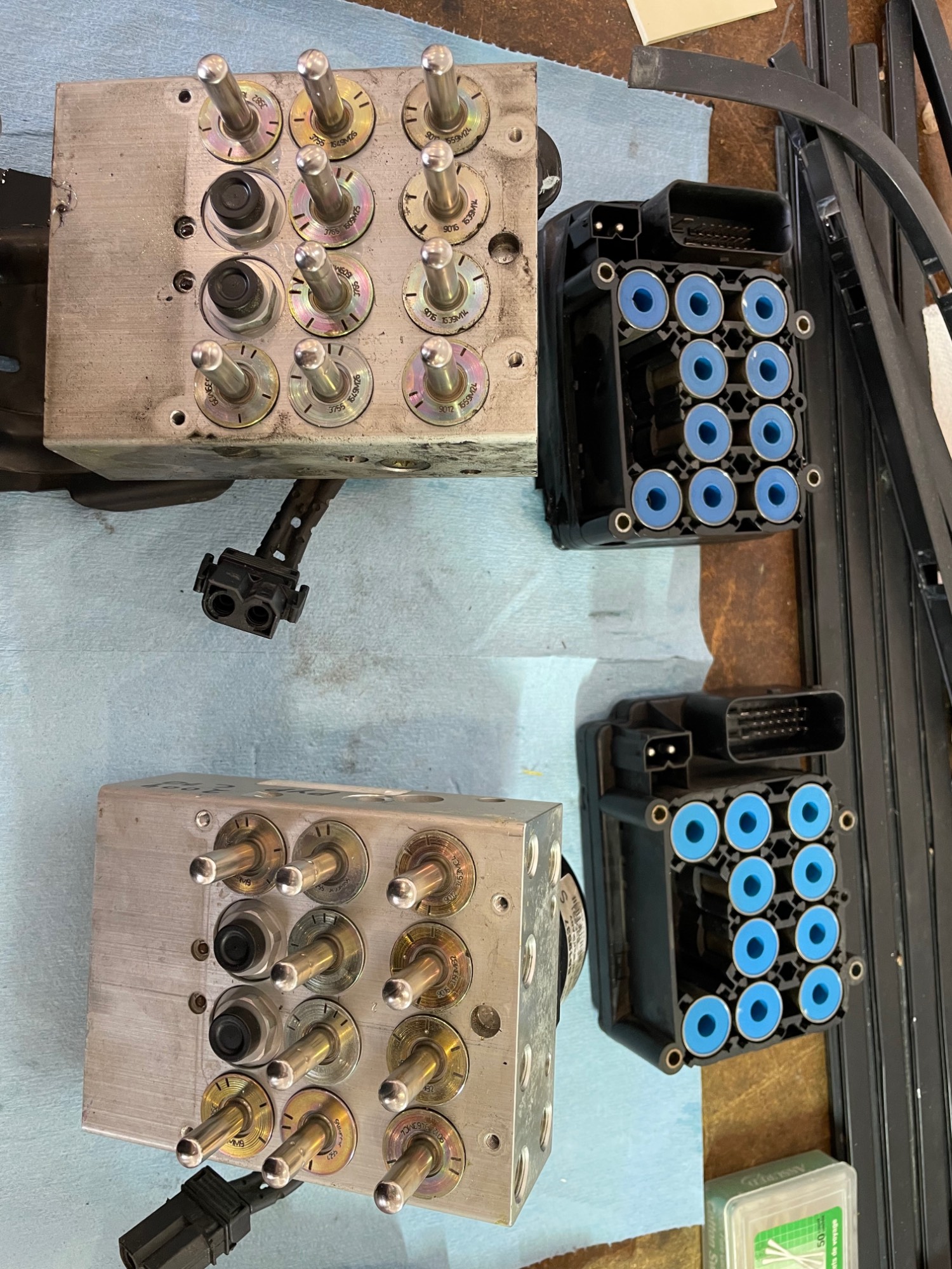

Manage to delete my first post about this so here is the short version:
Internal leak in pump (“aluminum block”). Found a good used one from a 2004 c70 that I grabbed. Car had same brake features as mine, i.e. Both have abs/stc. In my world it will work if i just move the working electronic bcm over to the new pump. Garage temperature is now close to a Finnish Sauna so work probably continues tmrw morning.

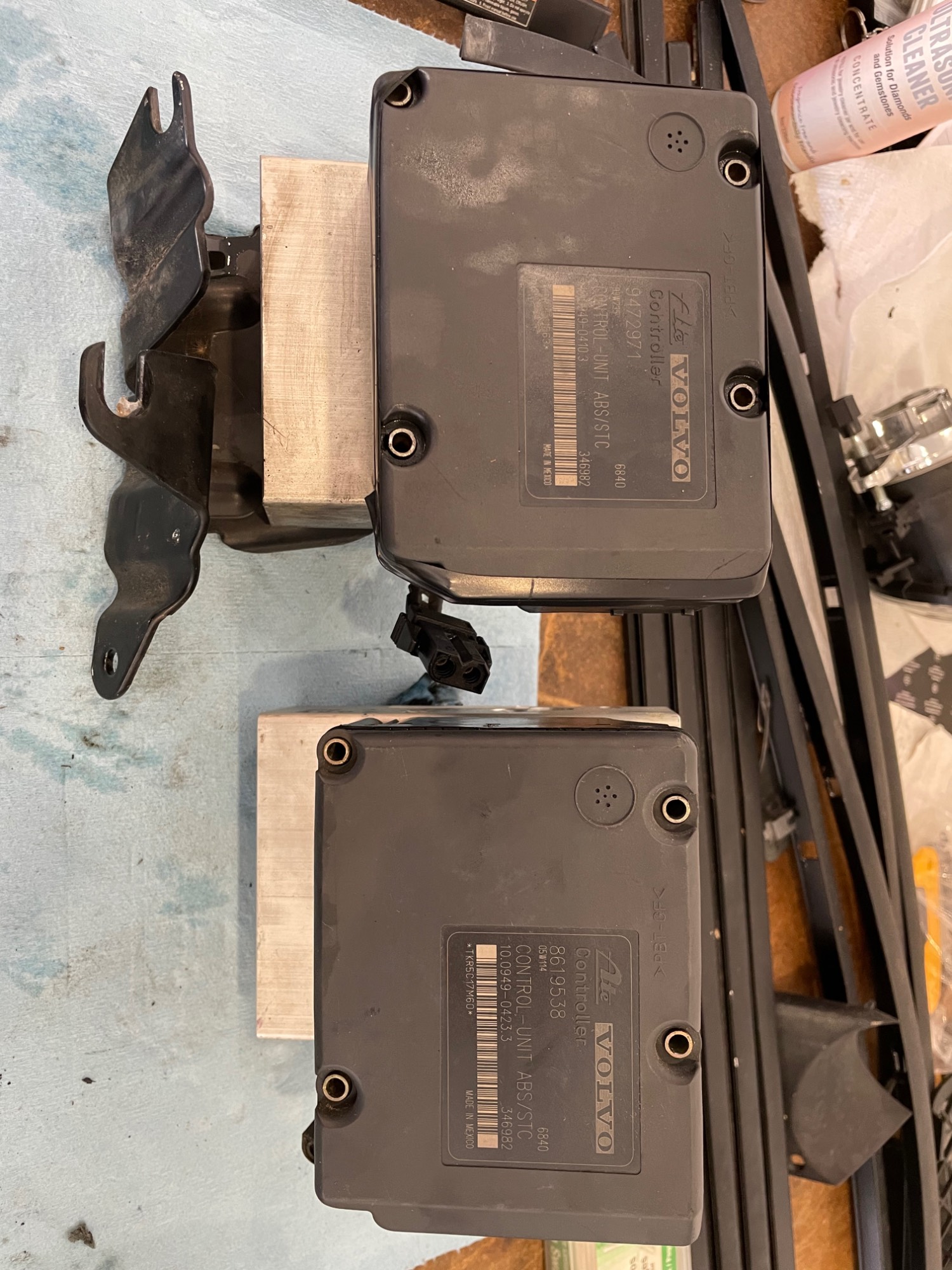

I loosened the three 10mm bolts to get the module out. For me that felt easier than to fiddle with those t25 nuts.

Chances of moving those t25 on the Northeast crud, zero. Great tip on just moving the bolts to get the unit out.
The intellectually superior amongst us know exactly why there are 10 valves on the ABS body. Let me know when you figure it out, I haven’t yet. Probably googleable , but where’s the fun in that!
Conjecture
On1999- the ABS independently controls each wheel, previously it’s front independent, and rear dual
I think you need two valves on each wheel, one to close off the feed from the master, and the other to open hydraulic pressure from the ABS pump
4 wheels x2 valves = 8
The last two snub off the feeds from the master, maybe, protecting it from residual pressure after an ABS intervention ?
Total 10

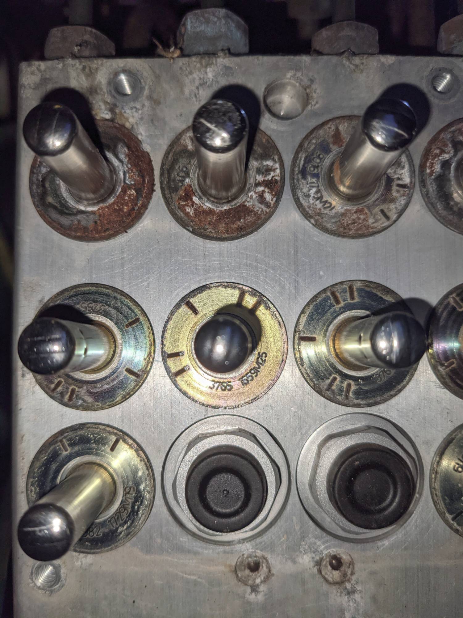

What symptoms did you have and how did you determine that an internal leak was the problem? On Geronimo, some of the 10 pins have, making me suspect the aluminum block as a potential failure point.
- PXL_20220101_015731329.jpg (371.55 KiB) Viewed 320 times
