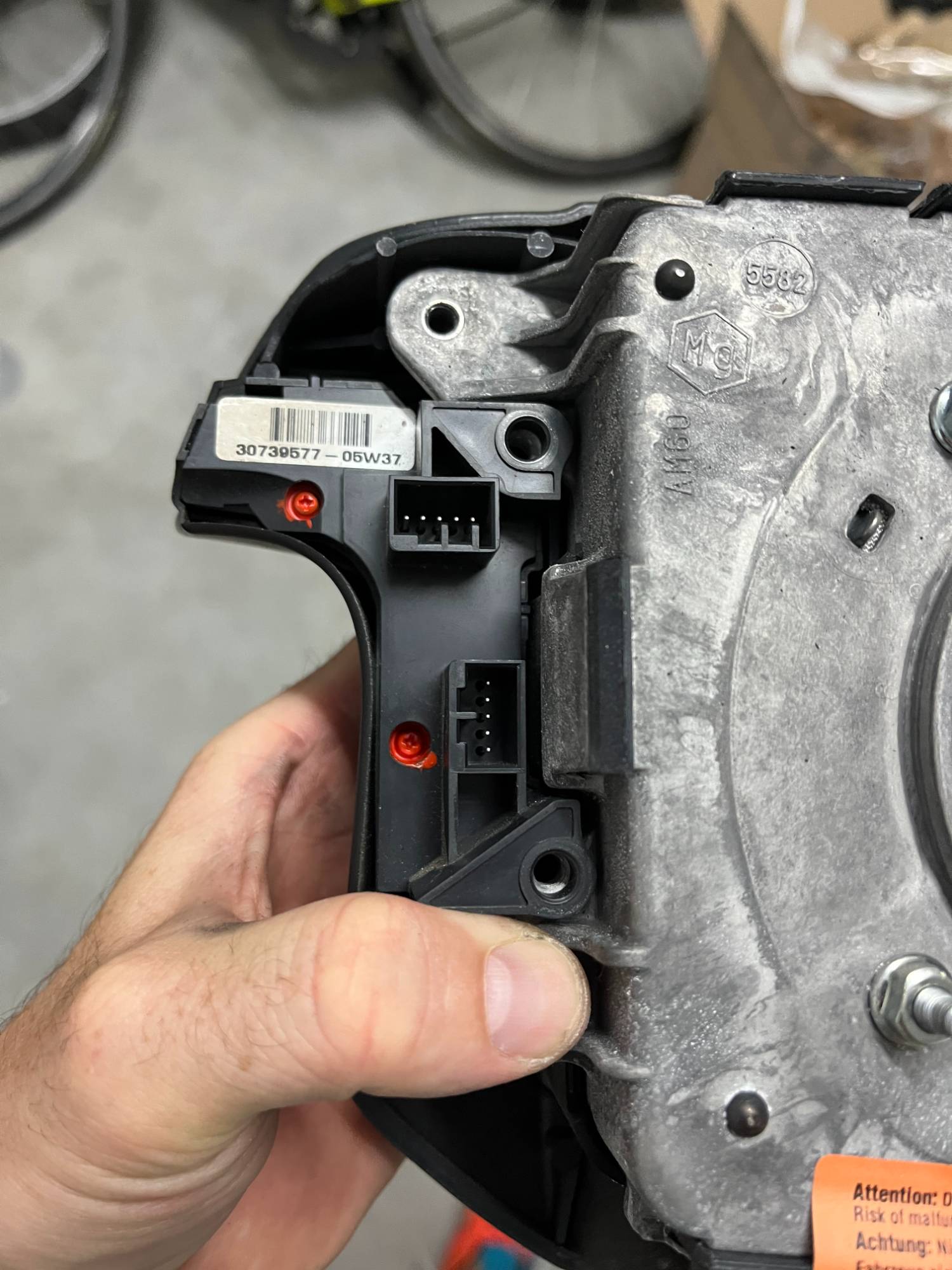

As of know have on the bracket is this connector only, which is goes to the cruise control
The cruise control has 2 sockets only 1 being in use(top)
The audio control has 2 connections, but not sure which one should I use and whit what cable
The audio control lower socket and the cruise control cable can be connected, from the original harness, however, it won't work
