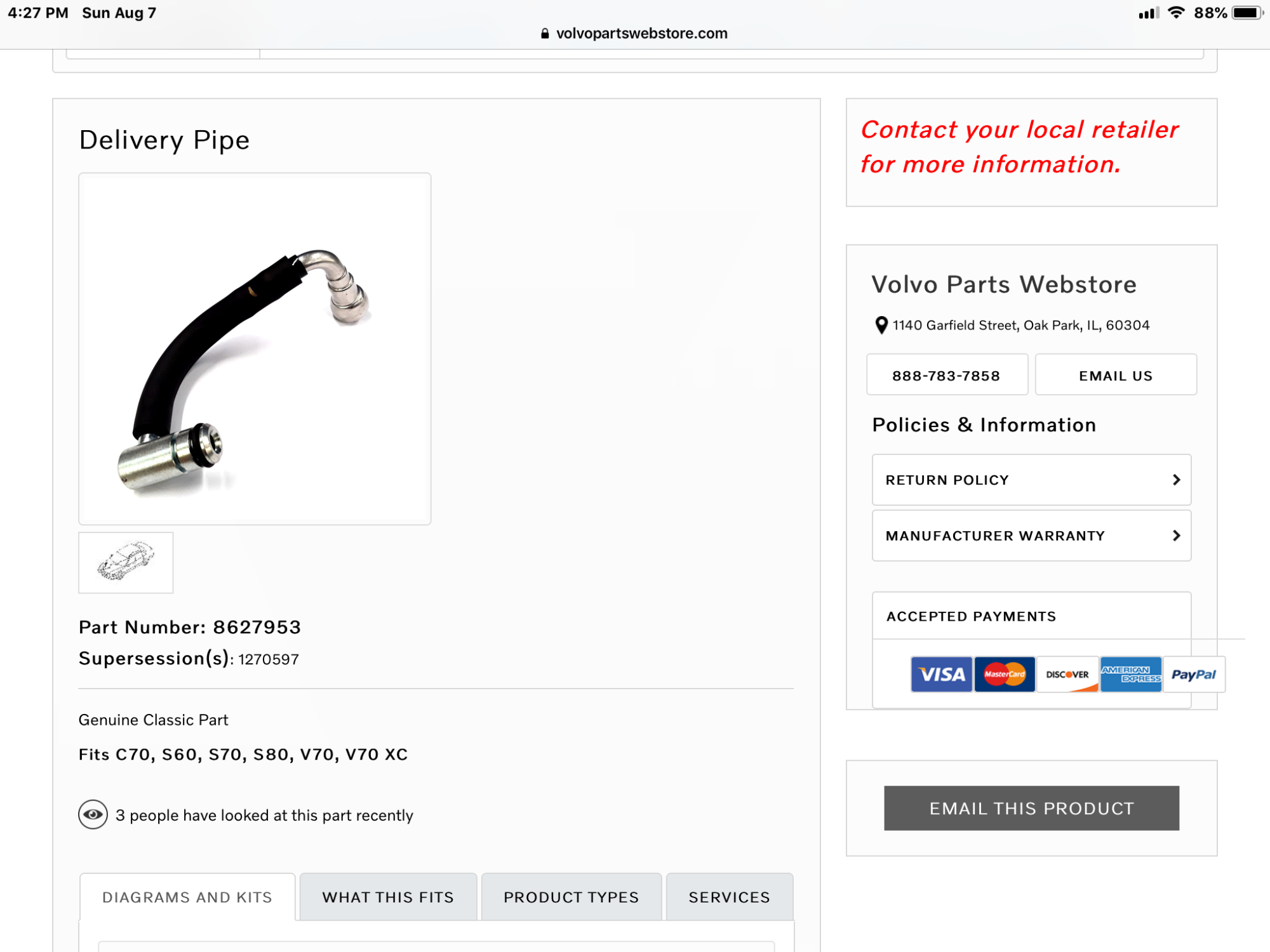

I have found a fuel leak at the front end of my engine. There is a little 90 degree metal fitting directly behind my oil dipstick. Where the hard line goes in from the left hand side, fuel is leaking out. Can some one please advise on how to stop the leak temporarily, as well as repair permanently? Awe and thanks in advance!🤔

There are o rings in the bell like piece of this pipe that seal on the hard fuel line. These are hard to replace. I would source this part at a junkyard

Thanks Abscate! Is this a basic diy or is it more involved. Just wondering if that entire fuel rail needs to come out? Cheers!

I think you can get that off with the fuel rail in place. You do need a tool or fab something to release the springs which hold the line in th e o-ring

You need a fuel line release tool like these:
https://www.harborfreight.com/fuel-line ... 63595.html
Should also be available at any auto supply store.
