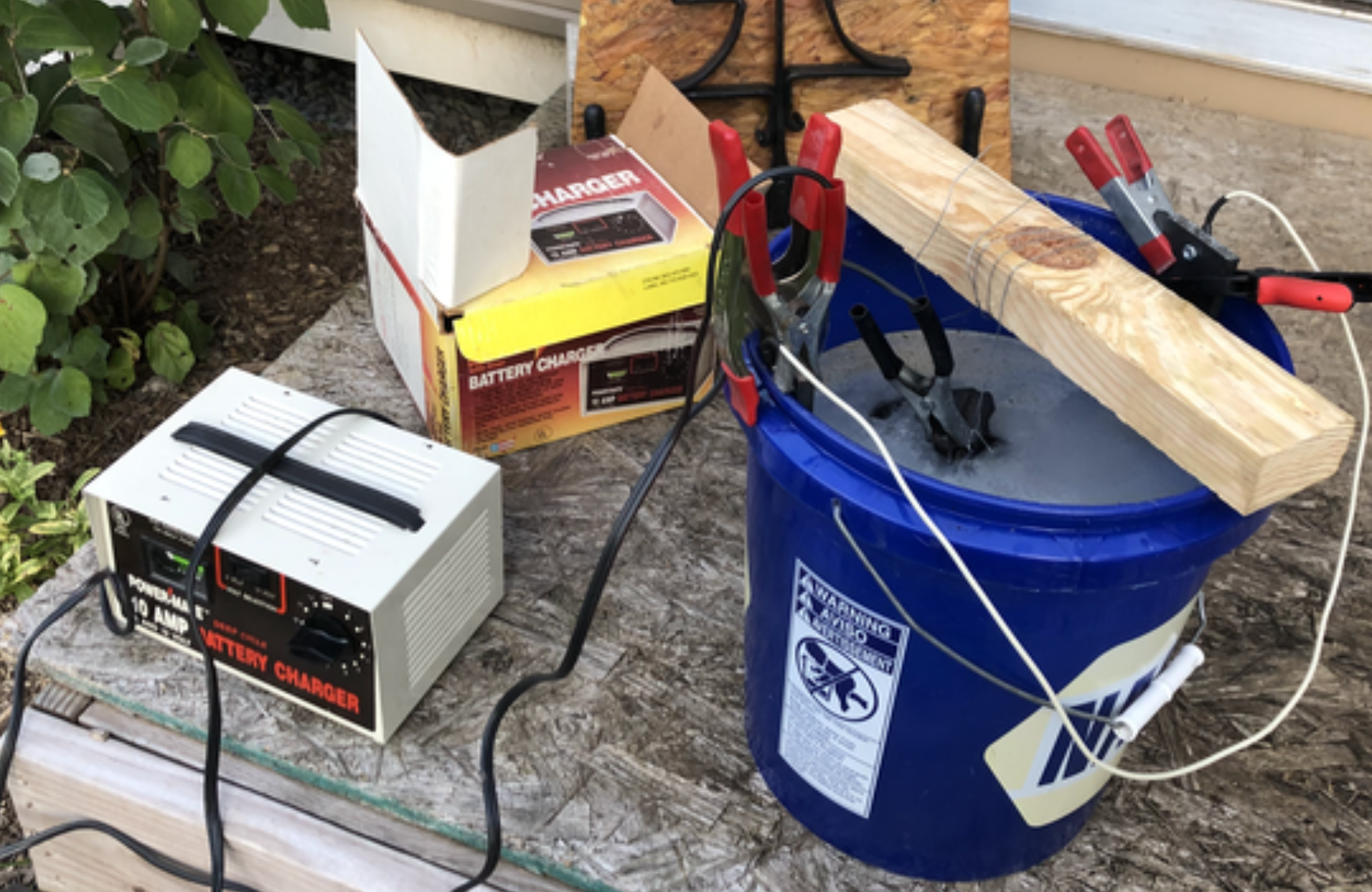

Amazing results. How did you clean the calipers that well without a sandblasting cabinet? Granted, I'm used to seeing New England calipers "pulled from the lake", as people say. After getting my new four calipers stripped and powder coated, I intend to try and rehabilitate my current ones as spares, like you did.
Thanks.
I initially used electrolysis to help remove grime, previous coating (if any) and rust.
after being in there for an hour or so, I'd remove it, rinse it in clean water and scrub with a cheap metal brush (tooth brush sized.
After a while I realized that the electrolysis had done its de-rusting job and was now just laying down more black residue.
a little CLR (Calcium/LIme/Rust cleaner) seemed to remove a lot of the black residue. It could have just been elbow grease with the brush.
Then I chucked various sizes of wire wheels into a drill and that got most of the caliper back to bright shiny metal. I only had to clean up some nooks and crannies with the cheap wire brush by hand.
In fact, cleaning the calipers and bracket took most of the time on the job. Rebuilding the calipers and re-assembly was quick.
Also I know what you mean by the seal being tricky to get in the groove. The fact that the seal has many folds allows it to hide whether or not it is in the groove . I had to use a pick to pop it in the groove and then rotate piston to expose a fresh part that needed seating.

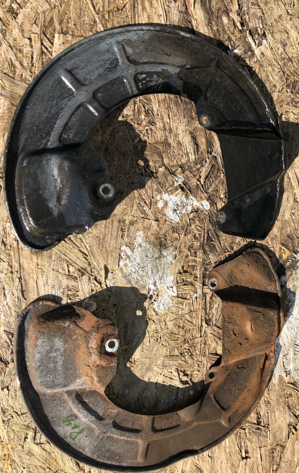

btw. I don't have a before/after electrolysis picture of my calipers, but here is one of the dust shields.
Top is showing an after photo with some of the black residue that the process lays down. That comes off with scrubbing.
Below is the before showing the rust.

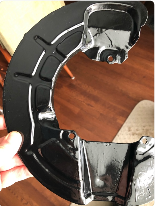

after cleaning up I used POR-15 to paint. POR-15 is some sort of super tough anti rust paint. I don't know the chemistry of it but it's not your typical paint.

POR15 is a moisture cured urethane. It gets hard and brittle like glass, but some people get great results with it. Let us know how it holds up.
I'm curious why you wouldn't have those parts sandblasted to give a toothy surface for the coatings.

850oldschool wrote: 11 Aug 2022, 09:47 POR15 is a moisture cured urethane. It gets hard and brittle like glass, but some people get great results with it. Let us know how it holds up.
Ah right. Moisture cure urethane. That's right. Thanks
and to clarify, only the dust shields were Por-15. The calipers and brackets were painted in G2 caliper paint which is a 2 part epoxy paint. I used Por-15 on the dust shields only because i had some left over from another project.
I suppose the only reason I didn't have them sand blasted was that would requirement taking them somewhere (I don't have a sand blasting cabinet myself) and I had all the supplies at home for the techniques I used.
