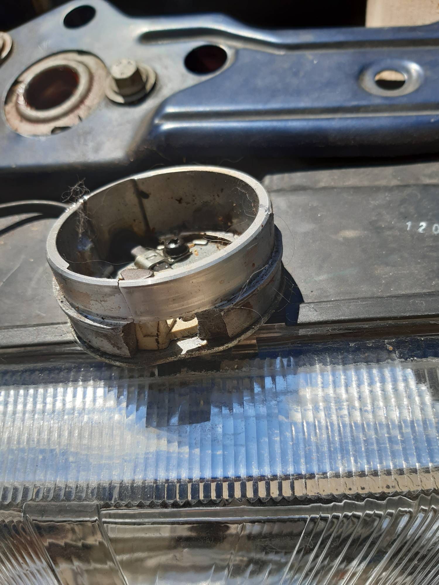

I have cleaned all the other ground points I could find (on the frame near the battery, the two points on the block close to the injectors, the one going from the frame to the Camshaft position sensor). I noticed the the camshaft position sensor had a broken corner, the one with the ground connector attached (see picture) and I also replaced it. Starting the car with our without the camshaft position sensor does not seem to make any difference to the engine behaviour (but I did not drive without it). I also seem to have a faulty lambda probe (warning light), I have the part but could not replace it yet as the old one does not move an inch, but I do not see why the lambda proble would cause this low voltage issue at the ignition coils. Does anyone already experienced this? I have no more ideas about where to look for. Thanks, Antoine
