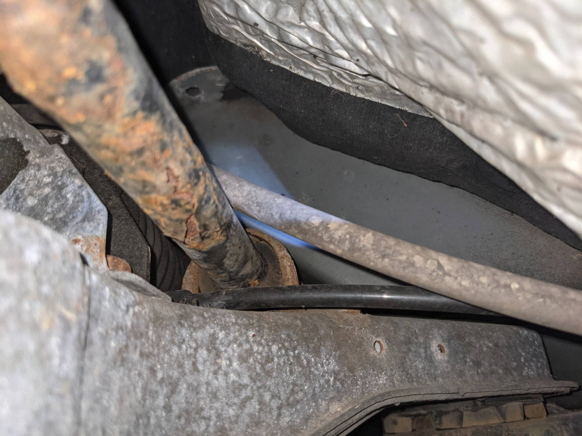

Based on the attached pictures, how bad are my sway bar bushings? This is on a 2000 V70 with 228k miles. I don't feel or hear any noise from them. Just just look cracked. I don't want poly bushings since lubricating them seems like a pain, so I'm considering replacing the entire bar.
Is it recommended to replace a rusty sway bar? The black coating has failed in a few spots.
Can a 2000 V70 accept any variation of sway bar? The sway bar I need (9173983 "marked 2") is not available, but 9173982 "marked 1" is available. Are they only different because their diameter?
How bad are my sway bar bushings?

Yes is the answer. The only difference is the diameter. I once posted the part numbers and codes a long time back. If I recall the V70XC was the thickest at around 21.5mm if I remember correctly.
If you are not hearing any groaning from the sway-bar or clunking they I would leave it alone. Sure it is getting ugly but as you know the bushes are vulcanised onto the sway-bar, once they let go you will know it!
You could preserve the bar itself for now with some POR-15 or similar and a wire brush!
