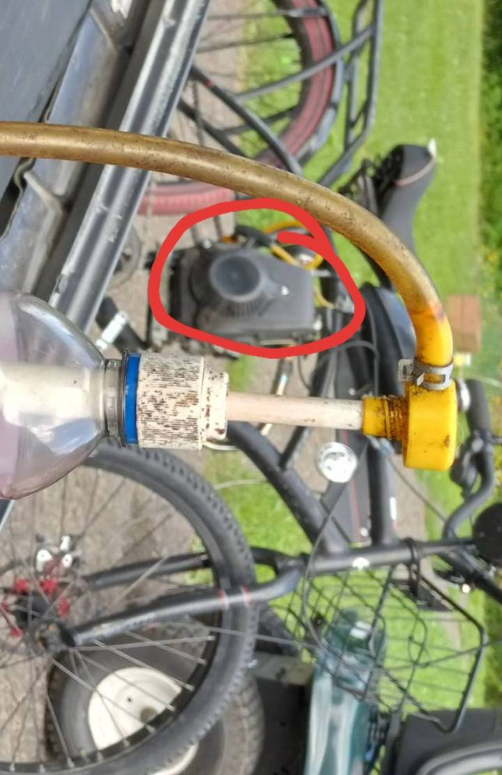

jonesg wrote: 11 Aug 2022, 17:59 Replaced the leaked tranny fluid, i only measured half a cup when the lower cooling pipe was pulled from the radiator, thats all I put back.
I found it easiest to pump it back in the top cooling hose rather than mess with the dipstick hole.
Pump conveniently threads on the top of a soda bottle, same threads as quart of oil.
never bothered measuring the fluid hot as it shifts fine and i put back the same as came out so...
Don't know how the pic got rotated 90 degs.
Is that an internal combustion powered bicycle? :o
[/quote]
Gas-powered stereo.

Krons wrote: 17 Aug 2022, 20:53
yep, infernal combustion engine on a walmart beach cruiser.
4 stroke, 49cc, conversion kit from bike berry.
