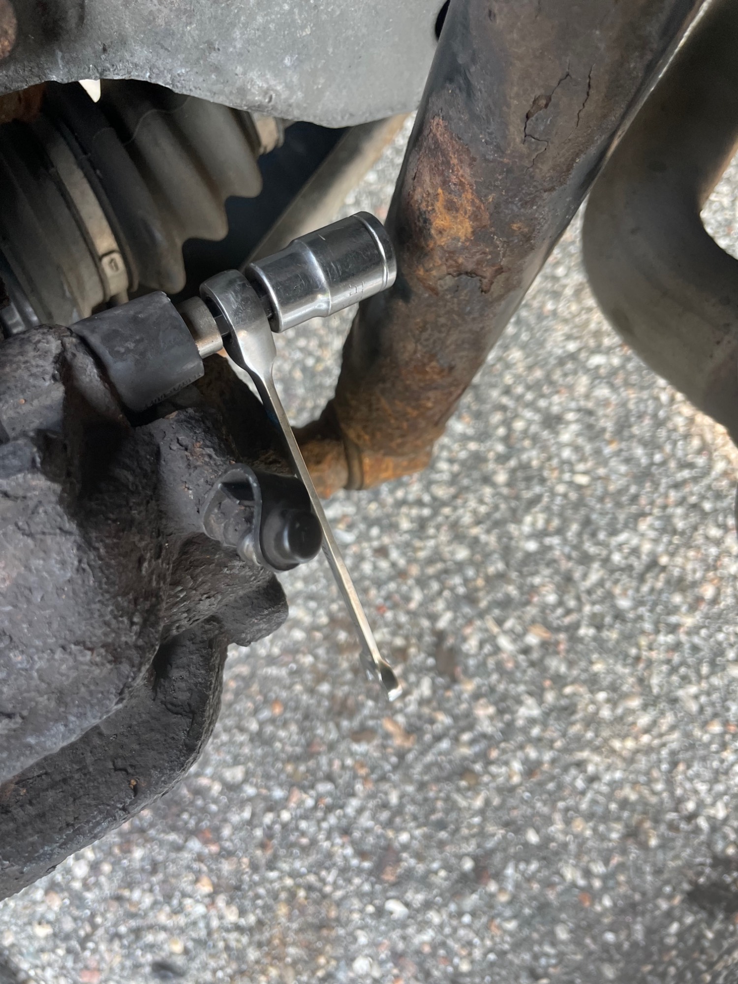

Trick for low clearance caliper slide bolts. Socket ratchet hits shock, but my hex bits take a 10mm ratchet in a raised boss

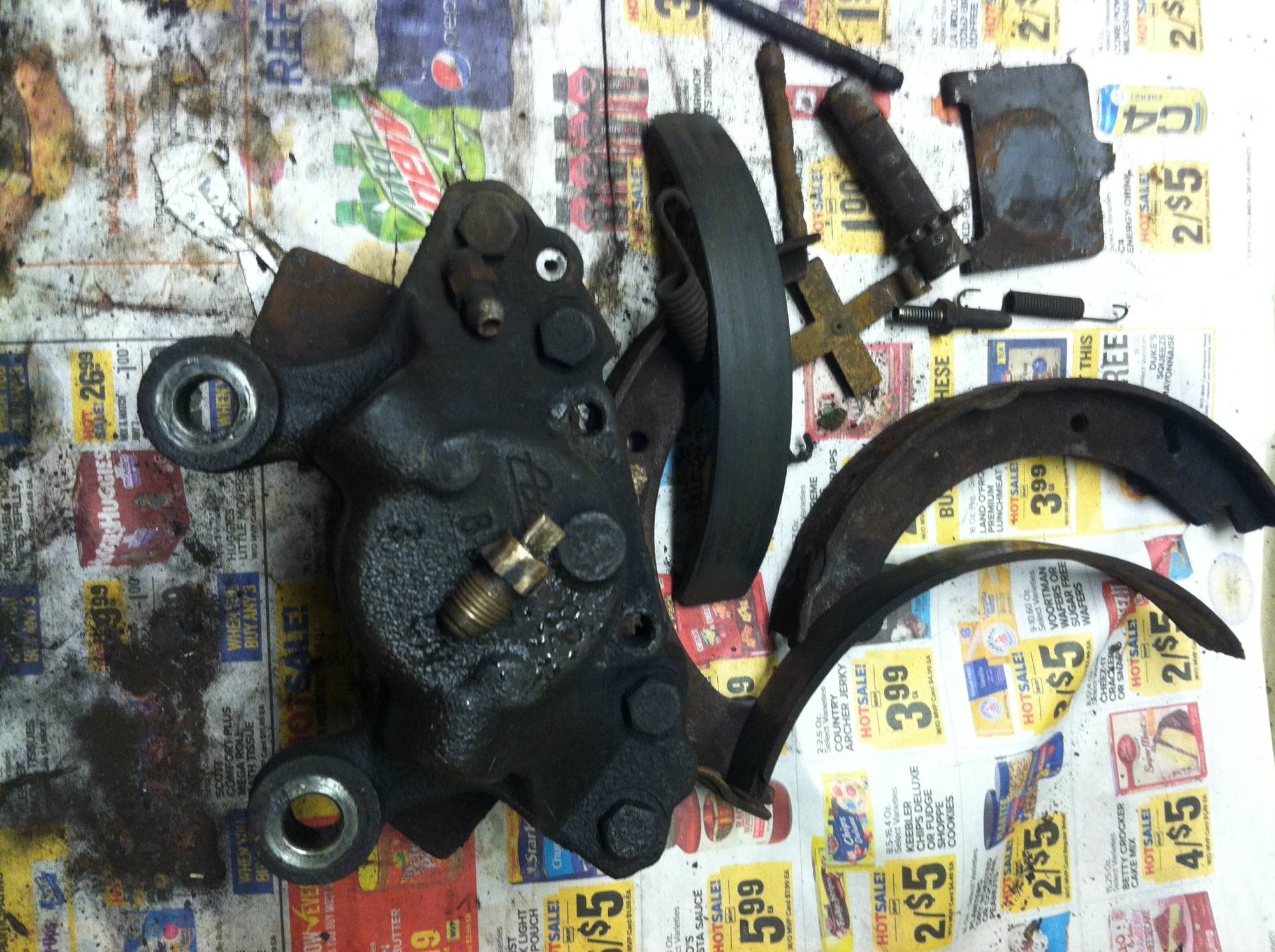

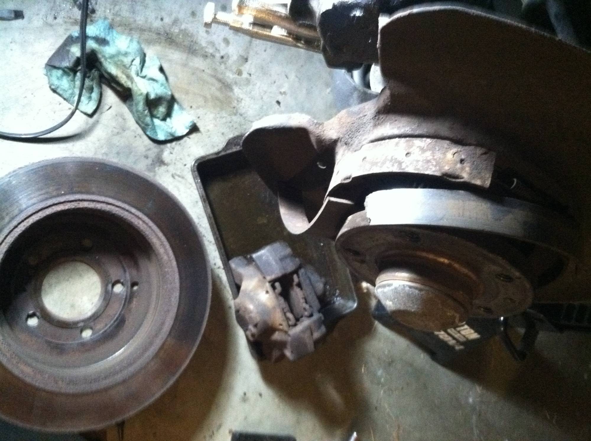

Rusty rotor visible through the wheel equals braking action nil on that corner. Ditto the parking brake.
Stuck puck.
I didn't know it at the time, but this car was a rolling total loss when I got it. Couple of round trips with the subframe, and three steering racks has given me a clue.
Not only was there anti-seize on the lug bolts - instant fail on the ASE test, "clean and dry" is the correct answer - but there was also anti-seize on the caliper bolts (!).
Double noise shims on the pads, so that part was extra special.
Naturally, I have to blast into DC in the morning, so had to harvest the bits off Poor Olde Blue.

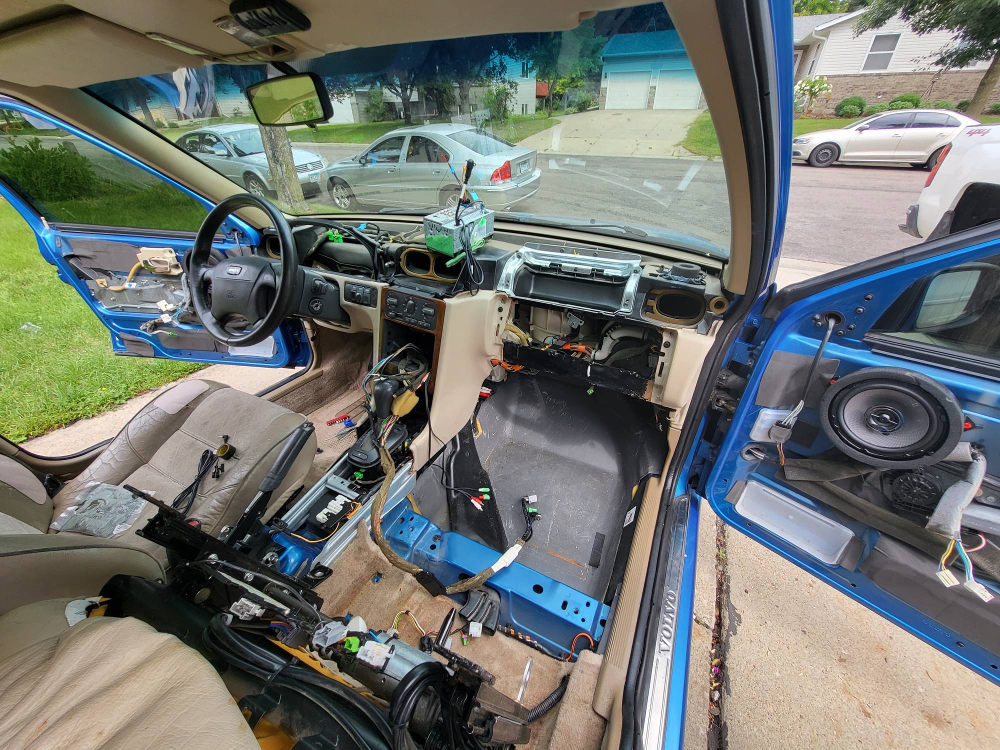

Started taking the dash apart to install a new head unit... and then just kept going. Currently vacuuming 24 year old dust.

Oooh, a laser!
