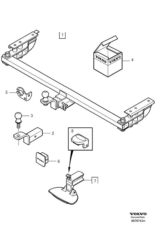

I almost bought the factory hitch a couple of years ago for another small trailer. I like it because it's engineered by Volvo and fits up inside the bumper cover, not hanging down like the aftermarket ones (although they all bolt into the same factory-provided holes). Now they're NLA apparently, and hit or miss at salvage yards. We have a nice hitch on the 850 and used that car.
Volvo factory hitch # 30682087.jpg (55.99 KiB) Viewed 276 times
Volvo trailer harness.jpg (294.9 KiB) Viewed 276 times
I've learned that all factory or aftermarket P2 hitches are Class II, 1 1/4" receivers. No 2", no Class III, although the Class II is rated for 3500 lbs and 300 lbs tongue weight. A Class II is not designed for a weight distribution / sway-reducing hitch set up, so the load has to be balanced correctly. The owner has been towing this boat with an older Honda Odyssey with 200k miles.
