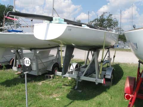

Just doing some rough math at the possibility of towing a sweet old sailboat home 1200 miles with my wagon, and being able to move it around or transport to the lake 80 miles seasonally, and maybe out to Seattle 500 miles.
I learn the P2's have a 3300lb towing limit. That means tongue weight should be between 330 and 495 lbs.
The boat is just under 2300lbs, 27' long, and sits high on the trailer with a fixed keel. So, a 2300 lb boat and a single axle 500(?), 700lb steel trailer. That makes 3000lbs, with an allowable tongue weight between 300 and 450lbs. This assumes no storage boxes and gear on the trailer. Unloaded car weight is 3827 (wow, really? My 850 is 3400) I don't know what the combined gross weight limit is, is that on the door jamb tag?
That makes 300 lbs breathing room on the towing limit. I'm assuming finding the factory frame-mounted hitch assembly, which fits recessed up tight to the chassis, not hanging down. That's a Class II hitch, right, at 1 1/4"? A weight distribution hitch seems smart.
This specific trailer has a surge brake unit on the tongue. I've done a bit of reading on retrofitting electric disk brakes on a trailer - I like the idea of that because of instant response reducing fishtailing.
So the weight on a boat like this is all in the keel, down low on the trailer over the axle, not up high or hanging off the back the full length. I'm told it isn't bad to tow (unless you get a trailer flat on an LA freeway at night (this happened).
I would probably need to install a auxiliary transmission cooler up front. I'm thinking new tires and maybe wheel bearings before I brought it home. The seller hoists the boat off the trailer and it never gets dunked in salt water.
Anyone have experience with this, close to these numbers?
