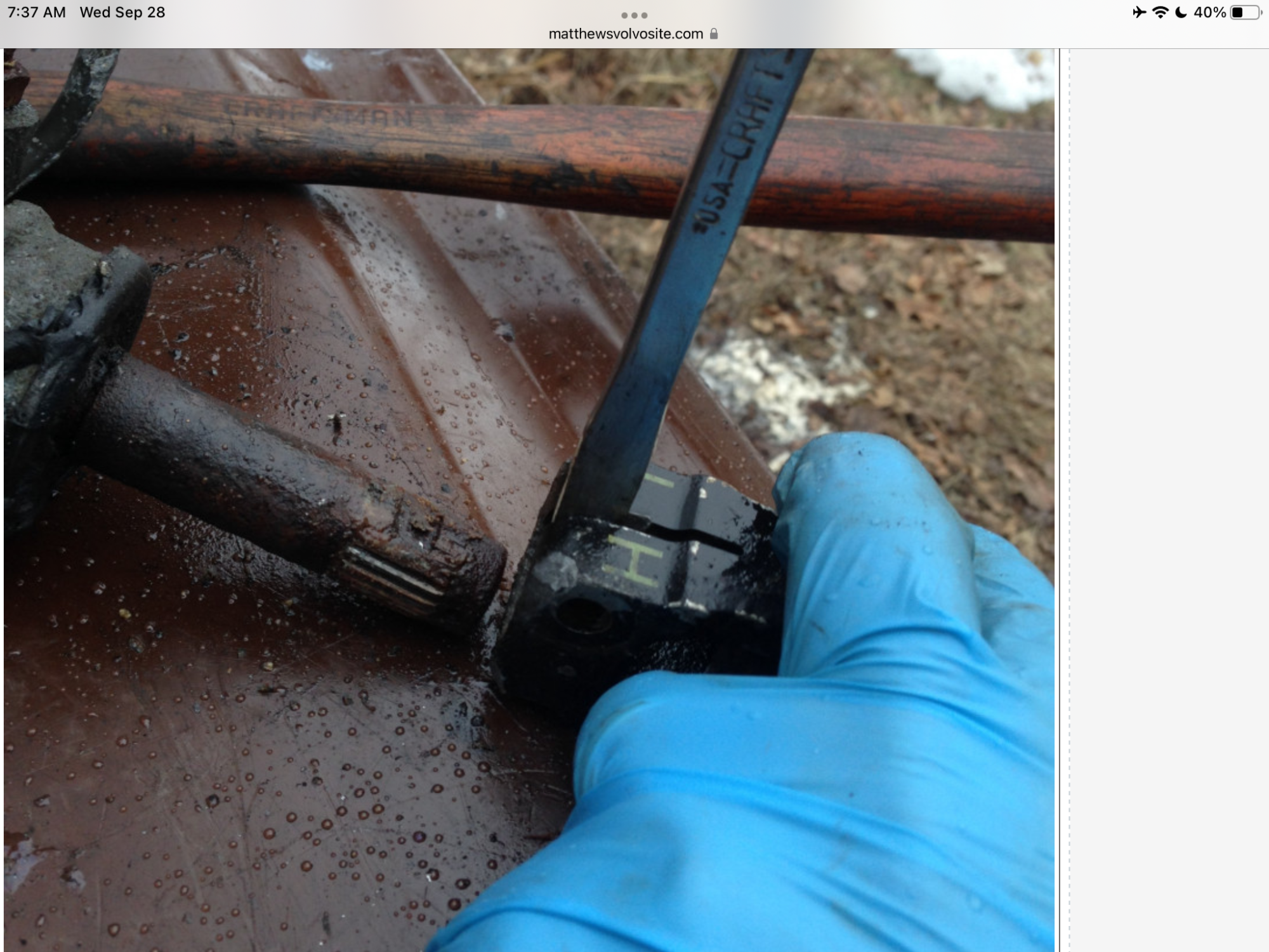

1. free the pinch connection between the steering shaft and the rack. 10mm bolt removed. Now trying to separate the "frozen" coupling. Using PB Blaster, tapping and pry bar without any progress (so far). Suggestions? Something with a gear-puller, spreading action ? Heat?

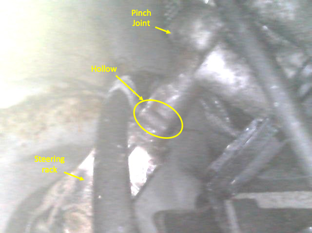

Also, there seems to be a hollow in the rack shaft that I didn't expect. See photo - sorry for poor quality. The coupling screw fits into this type of hollow, but in a different position on the shaft. What is the meaning of this second hollow? Fitment to a different model/car? It can't be the only hollow present on this shaft.

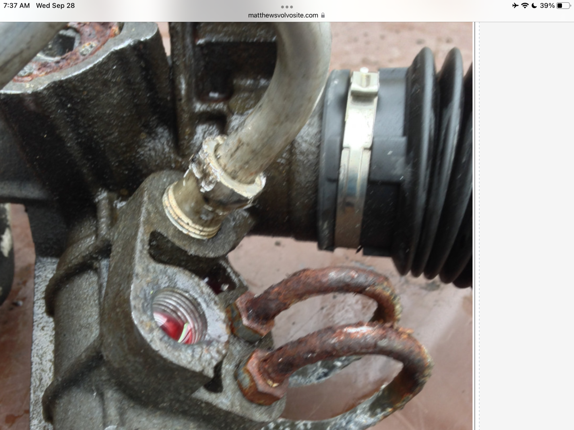

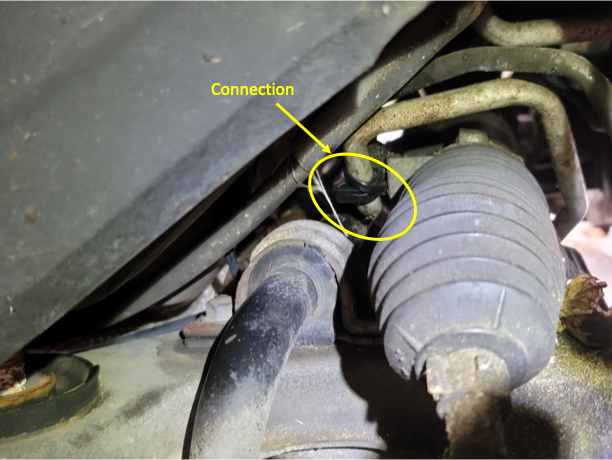

2. free the supply/return lines where they are bracketed to the rack (apparently for stability). See photo. I didn't expect this connection, although it is referred to here: https://www.matthewsvolvosite.com/2004- ... k-replace/ . How does one remove and replace this connection? Mostly concerned about replacing, as I'm sure I can remove it one way or another.

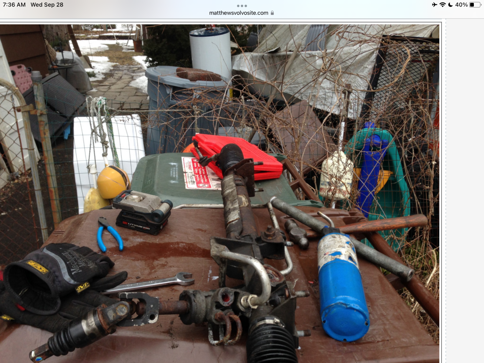

Come inside the car and disconnect the yoke in the dry, rust free interior under the rubber boot. Once the rack is up on the bench, the engine compartment yoke is much easier to deal with.1. free the pinch connection between the steering shaft and the rack. 10mm bolt removed. Now trying to separate the "frozen" coupling. Using PB Blaster, tapping and pry bar without any progress (so far). Suggestions? Something with a gear-puller, spreading action ? Heat?
My line brackets surrendered to entropy so i fabbed brackets from old cooling hose and zip ties.

I thought that getting the rack out with the additional length would be difficult if not impossible. But I will try it. I guess the U-joint might allow sufficient flexibility to make it work.
I saw what looked like a zip tie on that fixture.

See the picture here. It’s really tough to get access on the car, which is why I recommend getting it on the benchfree the pinch connection between the steering shaft and the rack. 10mm bolt removed. Now trying to separate the "frozen" coupling. Using PB Blaster, tapping and pry bar without any progress (so far). Suggestions? Something with a gear-puller, spreading action ? Heat?

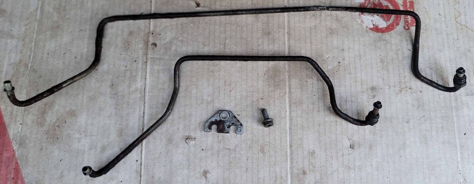

I successfully removed the hydraulic lines (after freeing the supply/return lines bracket to the subframe (easily accessible 10mm bolt) and the ziptied bracket I asked about earlier). The 12 mm nuts at the distal ends (crows foot) and the plate retaining bolt at the proximal ends (1/4 inch u-joint adapter plus short wobble extension since wobble alone wasn't enough angle) yielded very easily ~15 minutes after PB Blaster. Torx TT27 fit the latter better than standard T27 even though the bolt lacked a tamper-resistant center pin. My TT27 bit has broader wings than my T27. The 12 mm end of the long line was partially visible through a hole in the subframe. That helped. The 12 mm end of the short line could almost be viewed from the rear. Both were semi-blind removals but again, yielded easily once the tools were properly placed.
Maneuvering the lines out of the vehicle by fiddly trial and error was easier (perhaps *much* easier) because I had already cut the longer line into two pieces - see photo. Fitting new lines will likely be more difficult, and perhaps not possible without better access. Which brings me to the steering coupler.

- Power steering rack hydraulic lines, 12 mm nuts, retaining plate and TT27 bolt. Long line in two pieces.
