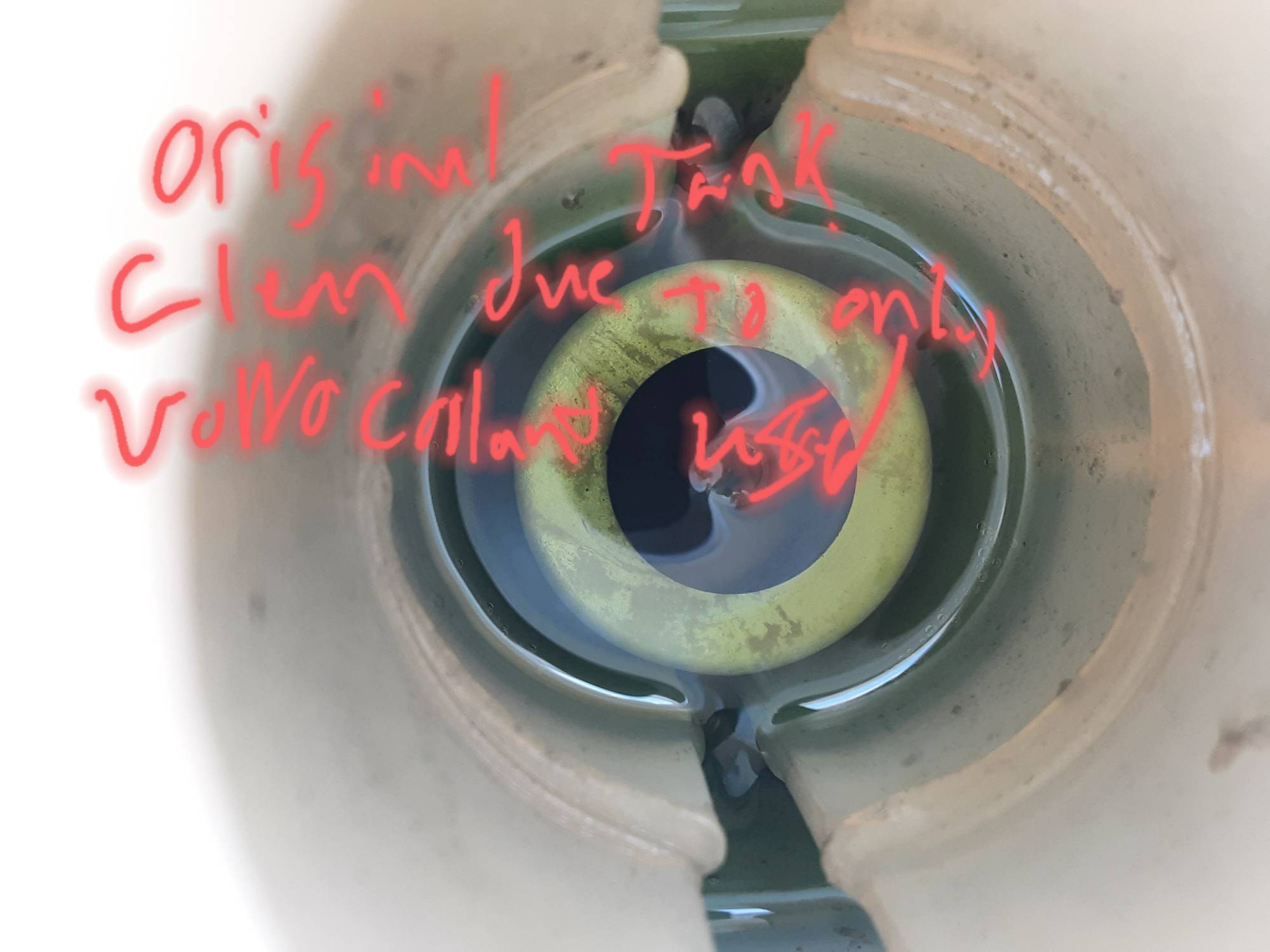

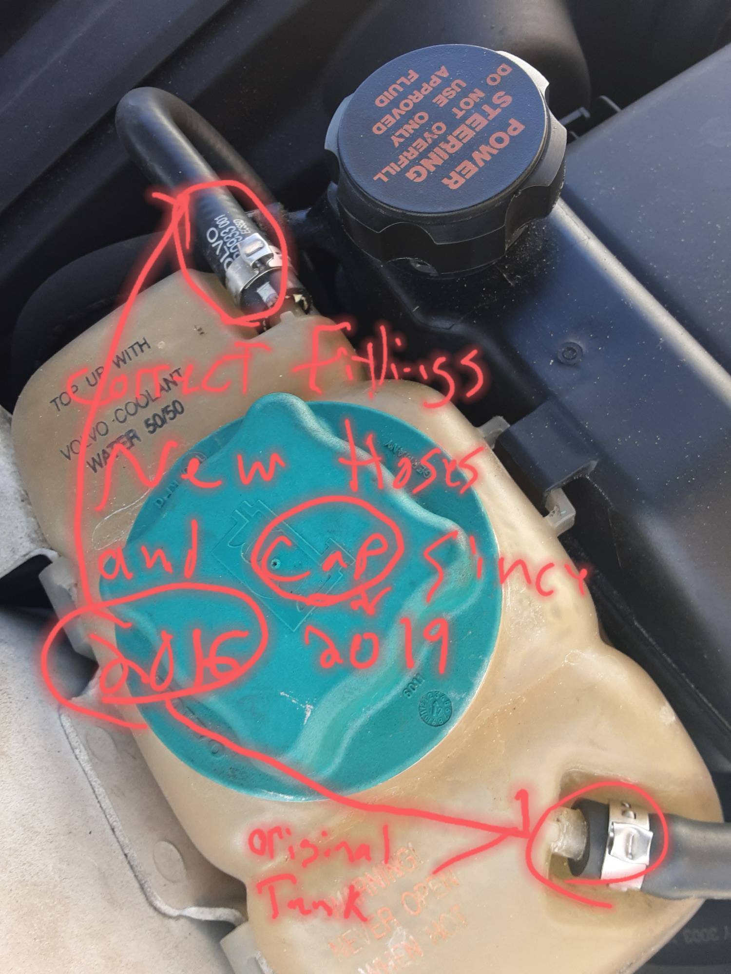

150K to 200K with typical lack of service ie long oil change time/miles. Also look for genuine Volvo coolant as according to the "Burnt valve database on MVS" White 5 cylinder engines engines using aftermarket coolant are more apt to have valve trouble. Volvo coolant dries more crusty than standard coolant. I suspect the Volvo coolant has a additive built in similar to the separate Subaru coolant additive required by Subaru. As far as the coolant and burnt valve issue, I have read on MVS that it may have a additive to prevent hot spots. Who really knows...

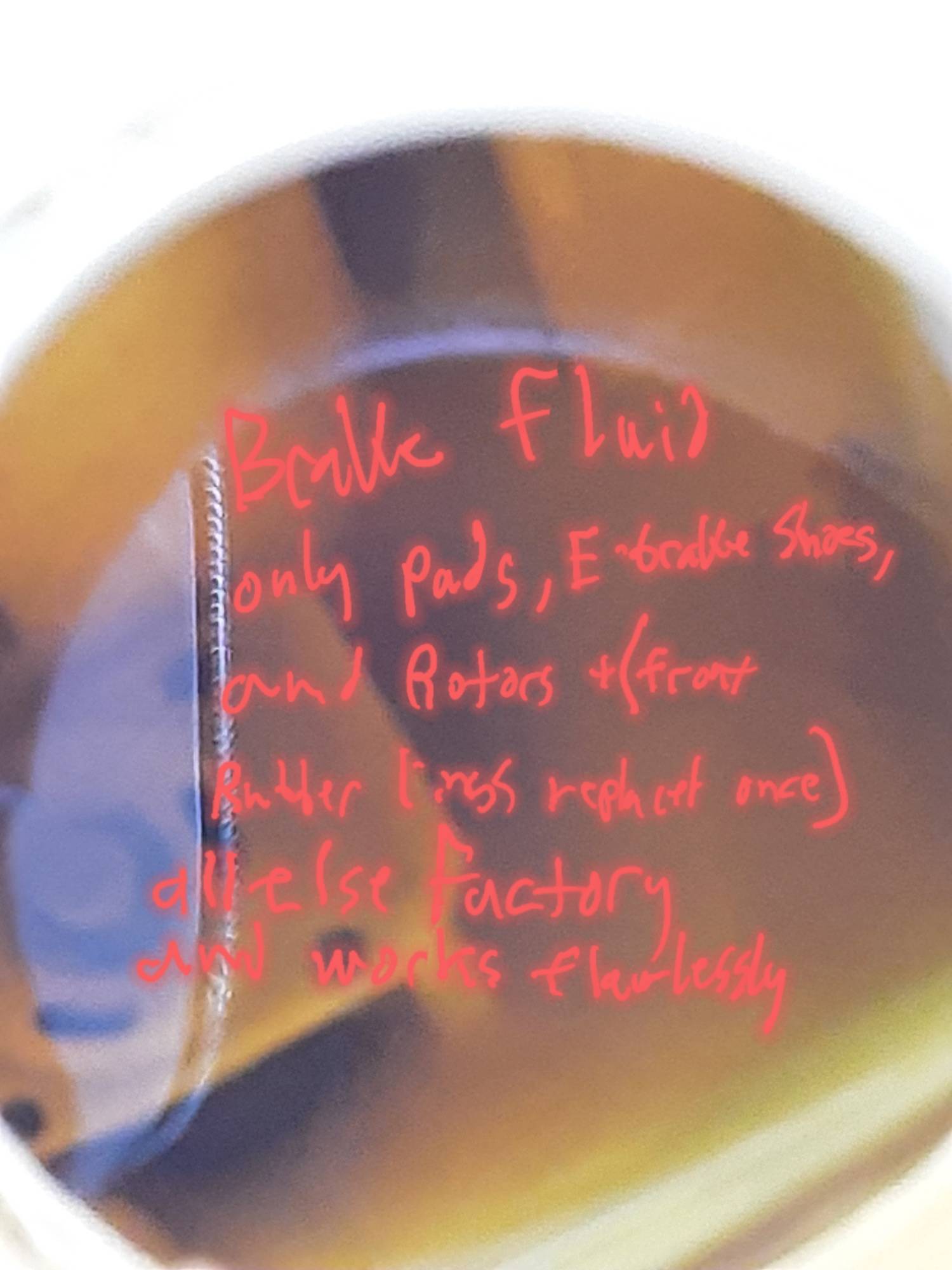

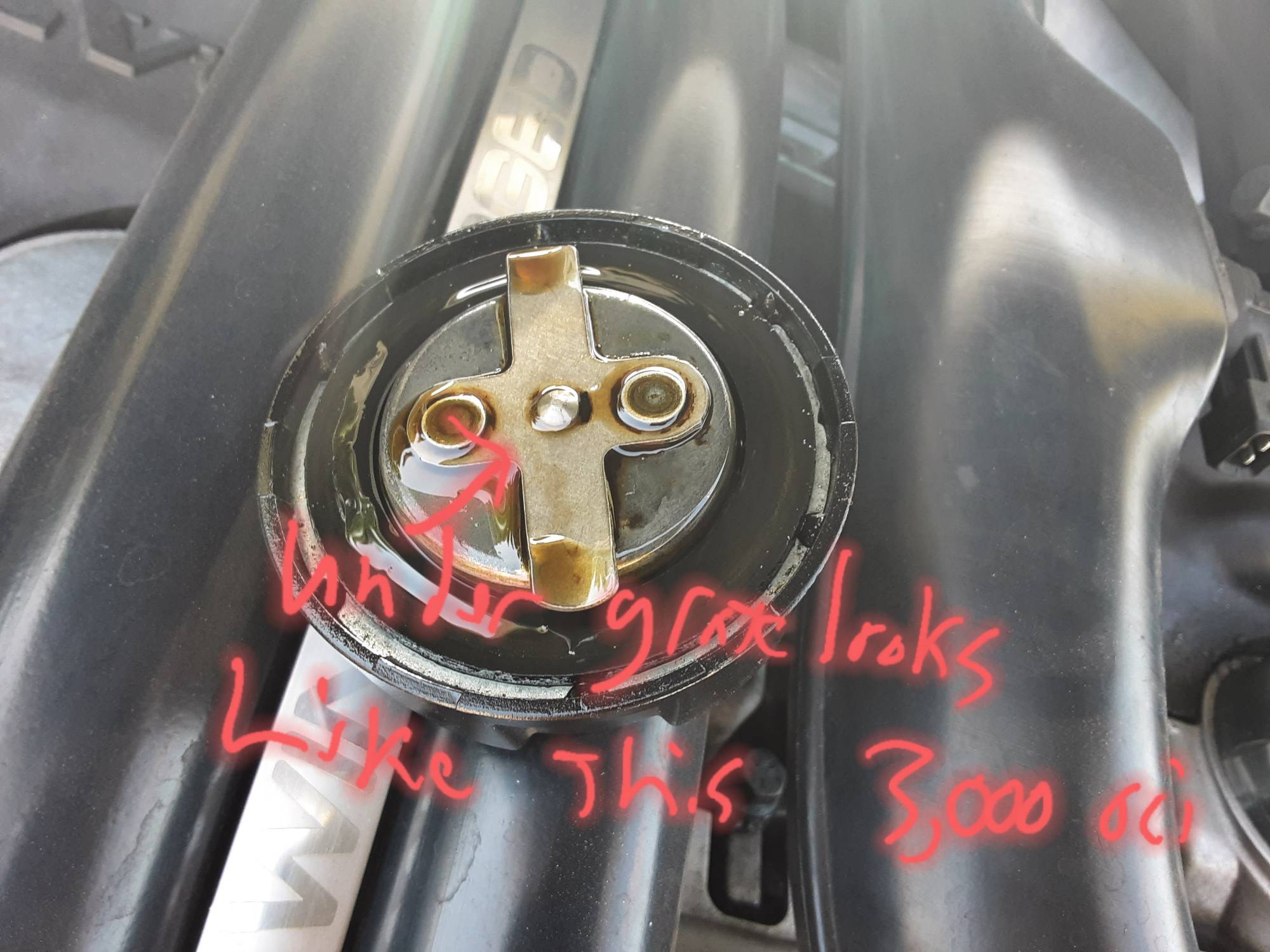

With excellent service history I expect 500K. I believe my White engine in my S80 will hit a million miles without issue. I spare no expense like changing the oil 3very 3months or 3K miles. Using only dealership parts like the water pump during timing belt service. Realize these engines are more likely ruined by jumping timing than anything else. The timing belt runs the water pump. Even the serpentine belt can take out the timing belt in turn seriously damaging the engine. Just be aware the White block engines are not as forgiving as the Red block engines.

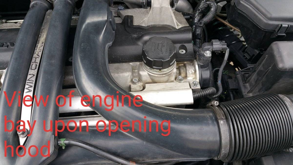

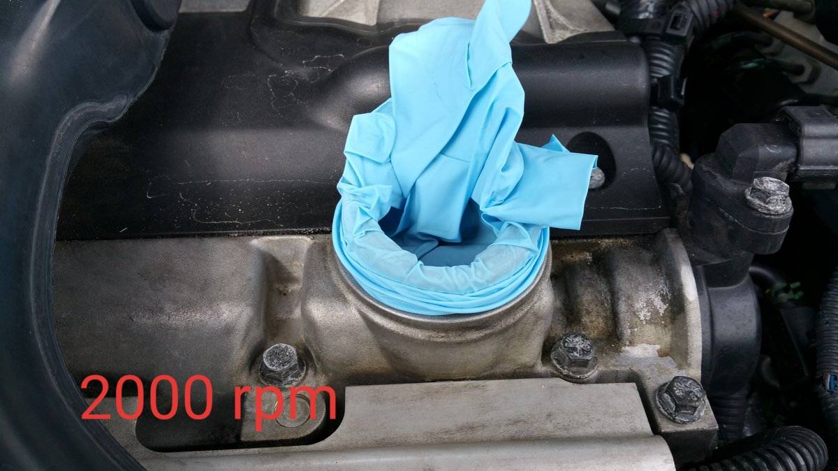

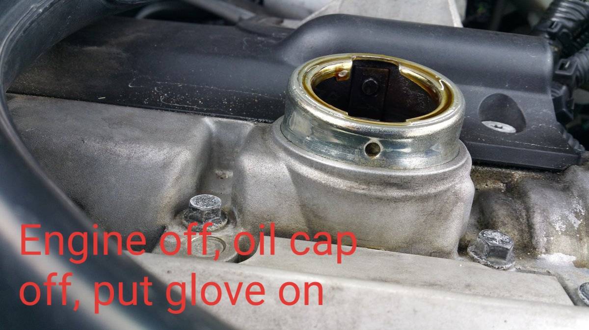

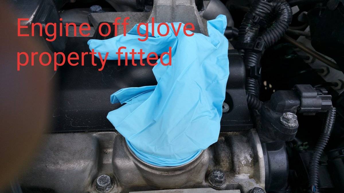

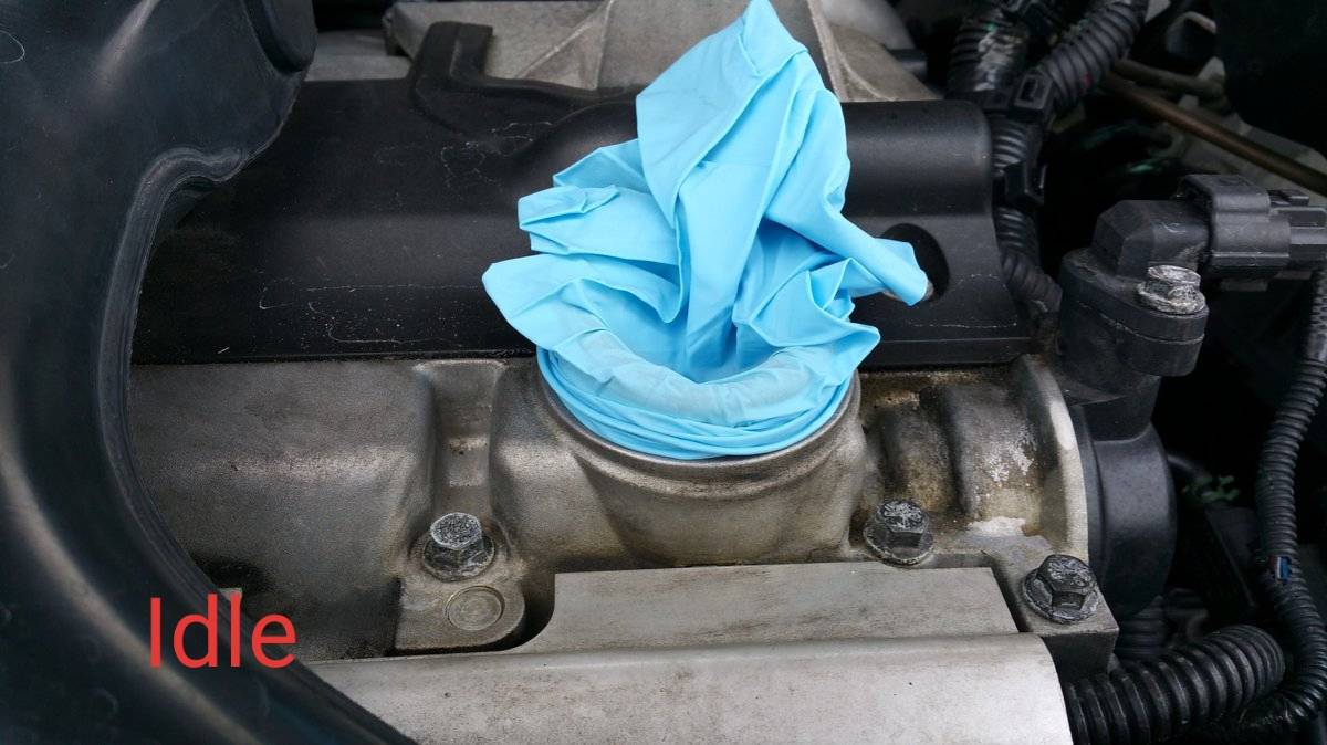

Be sure to thoroughly inspect the engine before you start it. Look under cap for sludge. Theh get the transmission properly warmed up to be certain that it doesn't have shifting issues hot. Obviously do a glove test. On a turbo put it in gear and power brake it at 2000 rpm to be sure glove doesn't inflate. The PCV has two circuits. Reving the engine in park won't activate turbo boost pressure. I added photos of my S80 to show how things should look on a White block. Glove pictured marked 2000 rpm is in drive not park. Glove marked idle, transmission is in park. Also floor the car from stop during test drive completely winding out first gear to second and continue if you can through second if possible. Look for a hop type vibration. If it hops it has worn CV joints Also in high gear at 50ish lightly accelerate looking for vibration. That too indicates bad axles. If axles are bad or replaced recently the car likely needs new mounts as sagging mounts cause axles to prematurely fail. Hope this helps, June

Glove test tells you if the PCV system can pull vacuum like it is supposed to. If fit can't, then either the rings are bad and there is blowby from the cylinders, and/or the PCV is clogged due to neglect. Both are bad signs for long-term engine health.
