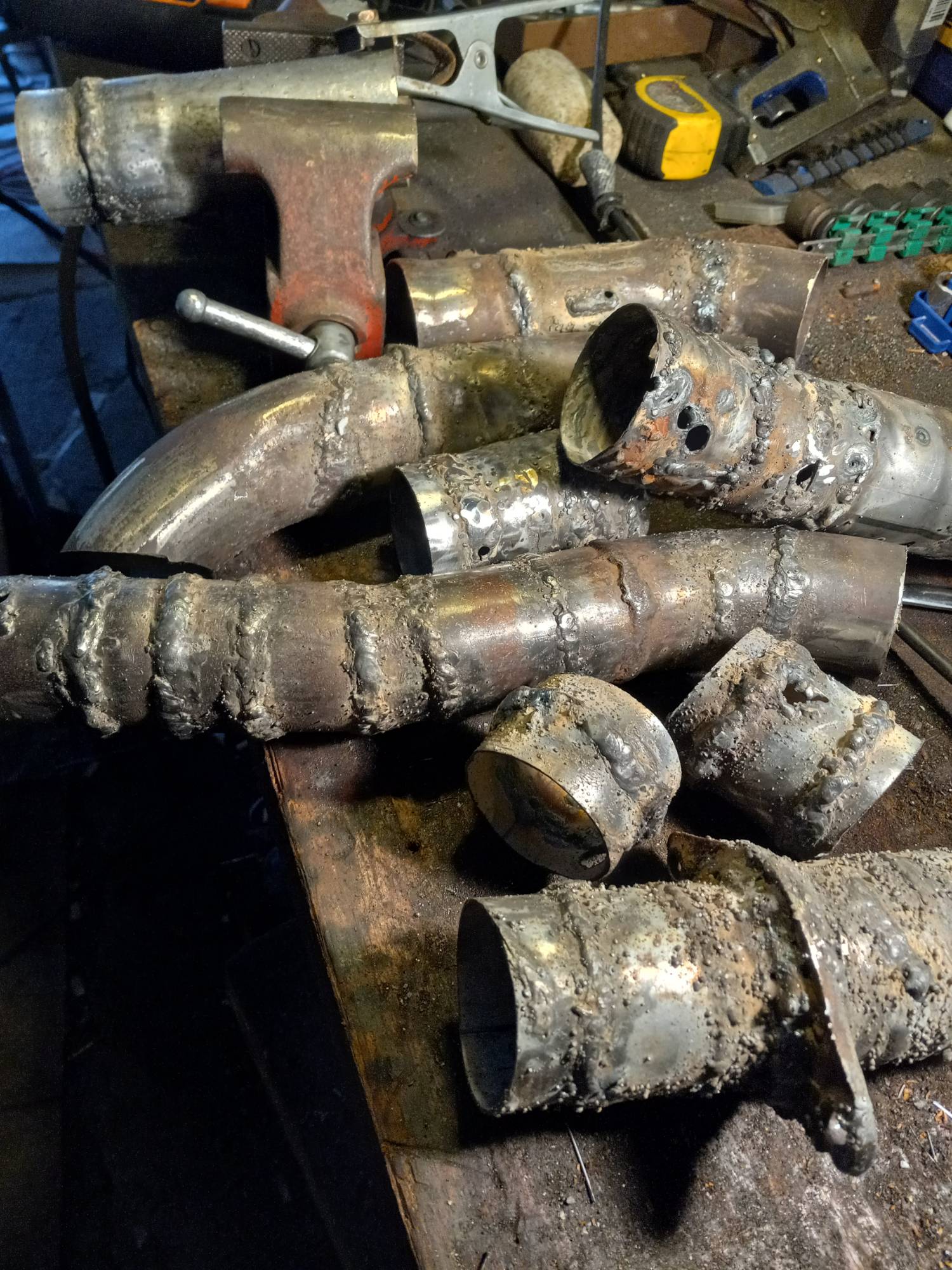

I'm going to weld mine, needs a new flex pipe section.

hence my decision to buy a mig welder and start practicing with scrap pipe from auto shop dumpsters.
I've got the welding down fairly decent now after some help on welddotcom.

I would fabricate a new hanger and bracket, the cat body is quite hefty and not very difficult to weld.
you'd need to make the hanger and install the exh system so its all aligned, then tack weld the bracket, remove and finish the weld, there isn't much room for anything more than a tack whilst in place.
pay the man or pick up a cheap mig welder and start practicing.
