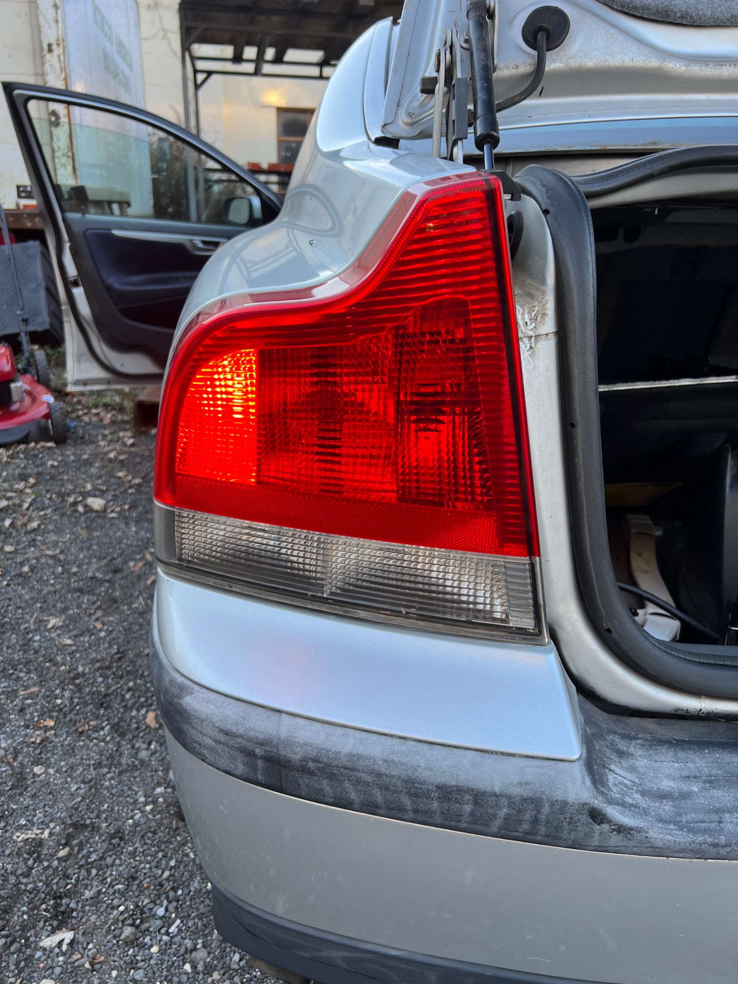

Got the CEM back from xemodex. Popped it in. All good.
BUT, Noticed the rear lights won’t shut off. What do I check?
2004 s60 R lights won’t shut off.

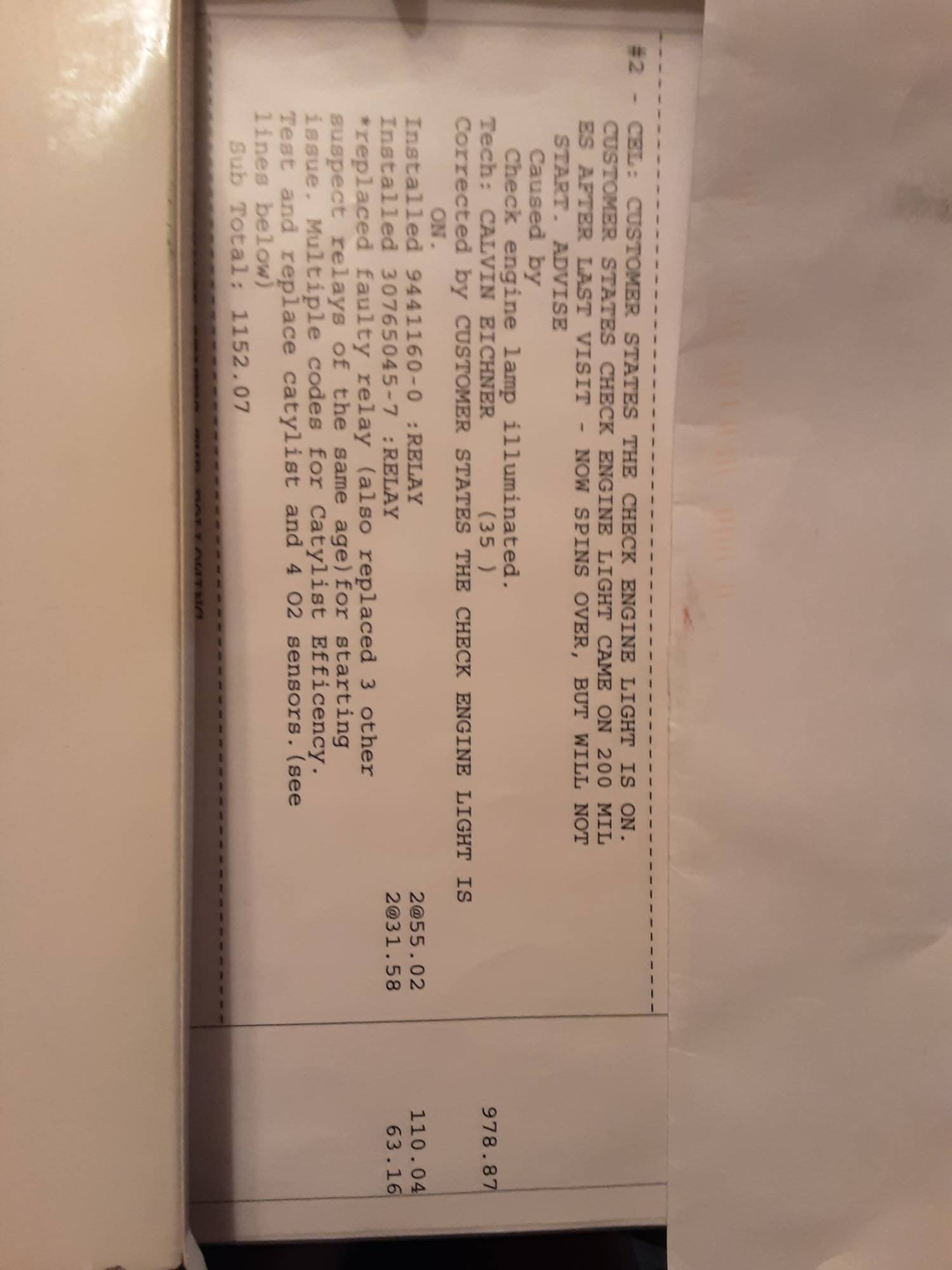

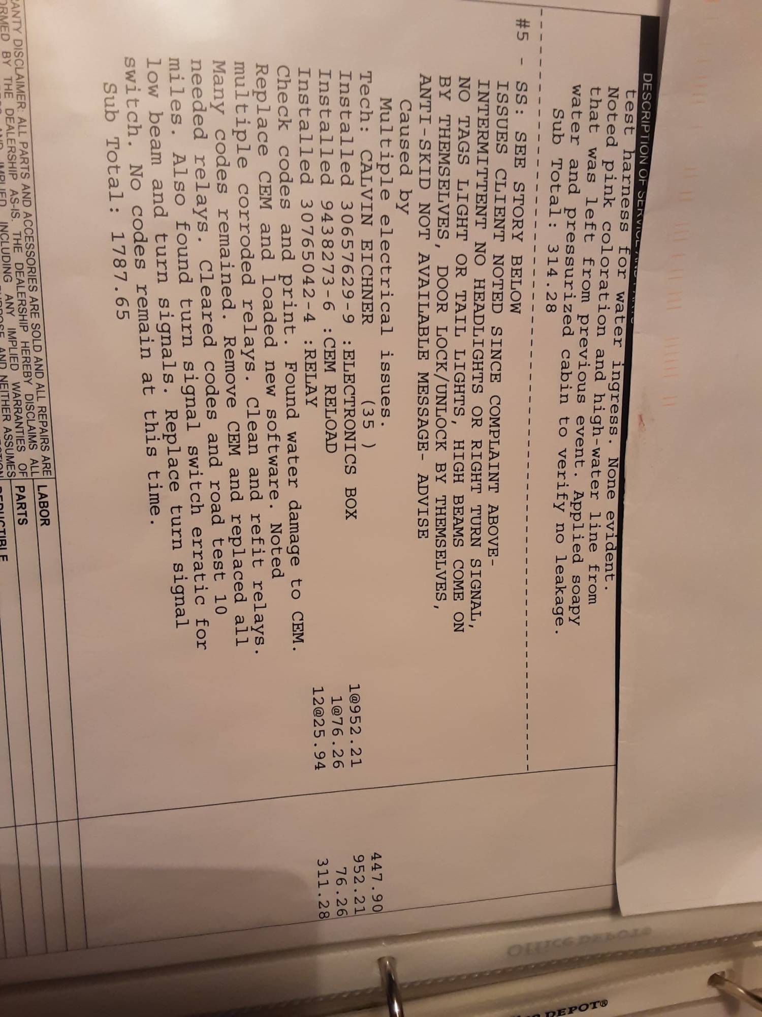

Here are the two portions of two bills with relays being replaced. Those last four relays cost me big bucks in repairs over the year period between the CEM with 12 relays ticket 12/2020 the portion with four relays 6/2022. I had five tickets in between those two dates replacing light bulbs, light sockets, turn signal switch, catalytic converter assembly, mass airflow sensor, all of the O2 sensors. All came down to four final relays not replaced. June

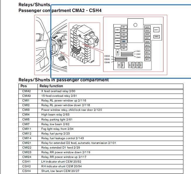

If your car matches the wiring diagram I have (2002 Volvo V70) these lights are controlled by the CEM, relay CMI5. You could swap this relay with an equivalent one on the CEM and see if it might be a bad relay. What about the front parking lights? It looks like this relay also supplies power to the front parking lights if you don't have Bi-X headlamps. What's the knob position of the light switch module, does it make any difference moving the LSM to different positions?
