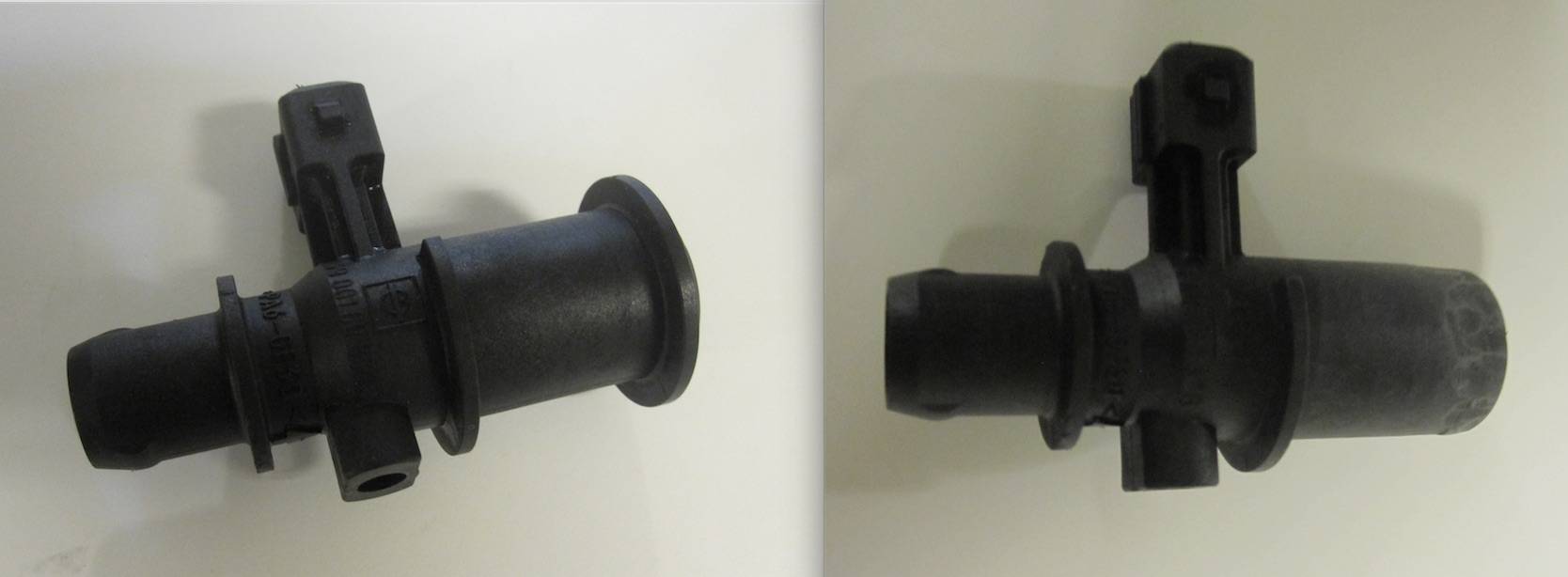

You'll need to cut off the rubber grommet, but I believe you also have to file or dremel off the plastic lip of the PTC. Here's a before and after of mine.
Just a thought, if during installation there's more dialogue on this, maybe a new thread for installing the turbo inlet hose would be in order, just to help future readers. I have lots of other pics of the install, if you need anything.

Post by rick4484 »
99TurbBrick, thanks for submitting the photos. I'm still waiting for the shipment from IPD but, in the mean time, I found a IPD Youtube video showing the modification of the PTC using a grinding stone wheel. The Youtube video is for a different model than mine but the procedure is probably the same. I have a fixed grinder like the one shown in the video, so I'll try that, and may use a Dremel tool to make refinements.
Looking through the comments of this Youtube video, I noticed a person describing how things don't line up that well, that he had to make additional modifications such as lengthening the electrical connection for the PTC plug/socket, as well as a few other things. Just wondering if you found similar obstacles requiring the need to do extra things beyond modifying the PTC.

If you don’t orient the PTC orfice correctly On the snorkel the plug won’t reach. It faces forward when correct.

Is there a special way to separate the PTC from the air inlet tube, other than brute force? Do I need to cut the rubber grommet first? I've tried spinning the PTC in various ways to see if there is a release area. I've spun the grommet too, but still it's not budging and I don't want to break it. I searched Google and on this forum for a way to separate the PTC from it's position in the tube, but found nothing.
UPDATE:
GOT IT OUT OF THE TUBE. I cut the rubber grommet on both sides and used a pair of channel lock to work it out of the tube.
